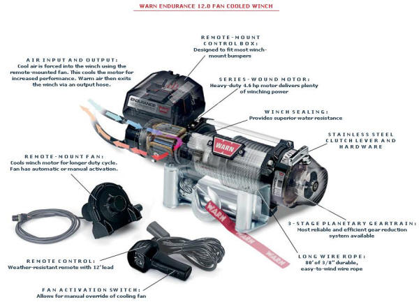

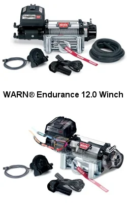

Finally there is the Endurance 12.0. This winch was in a way Warn throwing the kitchen sink at the mid frame platform. The Endurance used the high speed layout like the 9.5ti with lower gears and added fan forced cooling to the mix. Cooling was provided by a remote mounted blower with hoses that attached to the brush cap on the motor. I was lucky enough Warn sent me one to test (most likely to get my modded 8274 off the TJ) and while it was no 8274 it was an excellent winch with decent speed and very good amp draw at lower loads.

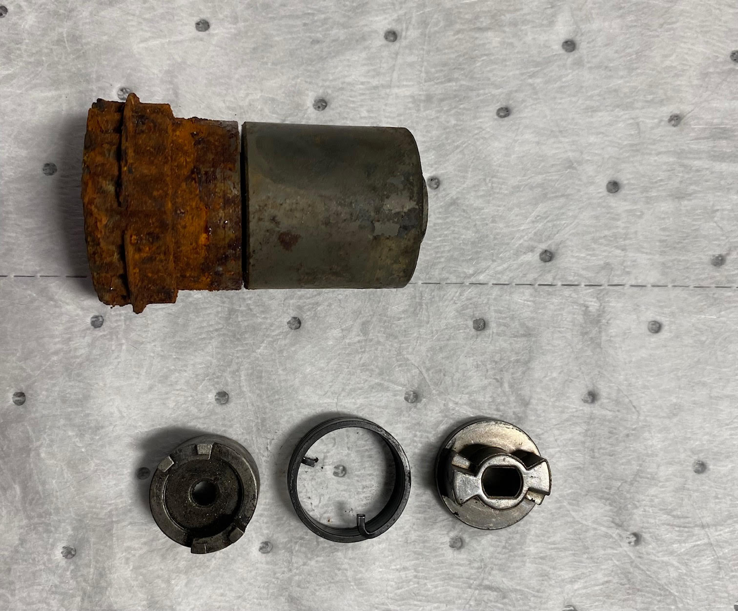

First up is the spring brake. Unfortunately this one is frozen up so I cannot get it apart to show all its parts. This brake was interesting in that it uses a sprag (one way roller bearing) which ensures no frictional loss of the motor while powering in. This gave maximum pulling power and no load line speed from the lower HP motors of the day. The disadvantage was long term durability. The three pieces I placed next to the main assembly is the spring brake from a current ATV winch just to show what is inside doing the load holding and as you can see those parts are pretty small.

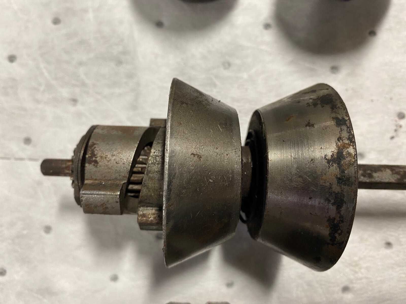

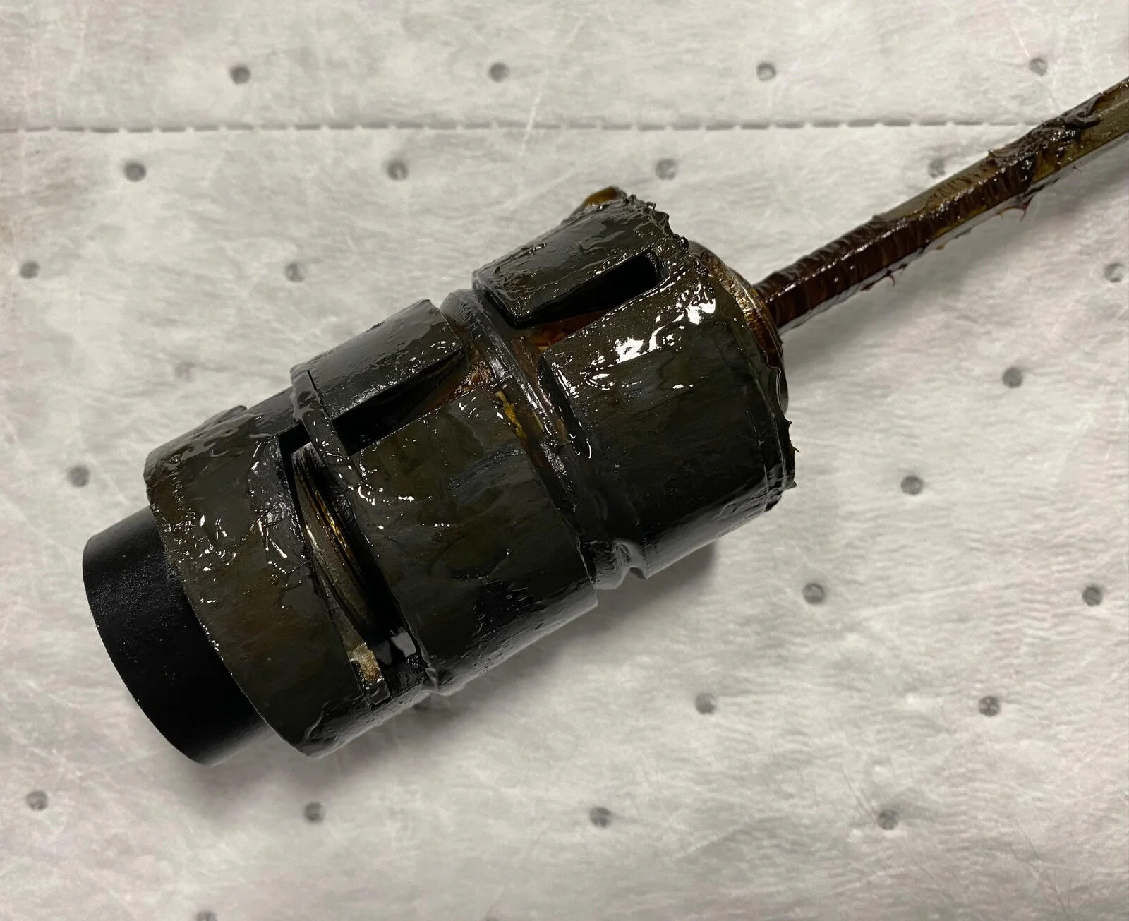

Next is the first gen cone brake. These were are huge step up in load holding and durability. The tradeoff was a small loss in efficiency, are much more complicated in design as well as requiring being greased making them more expensive to produce. Versions of these continued to be used in Warns industrial winches and hoists because of how effective they are.

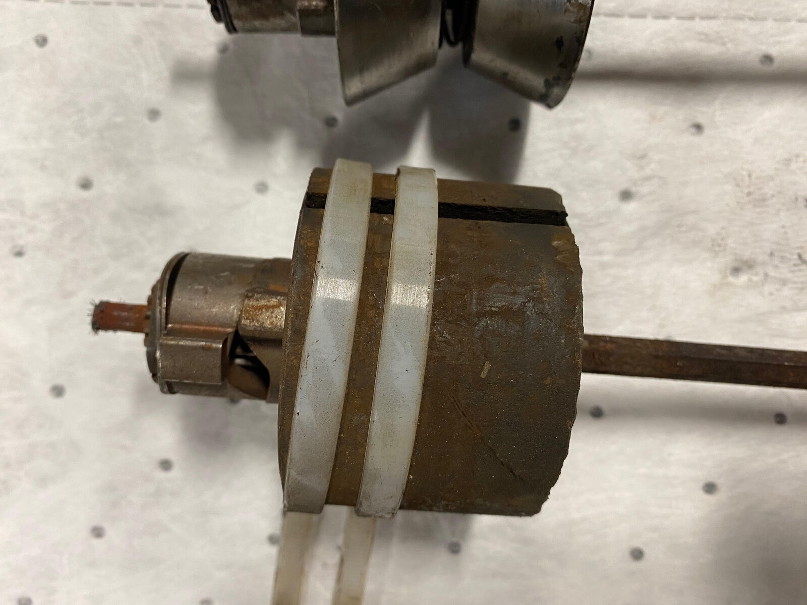

Finally there is the current cone brake. The one I am showing here is from a Large Frame winch but they are identical other than scale. This version of the cone brake uses loose brake frictions that are made up of material similar to that used on disc brake pads requiring no lubrication. Even the cam only requires the smallest amount of lubrication when being assembled. You will also notice that I have the one brake and frictions zip tied together. Here is my first bit of tech: Unless you are replacing the brake I do not recommend removing it from the drum. If you need to remove it you do not want to let the cam unwind which means not letting the frictions loose from the brake hence the zip ties or some other means of keeping the brake together. That also means you do not want to remove the snap ring from the brake either. Anything that allows the brake cam to unwind risks the chance of damage to the clock spring leading to brake failure while in operation.
The brake:

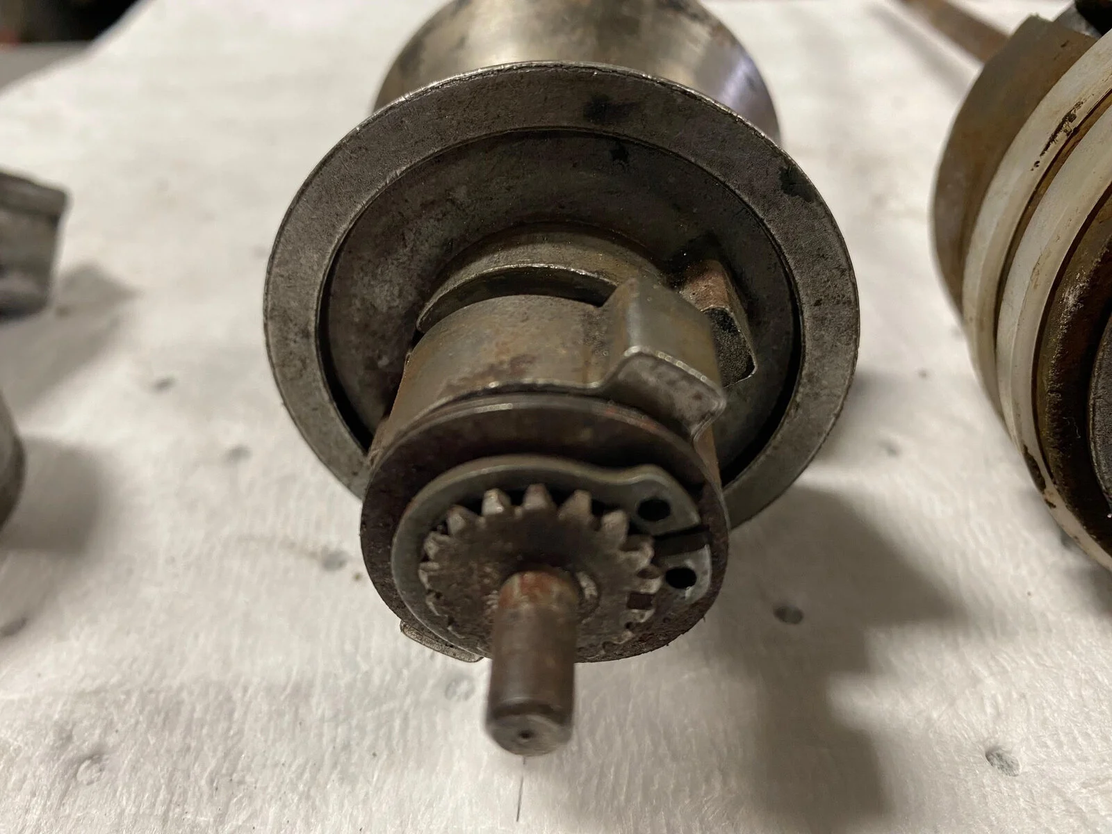

The cam and cones. You can also see the clock spring between the cones:

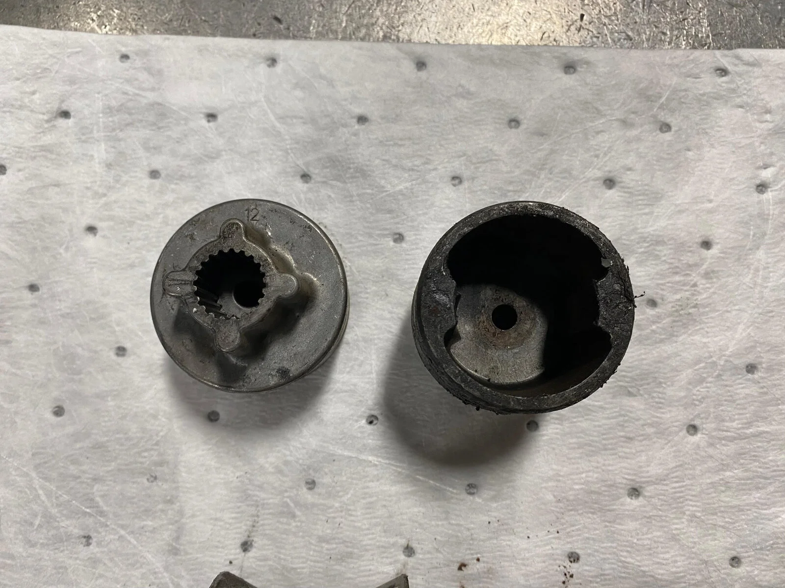

The motor coupler. This combined with the dry frictions give this brake its distinctive bolt in the blender sound (more prevalent on the M8000 and other winches using the lower gear ratios) especially under low load conditions.

This brake for the most part is relatively simple, reliable in most all conditions other than if not being serviced after deep water excusrions on the older non sealed winches. The one big thing to note is the use of this brake with synthetic winch line and why it took Warn so long to adopt any kind of synthetic line at all. Like the brakes on your Jeep the cone brake works by converting rotational energy to heat and that heat is absorbed into the drum pin and thus into your winch line potentially causing the line to degrade and fail. This is why there are many Warnings in the Warn winch manuals about not powering out the winch for extended periods of time and why Warn over the years came up with different synthetic lines to combat the brake heat problem. The truth is that it is actually pretty rare that you would need to do so anyway thus being cognizant of what can happen and adjusting your winching stategy will prevent excessive brake heat in the first place.
