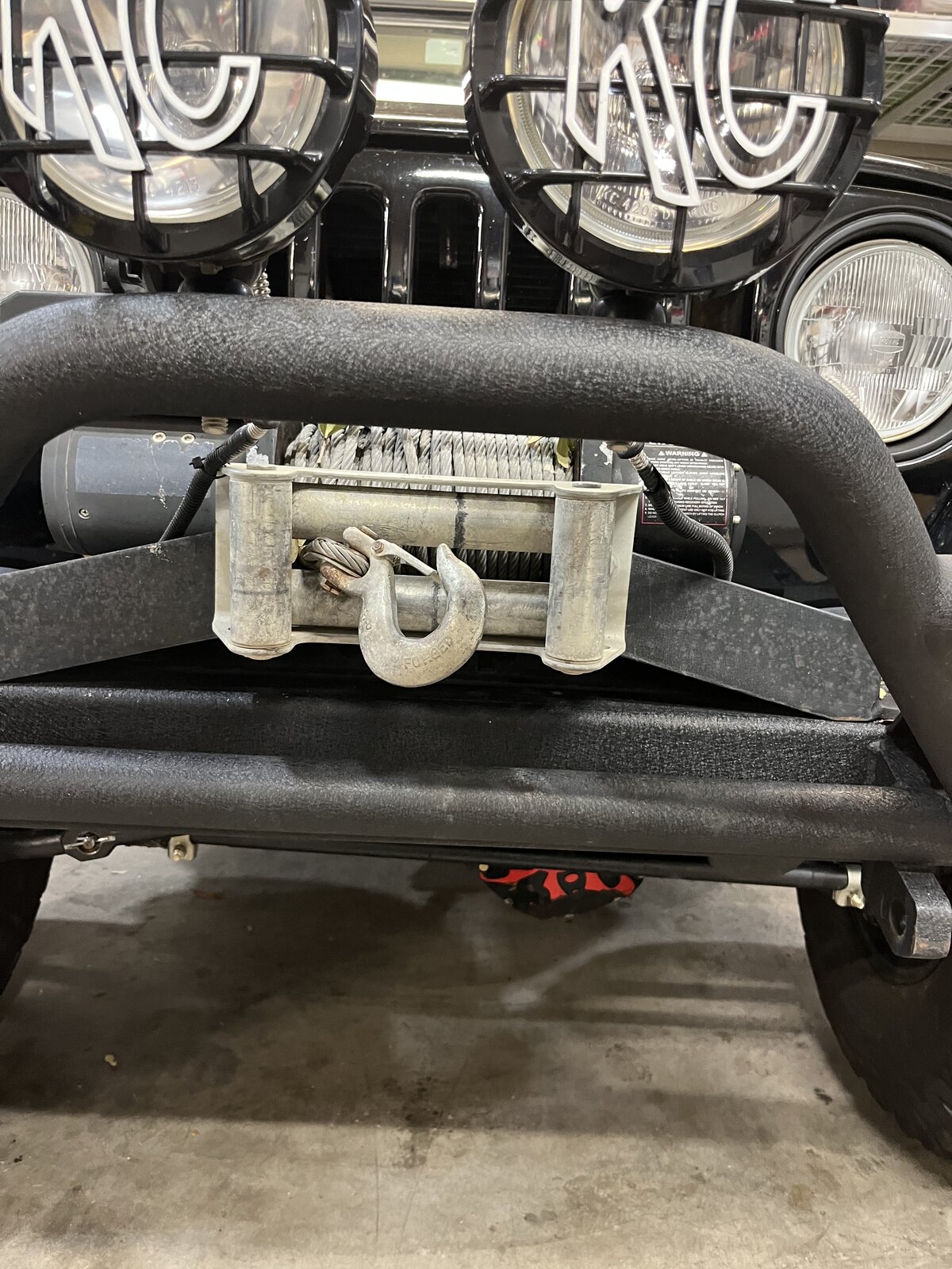

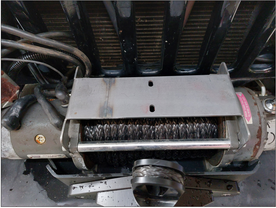

@Mike Z do you not have a sway bar?
I want to get a different winch plate, yours looks flat, and no sway bar there?
I also like with a flat one I could put the recover hooks there as well, there’s not enough room next to mine for the bolt next to hook ones I have.
Although I have locations on bumper, still want this hooks.

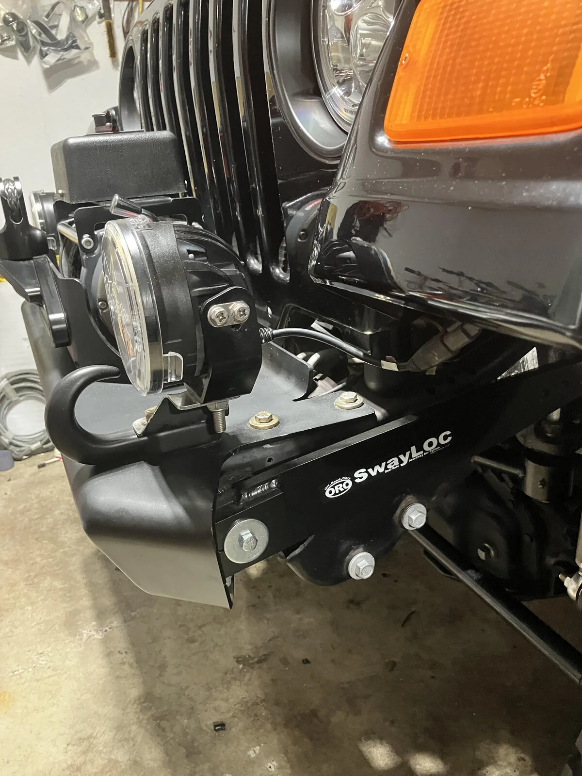

Here are side and front pics of mine. The stock sway bar is gone. In its place is the SwayLOC.

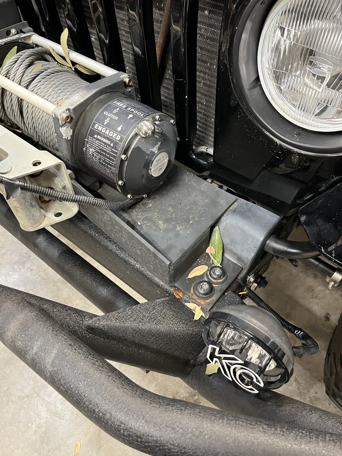

Looks like its missing the solenoid mount. I found this one:
[URL]https://searchers.mybigcommerce.com/searchers-pro-winch-solenoid-mount/[/URL]
Thanx to the forum here. A much nicer way to mount them than stock WARN, IMHO.
A word of caution if you are going with this solenoid mount.
I am utilizing this bracket and I am quite happy with it, but only after a fair amount of effort in making it fit correctly.
My Jeep was with @mrblaine as he was solving multiple issues with its drivability. I ordered the solenoid bracket from Searchers...the aluminum one.
It took three weeks for the bracket to show up to Blaine. What was delivered was the metal one. Additionally, it was too long and did not mount properly on my winch. Blaine had to cut the center of the bracket and remove some material and then weld it back together and prime and paint it. It is possible that I could be leaving out additional work he did to correct the size.

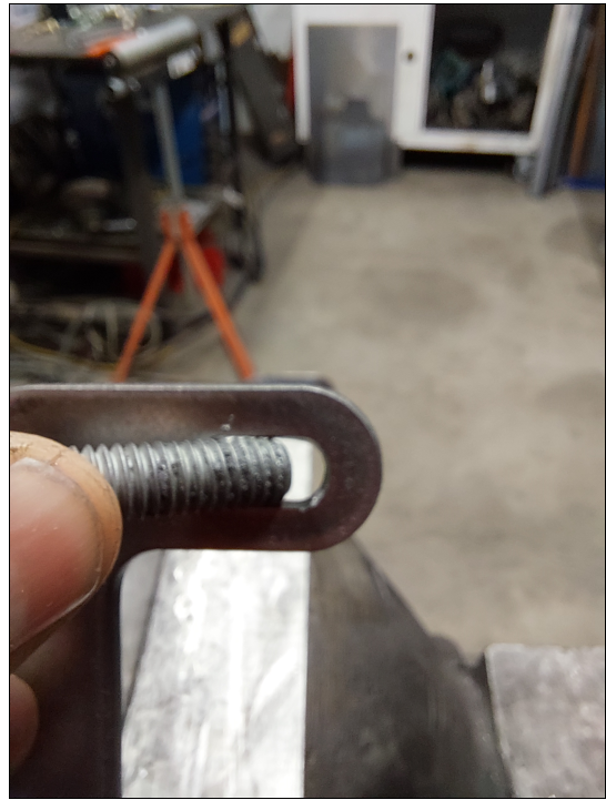

We took a bit out of one side to better center the holes for the solenoid pack.
With one end touching-
The other end barely touches
the screw head.
And, to add insult to injury, they ran the plasma cutter too fast which puts a lot of draft on the sides of the slots.
To do this correctly, they should eliminate the slot since the end caps have recessed areas and the slot is useless. They should slightly oversize the hole, supply AN washers for the heads of the cap screws and 1/4" longer cap screws with a 5/16-18 tap. The tie bars need to be threaded with a tap instead of a self tapping screw like Warn used. The Warn fasteners are barely long enough to hold so longer ones with a good tap are never a bad idea.

All of these searchers brackets come this way, or was this a 1 off they’ve corrected? Seems immensely annoying they’d make a bracket specially for this, but it not fit, although that’s a too common occurrence.
You do understand that I have no way to know that answer. I didn't buy the mount. Someone else bought it, put up with their terrible shipping lead time and then I got to deal with the wrong product that was not what was ordered. I fixed it in the interest of time and getting done. Normally I would have sent it back, thrown it away, or put it on the shelf of shame next to the other screwed up examples of stuff that really shouldn't be this hard to make.
Mike did his part, I did mine, the only folks who didn't are the folks that made the mount. They did send out the correct part in aluminum. It was offered to me, I wanted nothing to do with it.
edit- I also fixed it because I suggested it. I had no experience with them, but I didn't want to make one from scratch out of steel. I was highly mistaken and did my best to fix my mistake.
As Blaine said, he corrected multiple issues with the bracket, which I was grateful for since this was one of the last items he was addressing on my Jeep prior to it shipping back home to me.
My guess is that this was not a one off. The aluminum bracket was eventually shipped to me at no cost, but when it arrived, I measured it and it was also too long. I offered it to Blaine for free, but he had had enough of Searcher's brackets :)
