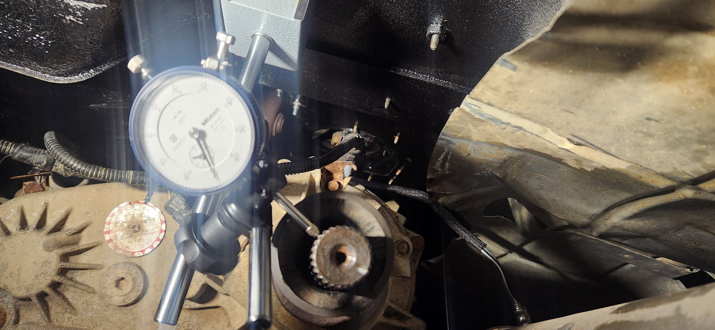

Check your t-case output shaft. It was the culprit in my vibration scenario, though probably caused when the PO broke the engine. In this pic, the silver has at 4-o'clock is at 0" and ~180* it's at .7". It moved like an ellipse more so than a circle.
