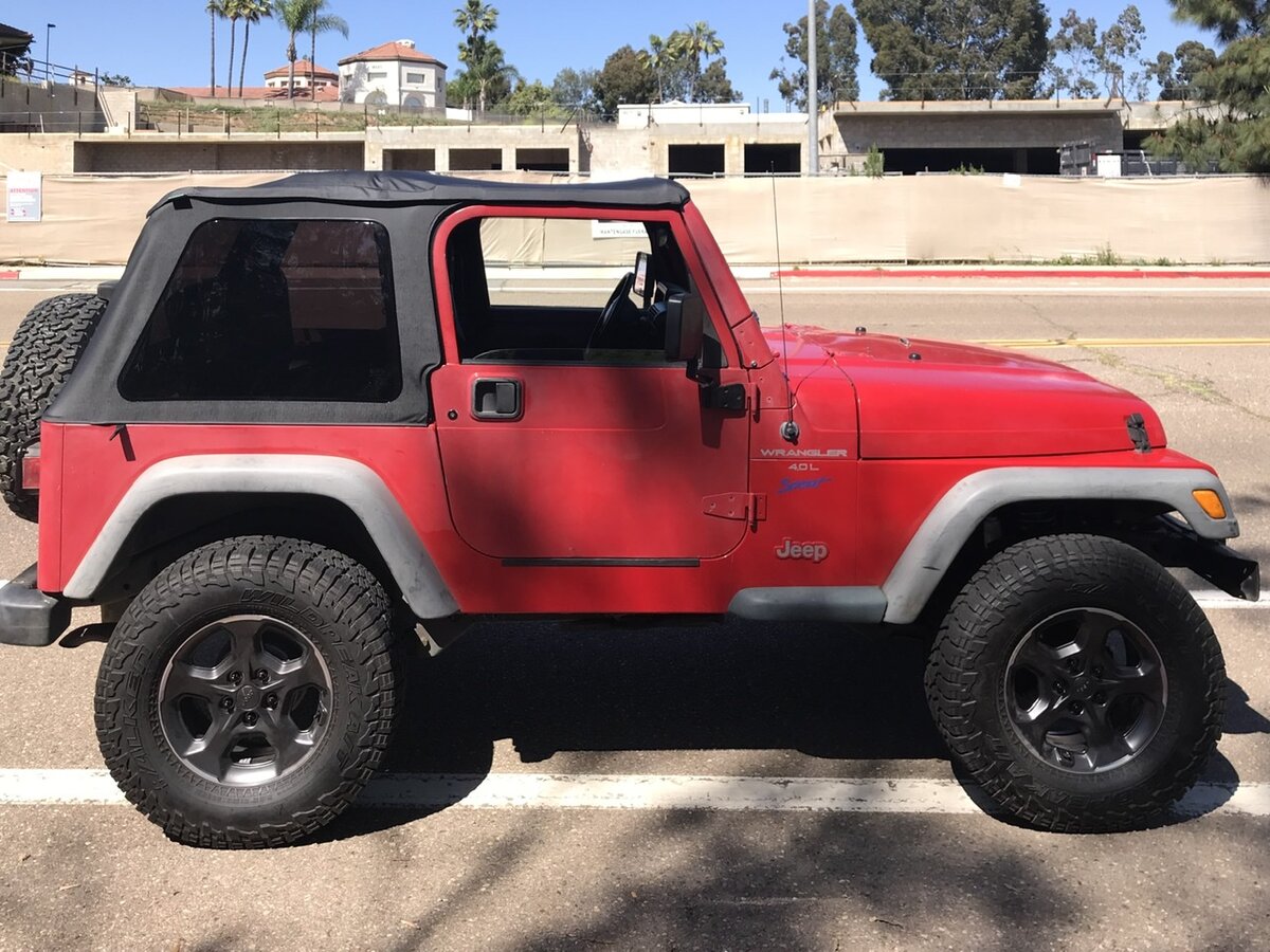

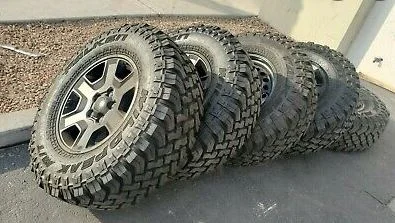

I went Tim D's route and ordered my custom wheel adapters from Tire Shop Supplies in San Bernardino CA and they made them with 1/2 x 20 lugs mounting to the TJ and M14 x 1.5 studs to the new Gladiator Mojave wheels I bought . I felt that the stud size was just too big to ignore. $345 with military discount which didn't seem to bad compared to lets say Bora wheel adapters which are like $600. I am going to wheel my TJ semi hard so it seems like money well spent. These are the wheels and tires I bought. I'll post pics on the jeep when I get them installed.

I guess I never posted my JL wheels results on this thread. Lug Nut Guys 1.25” thick adapters and they now have 7/8” M14x1.5 black lug nuts on there. 2.5” suspension lift (Some rough country, some Rancho parts), had to add a couple of washers to each steering stop so they wouldn’t buzz the front lower control arms at full lock. 285/70r17 Falken Wild Peak on what I think are stock JL Rubicon wheels.

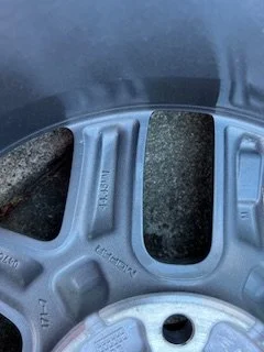

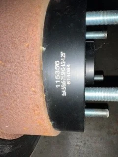

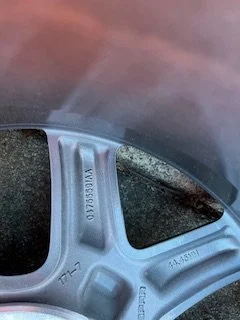

Reviving a thread. My new to me 2005 TJ has what I think are JL wheels. I think. Part number is 04755591AA and they say MOPAR on them. Can anyone confirm they are JL wheels? Also attached is what is on the wheel adapters which are 1 1/4 inch thick. Can someone decipher what the measurements/codes are on the adaptor? The nut holding on the adaptors is a 3/4 inch nut. Reading this thread I think these adapters are for the TJ and JK size studs of 1/2-20, not the stud size of the JL wheels of M14-1.5. I also think the lug contact area is a bit sketchy on the wheels, as in to much bite up the conical area, another reason I think the adaptors might be for TJ/JL size studs. Tires are brand new (previous owner) at 245/75R17. Offset looks good and they look good to me overall and the jeep rides great and is a good height for me to get in and out so I am keeping the wheels/tires. I just want it to be correct and safe. I would not be adverse to getting new adaptors, but as a minimum I need to track down better lug nuts. All this is new to me, but this is why I got an old Wrangler, lot of things to mess with!

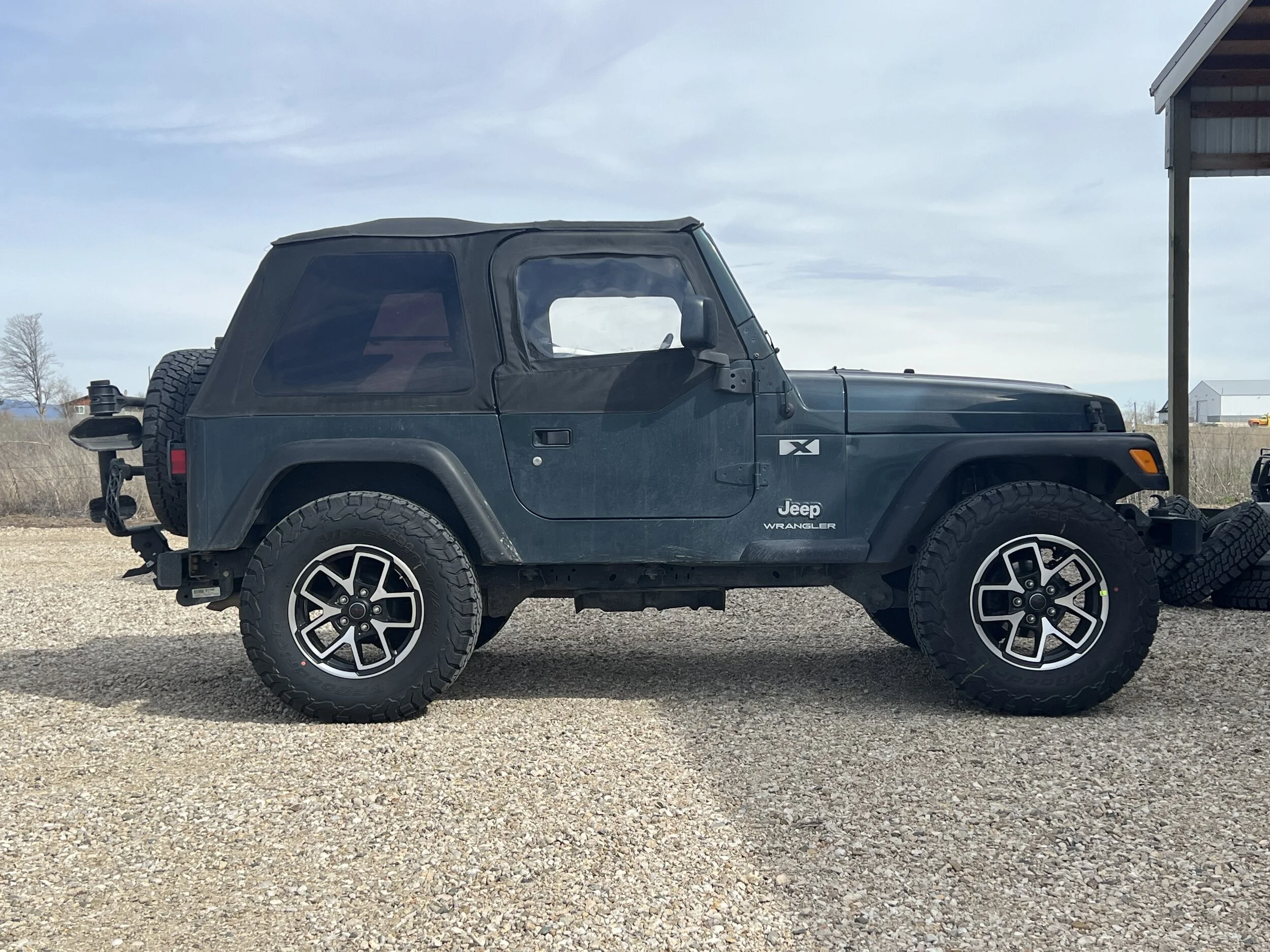

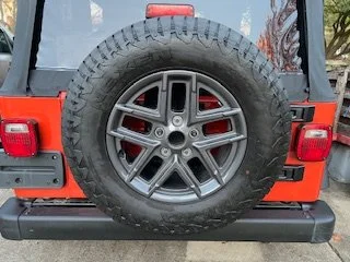

I found the lug nuts that are wider and seat across the entire conical surface of the JL wheel that previous posters mentioned. They are from the "lugnutguys.com". As previous posters pointed out the JK lug nuts only seat on the edge of the stud opening in the wheel. Every once in a while I would find one loose. These lug nuts have the 1/2-20 thread pattern of the TJ and JK prevalent on most wheel adapters, especially those on Amazon, but fit the JL wheel design. These wider lug nuts torque down nicely. Side note, I have 245/75R17 tires on 17" x 7.5" JL wheels. 1.25" wheel adapters. No lift. Tires measure 31.5" x 9.6". With 3.73 gears it moves along nicely and it rides great! There is no rubbing by the tires on the body or suspension. I did have to lift up the spare tire carrier 1" for the spare tire JL wheel to fit over the bumper. I used metal conduit cut to 1" length as spacers. The bolts used by Jeep on the spare tire carrier are still long enough to re-use with the 1" spacers.
