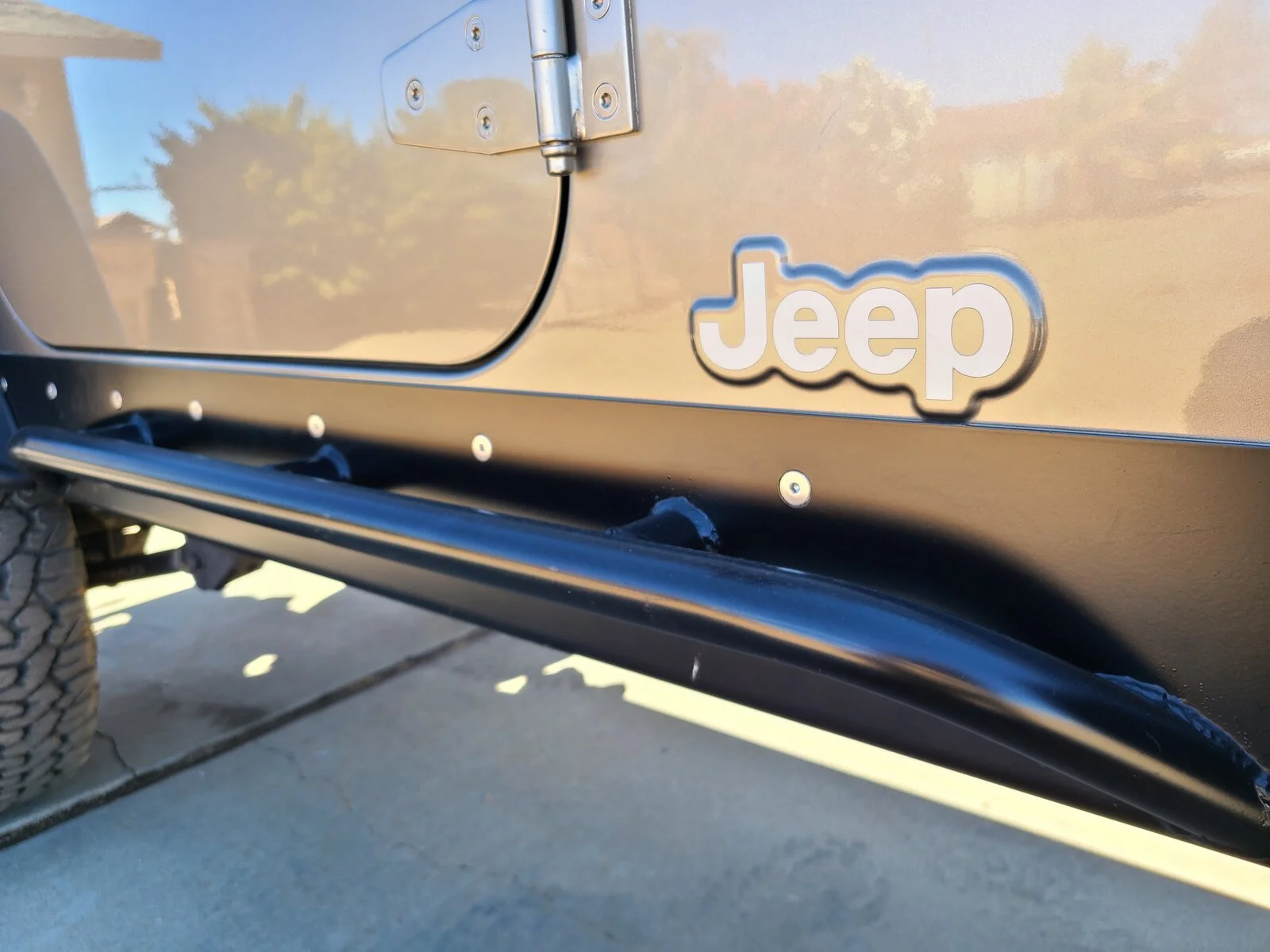

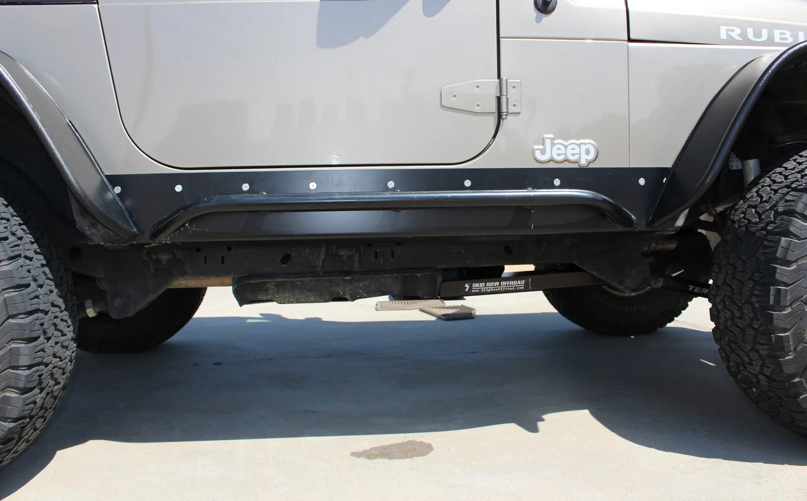

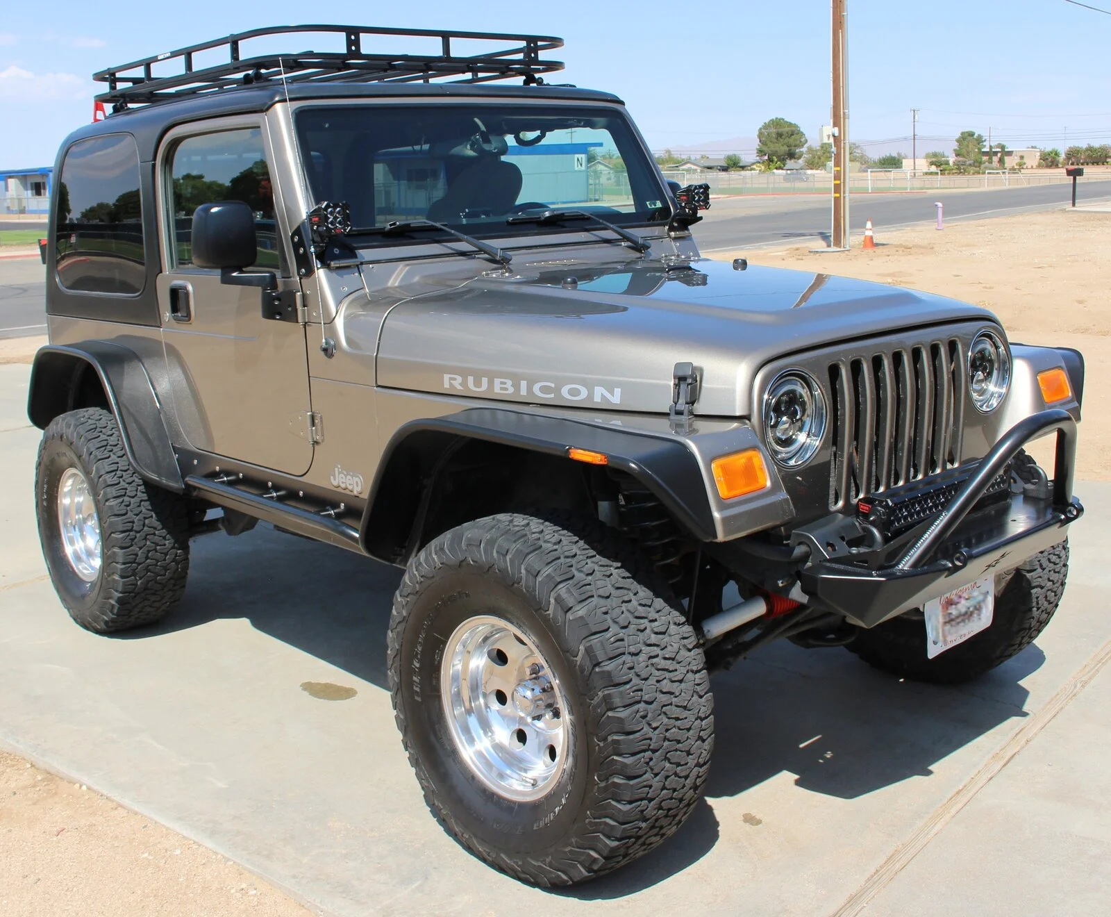

Hey All,
I am looking to replace my bushwacker flat fenders. Are these a similar material? My rocksliders run fender to fender. Are these pretty flexible? Also, will the upkeep be easier than the bushwackers? As far as the faded look?

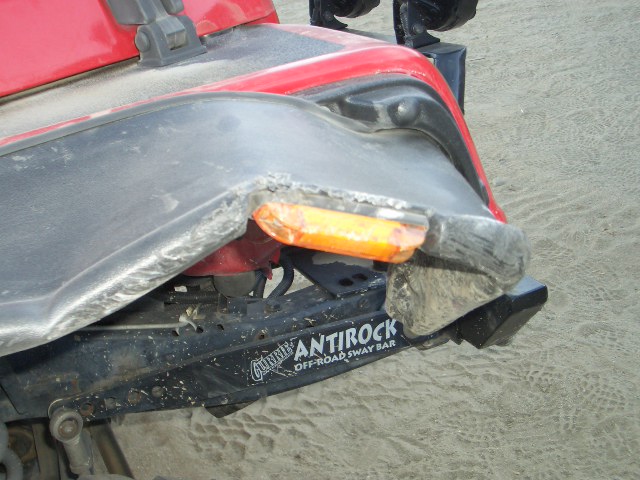

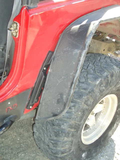

I installed the same vinyl fenders from Bushwhacker and they lasted just one day on the trail. If you expect to get into trails where you might have to squeeze by an obstacle I'd consider something else.
I wanted to go with genright. But then i saw the picture if your fenders (Jerry) and I think I would cry if I did that to some Genright aluminum fenders. How do they hold up in similar situations? My wife would punch me in my throat for destroying some 2000 dollar fenders.

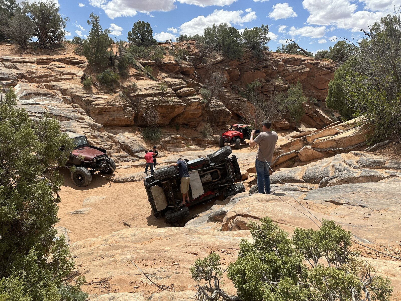

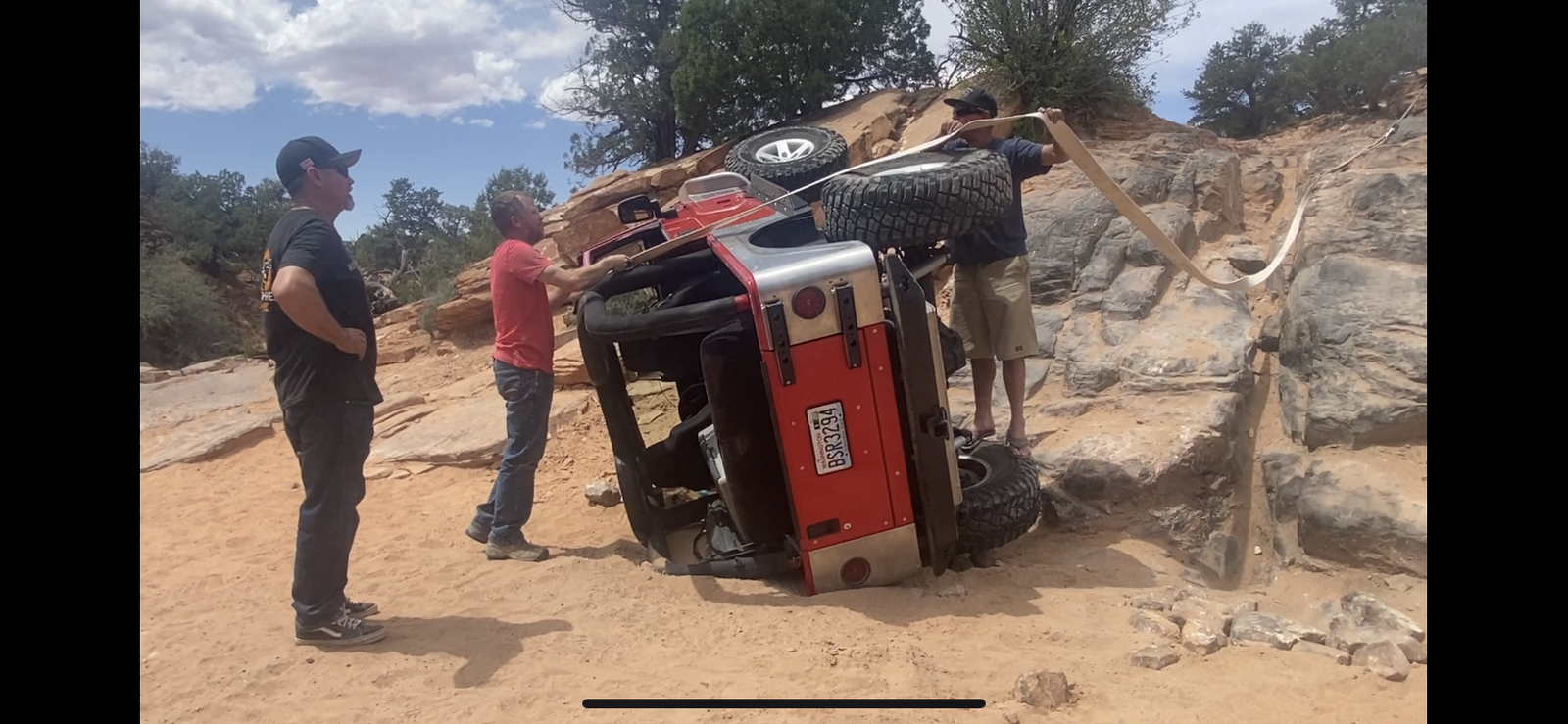

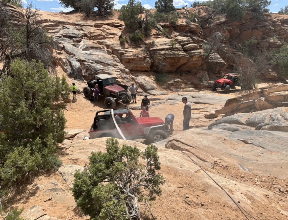

Aluminum and steel will function about the same. In normal slow speed scraping a tree or rock they will hold up fine. In a slow speed flop they will protect the rig. In a more violent flop or roll they will press in on the grill or tub and bend those parts. They saved my rig in this slow flop. These are aluminum 4” GR up front. I’m very glad I had them rather than my previous MCE’s. I would have destroyed my hood and door without them
Thanks for that reply. How much damage did you have from this? Flip it over and good to go?

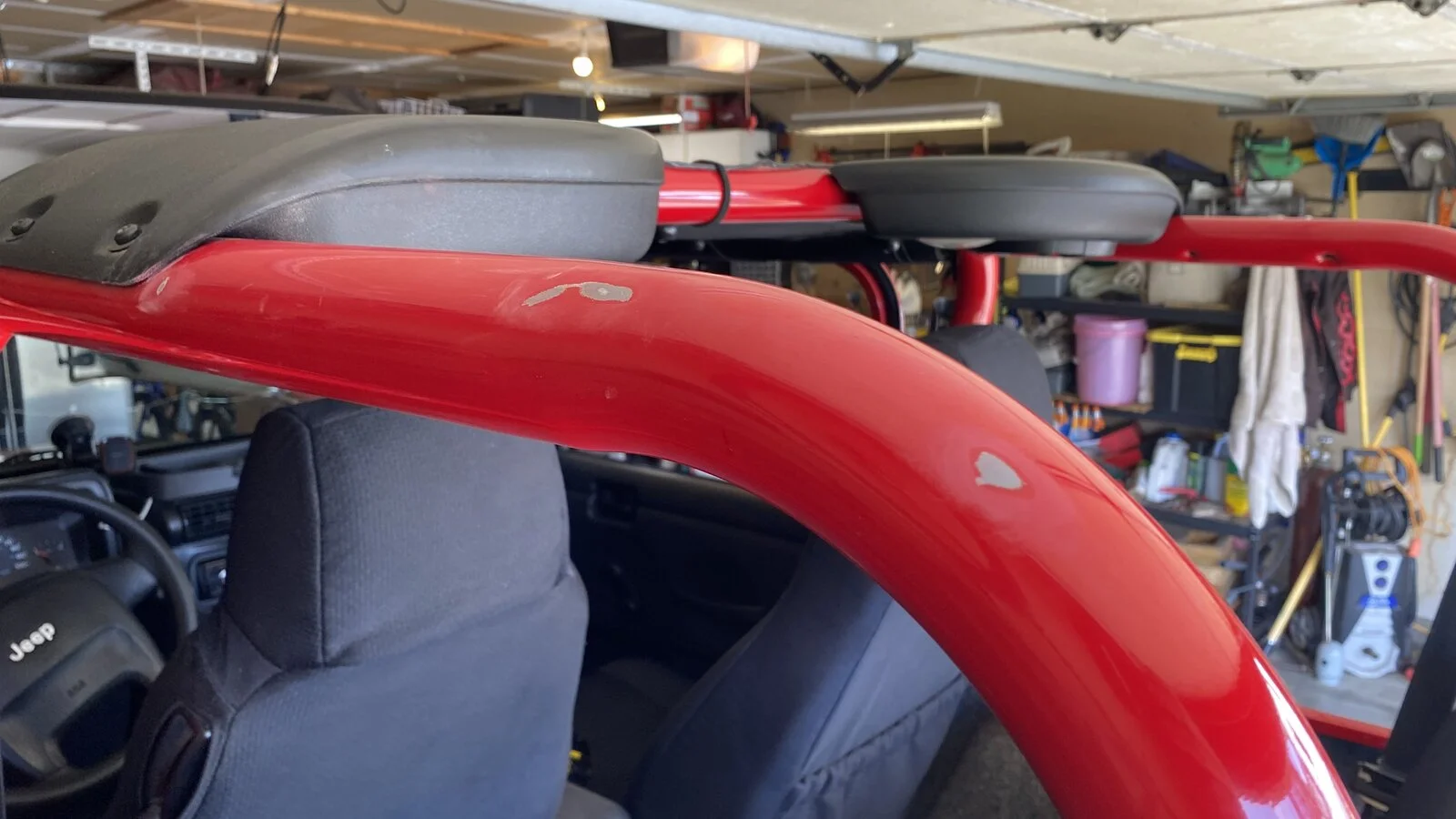

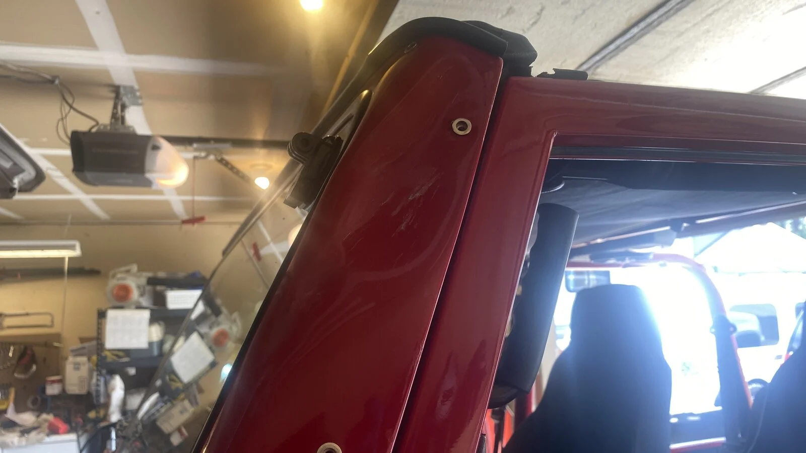

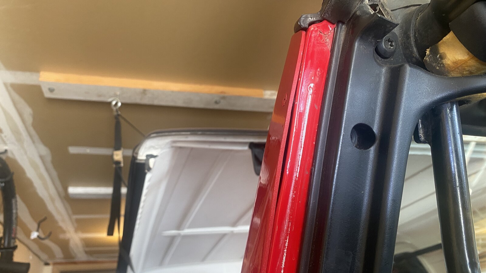

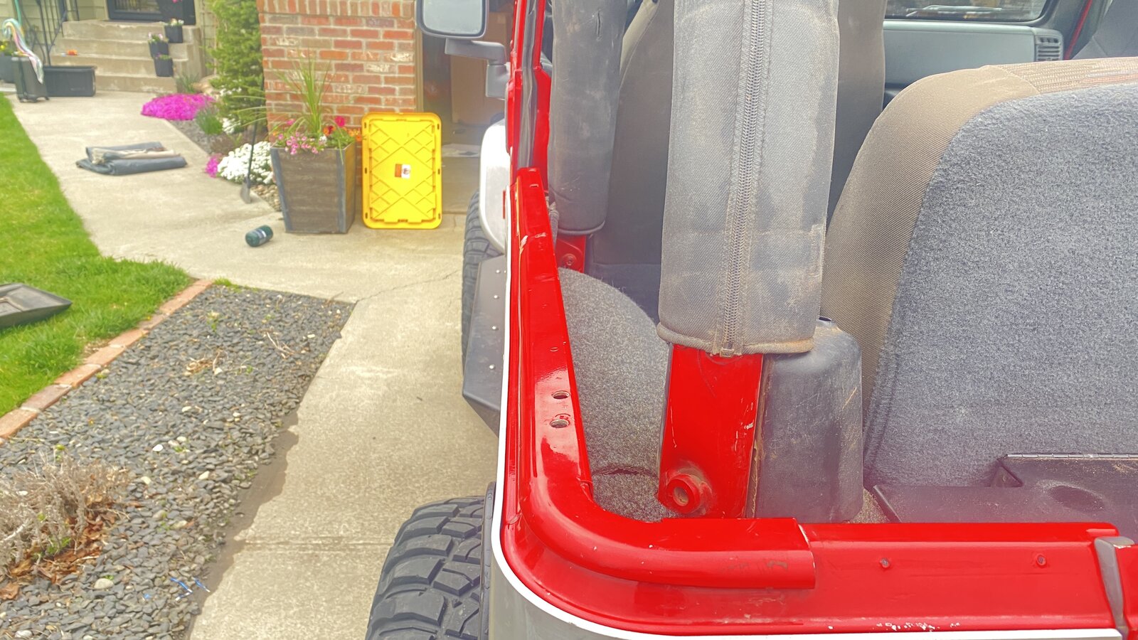

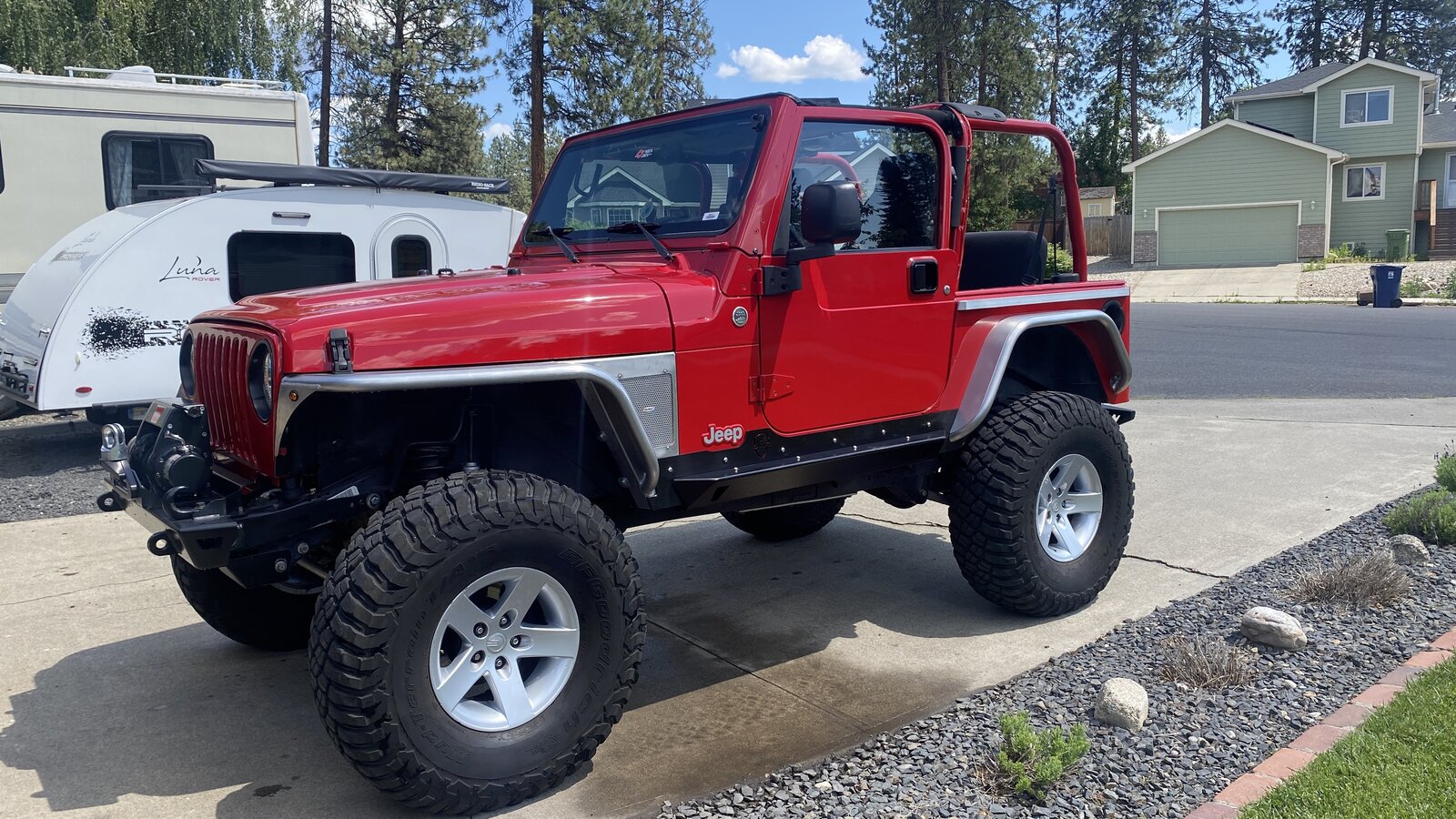

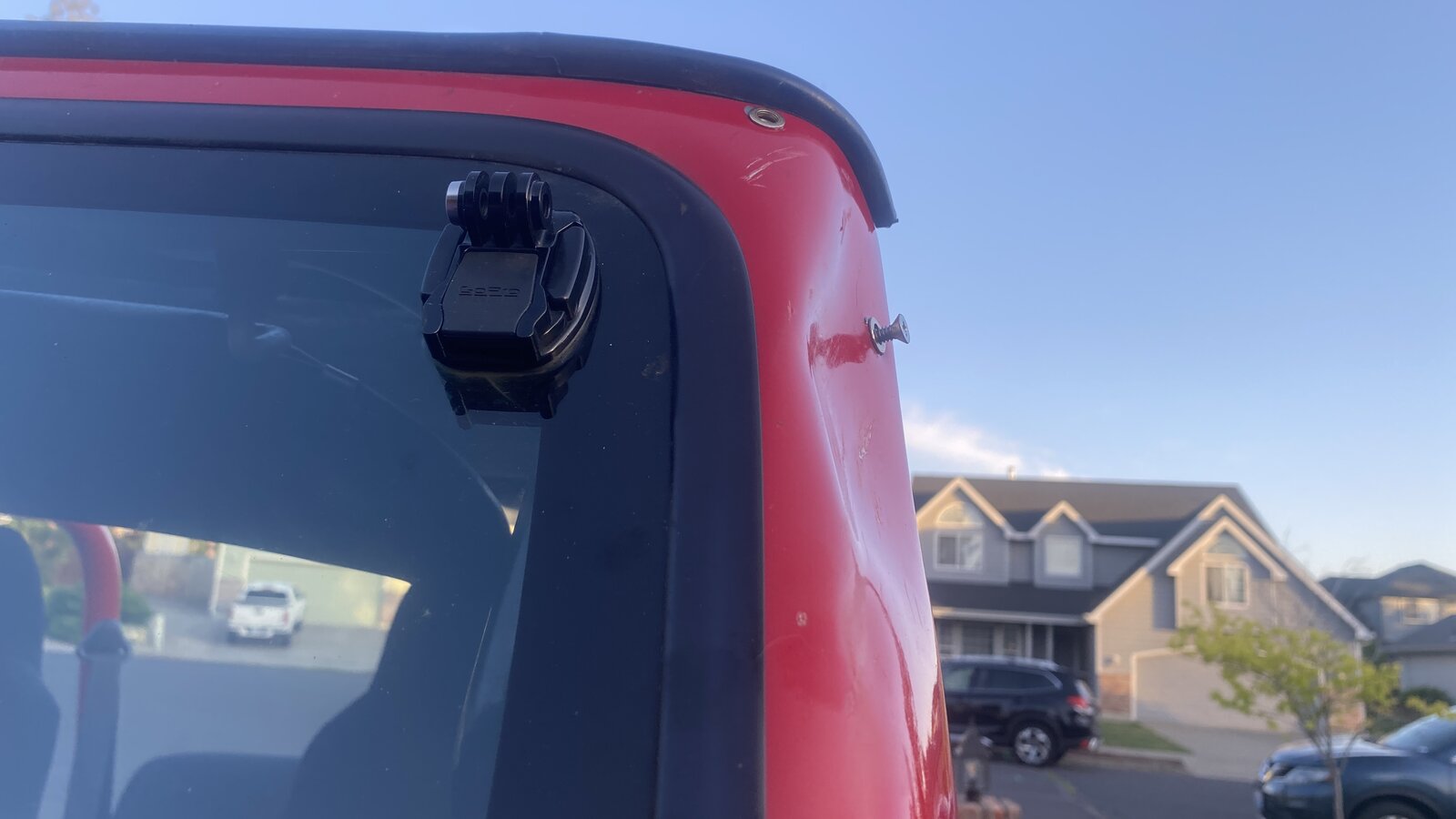

Very little damage. The A-pillar was bashed in. I put GR A-Pillar armor over it.

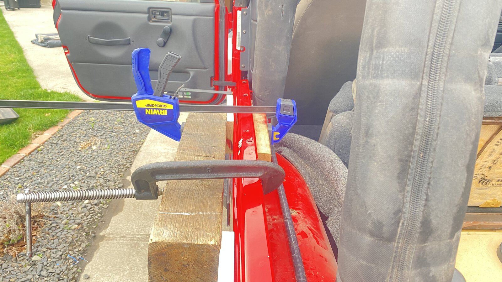

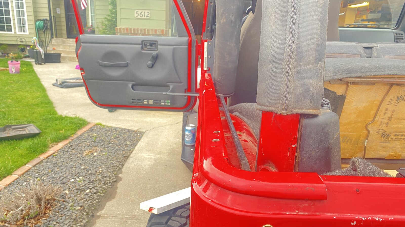

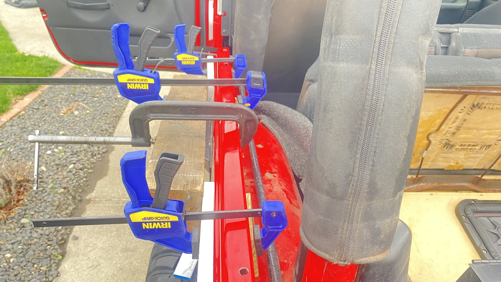

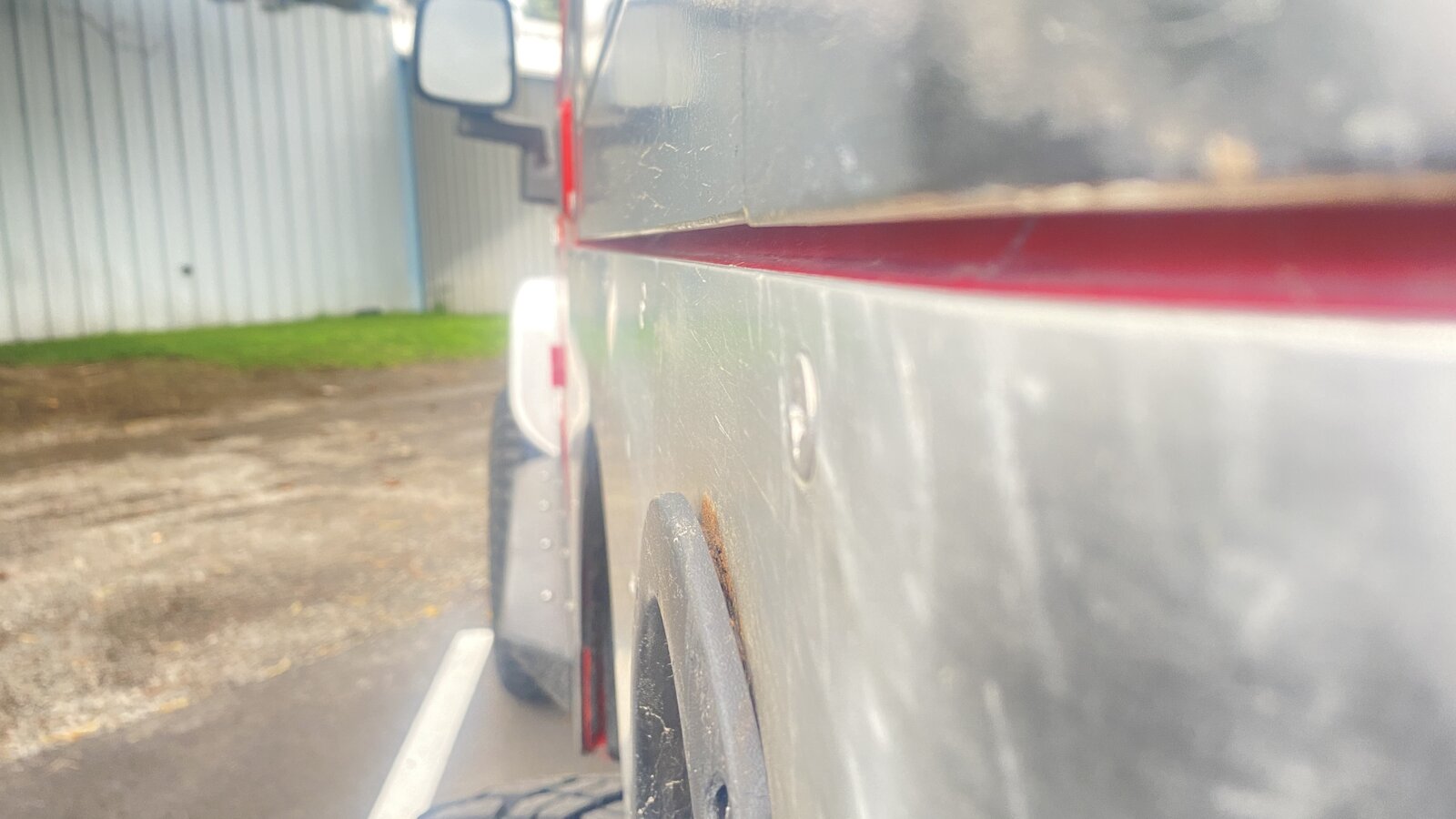

The rear quarter panel of the tub was bent in (I didn’t have a rear GR flare at that time, so it just laid over on the corner armor. Without a backing plate it dented the tub in, but I was able to bend it out, paint, and it’s straight again and unnoticeable.
A few nicks on the top of the door that I touched up. Door was fine!
The roll bar padding was torn in spots and the cage had a few scrapes. I painted them and it looks new. Here are some pics:
