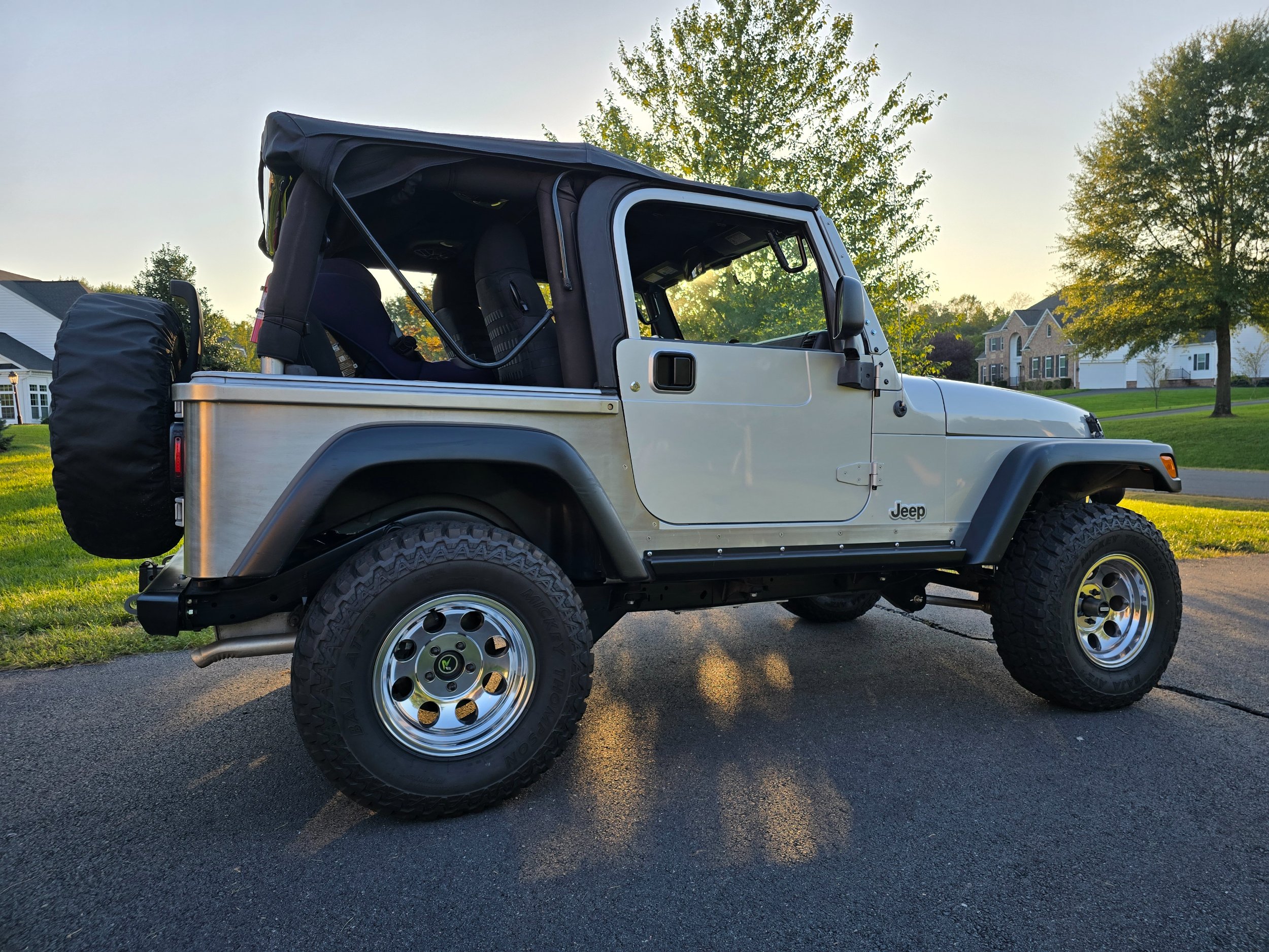

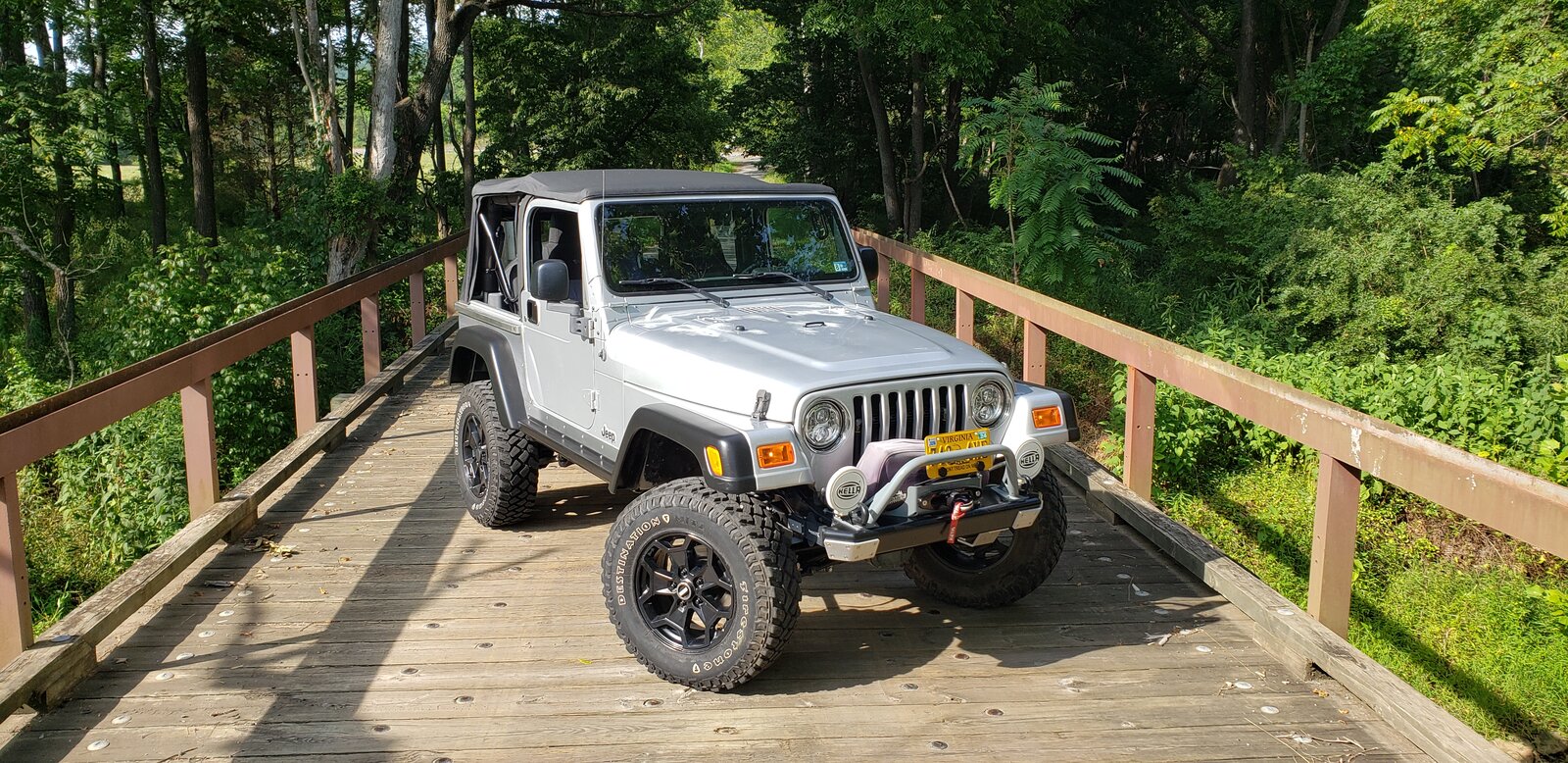

As was said, if you have space, two sets of wheels/tires solve a number of problems. With a big one being you can destroy the wheels on the rocks and not worry about it. The first picture is the daily driver wheels/tires, with A/Ts. The second picture is the wheeling wheels/tires, with M/Ts. For me, it's the ideal solution, but here are a few things to be aware of:
  • You'll spend more money;
  • You need extra space to store them;
  • Swapping them can get old, if you wheel frequently;
  • If you get wheels with different backspacing, you then have to swap the tire snubbers to fit; and
  • Different wheels and tires will impact the ride quality, especially if you swap between A/T and M/T tires.
