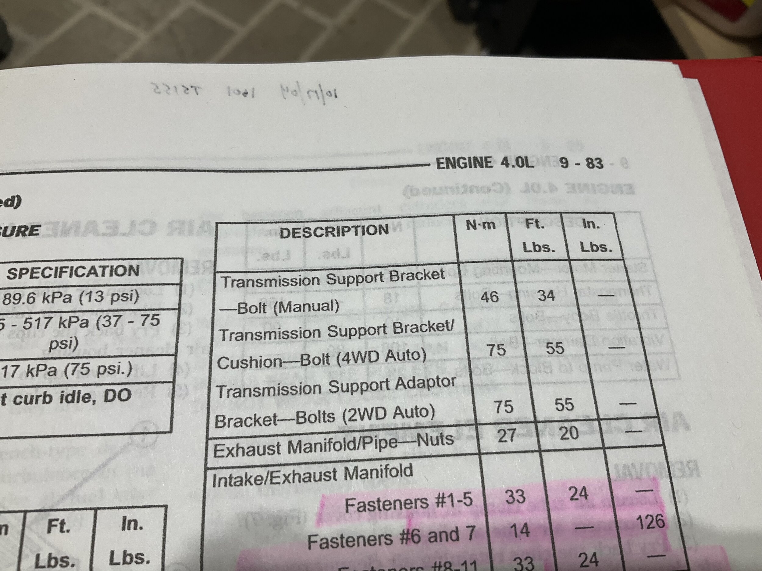

I found it complete with a diagram. For the mount to the transmission, it's 30ft-lbs, and the mount to the skid plate, it's 21ft-lbs
Reactions: Jerry Bransford
On a MT It’s 40 not 30
Transmission Mount Support Bracket to Transmission
However I have also seen it listed as 34 ft lbs.
