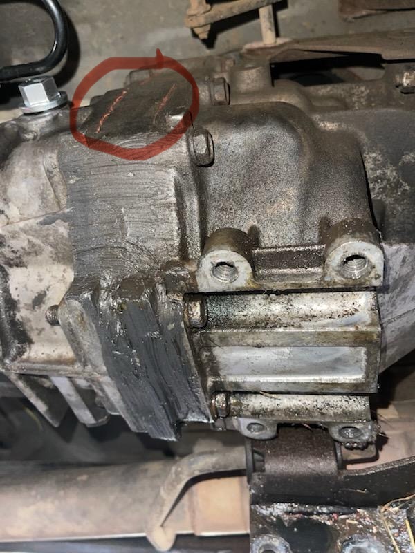

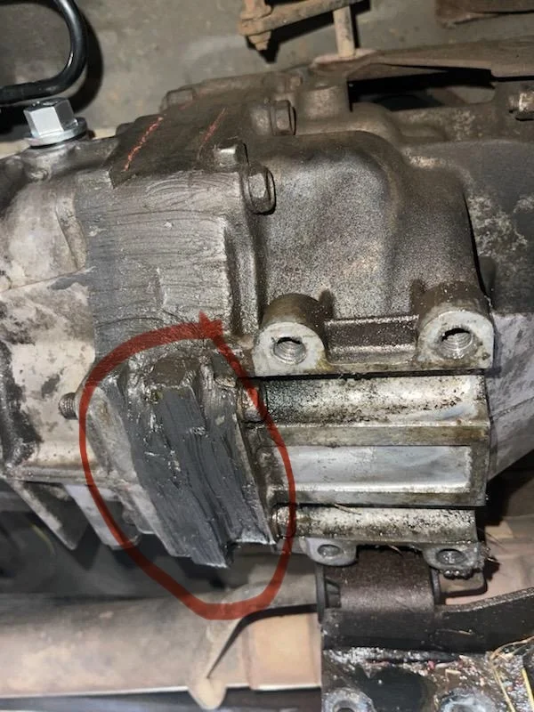

98 TJ manual transmission is leaking where it’s wet in my picture, is the old RTV gasket the culprit or in there a seal inside there that is work causing the leak?
Everything looks wet. Clean up the RTV and give everything a good clean first.
Shop told me the area I circled in red where you can see the old rtv silicon (orange)is what’s causing the leak down at the bottom, I thought I had got it fixed before but old shop just coated the bottom with silicon. I was told to take to transmission shop so they can remove the transmission and reseal it
