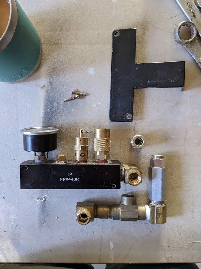

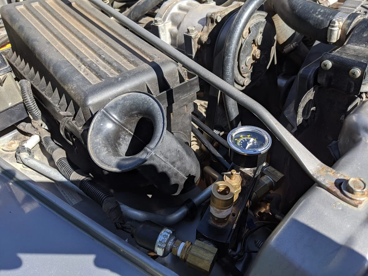

I spend some time re-plumbing the On Board Air system. Its been about 7 years since it was serviced and it leaked pretty bad. This time I used DOT truck brake hoses and push to connect fittings. Very clean and easy. They should handle the temp and pressure fine.

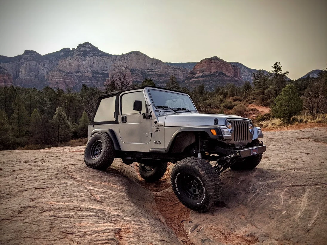

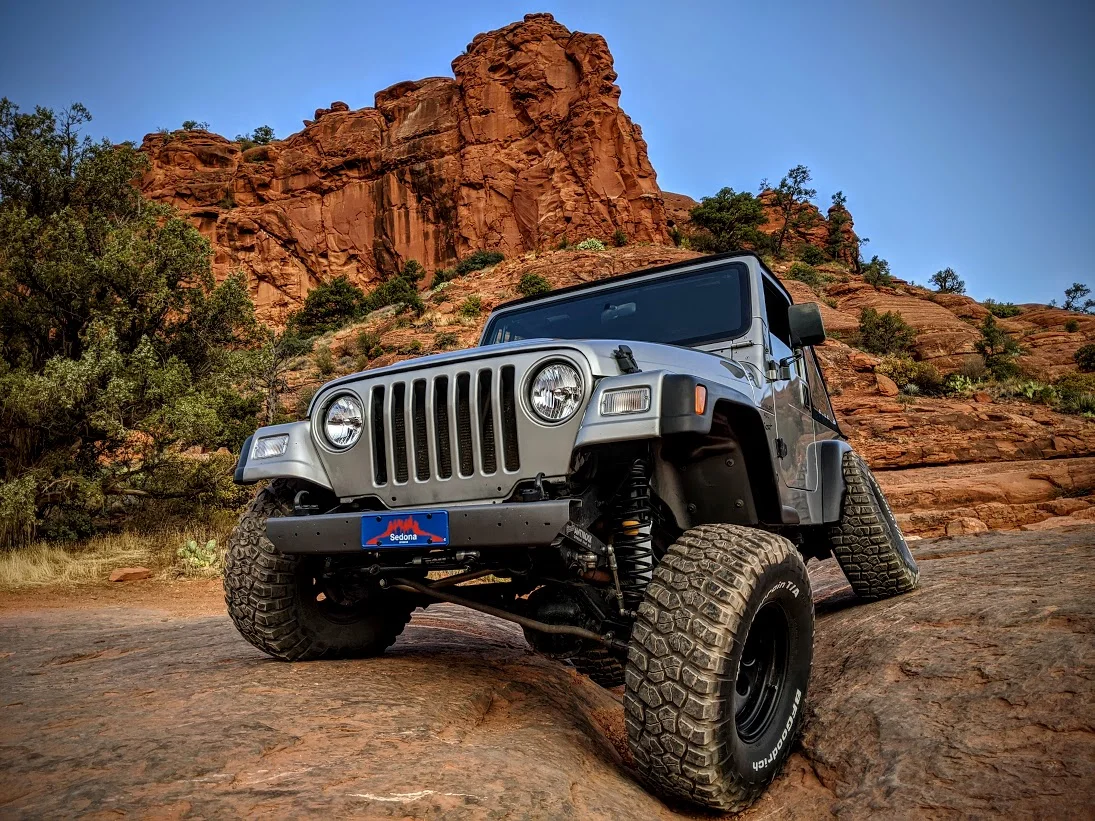

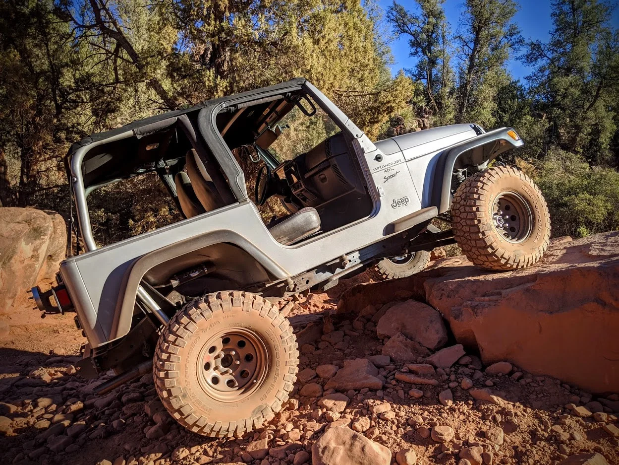

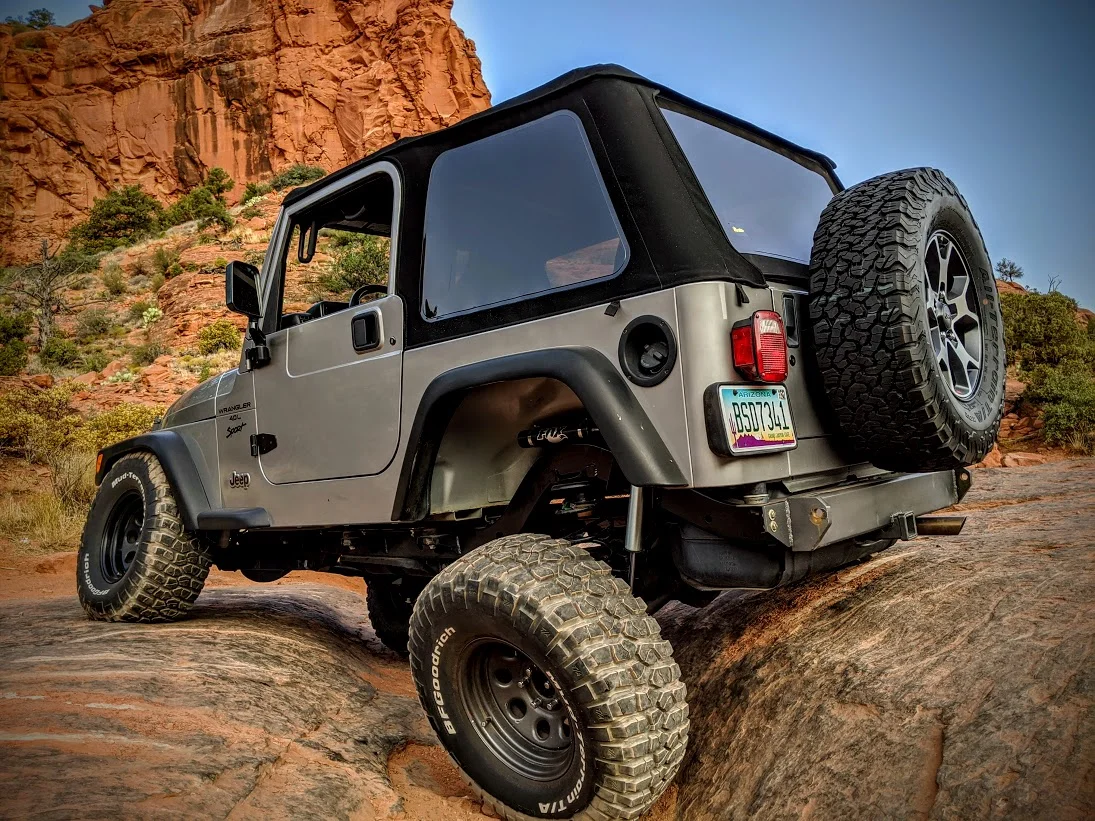

I wrapped up the outboard shock project. The procedure has been documented to death everywhere, so I'll keep it simple. Took it out to Broken Arrow trail near my home and flexed it in the real world so see if everything clears.
The Rear tires rub the fender flares at full flex, but not enough to hurt anything. With the 12" fox RR shocks, the coils will unseat at full droop, but they are retained so they don't go anywhere. At full stuff, the same coils actually have a little left before stack height. about an inch. Sorry, I forget to grab a pic of that. If it becomes a problem, I may try to find a 3" lift spring with a free length of 16"... the JKUR rear springs I'm using are only about 15". The biggest concern is then having to add bump stops to keep the springs from over compressing. Give and take.
The passenger front is hovering above the ground and so is the Driver rear.

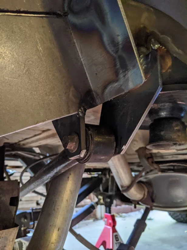

This was my solution to the trackbar mount. It wraps around the frame on the backside, and ties into the back of the outboard tower.

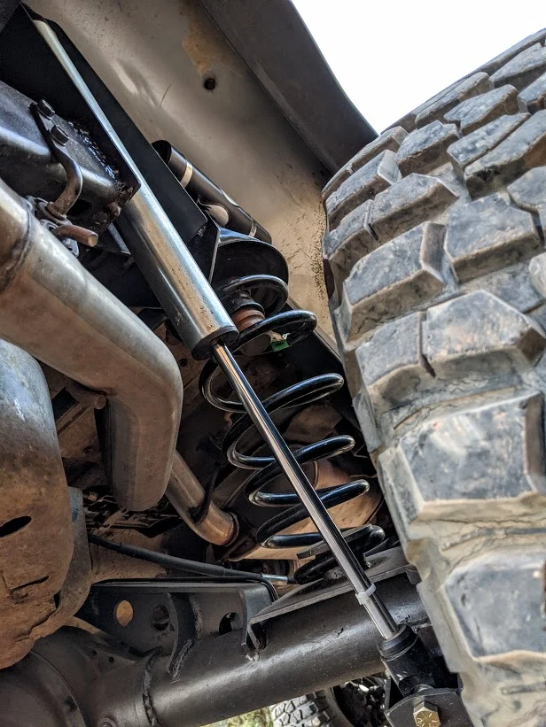

That's a long-ass shock. You can see the only bump stop extension I have over the factory is the built-in Artec extension on the lower coil perch. I'm guessing 1/2" to 1" over factory.

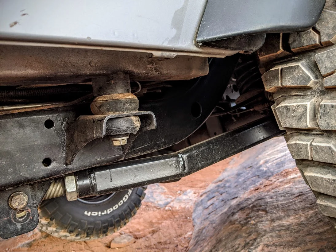

I now have 7" of up travel, and 5 inches of down travel in the rear. I put a bend in the lower control arms to clear the frame. You can see I also moved the lower frame side mounts up and inch... just fine tuning geometry. I put the body lift back on so I was able to move the upper frame side control arms up and inch, then moved the lowers to keep things where I wanted them. When I'm satisfied, I'll work on the mounts to make them look a little more refined.

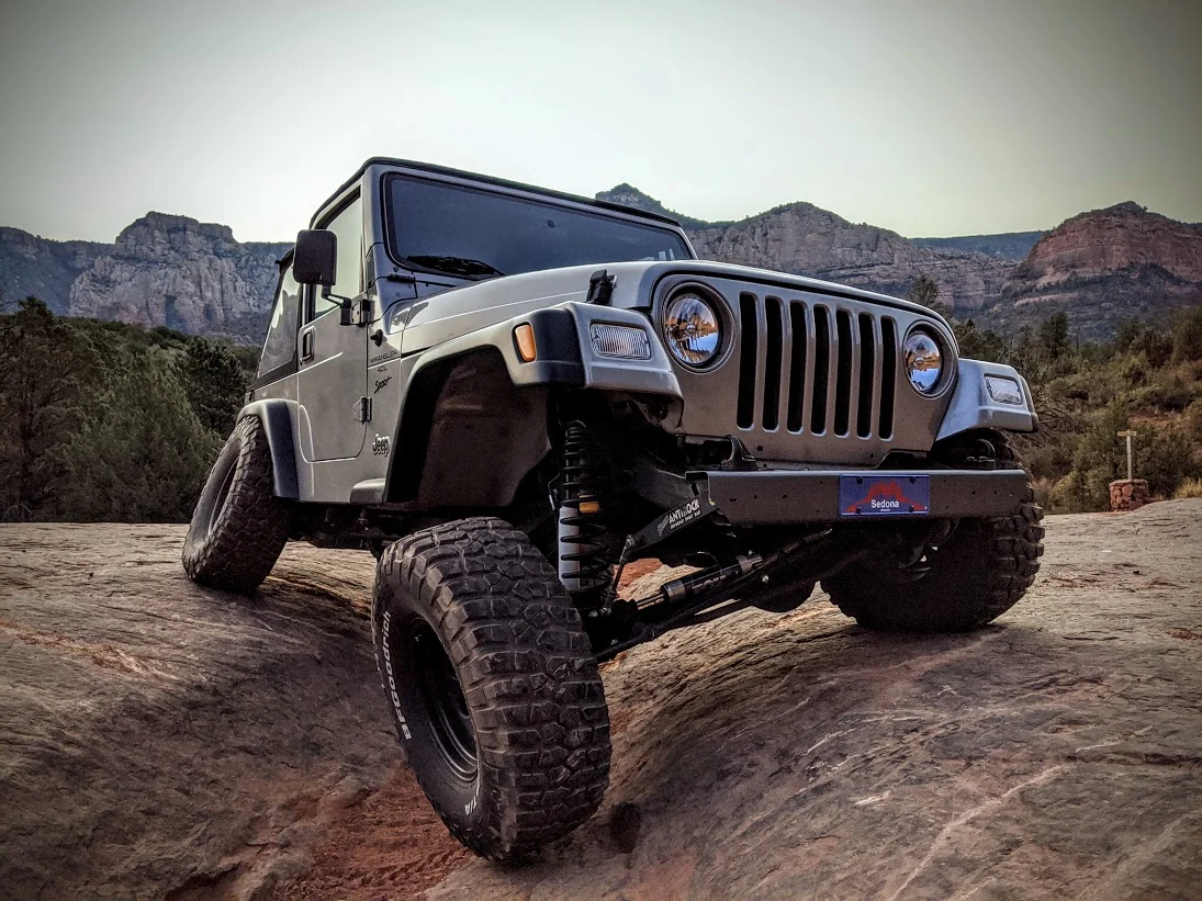

Why no Fox shocks in the front?
Looks great though!
They are coming. The rears were tuned by full-stack, So I'm going to order the fronts from them as well so its a matching tune.

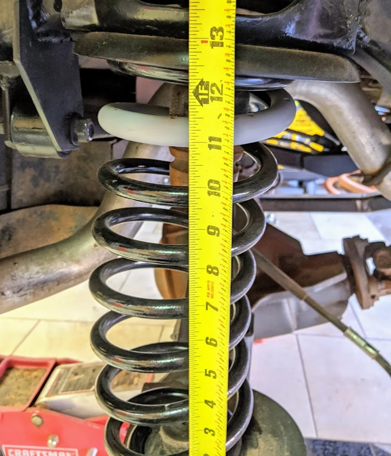

That's a little too tall for my build, so I cut an inch off of its free length. You can do this with a tangential spring end. There are several ways to end a coil spring... pigtail, box, and tangential: tangential is where the spring just stops and doesn't have any type of formed end. These can be cut. you should not cut off pigtails and square ends.
After the cut, the springs are right at 12" for ride height, 4" compressed, and 17" fully extended. Now my 12" fox RR shocks have 7.5"-8" of up travel and 4"-4.5" of down travel. I build a lower spring perch mount that the factory (JLUR) isolator fits perfectly around so the spring has a solid seat.

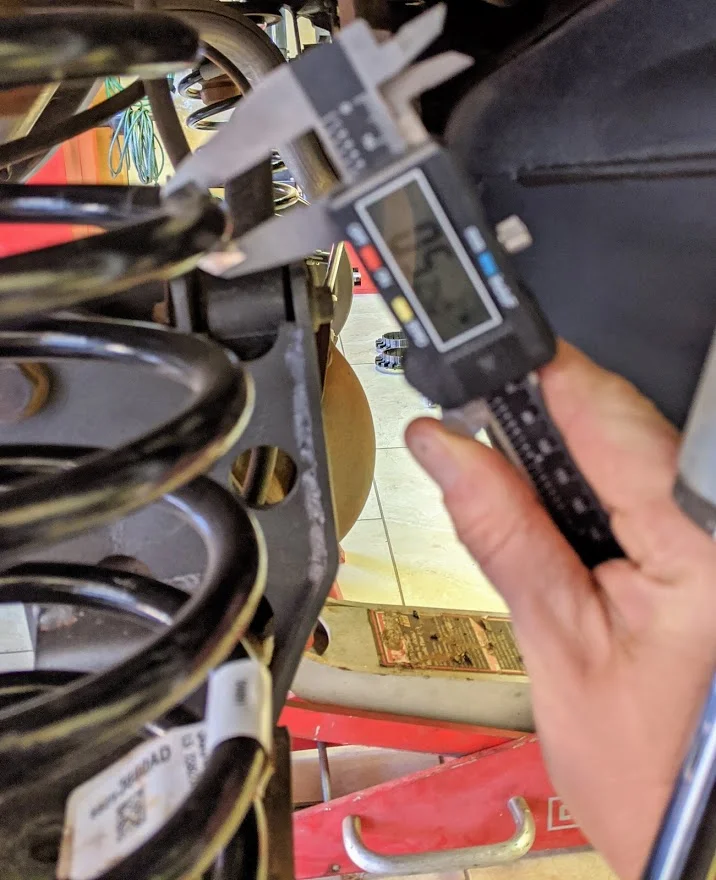

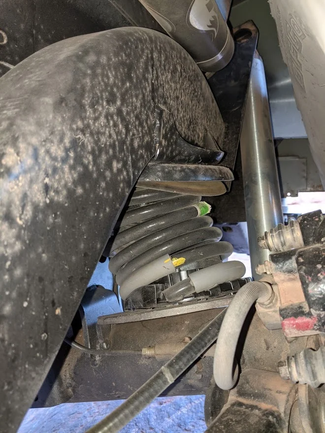

To those who don't believe in math... I've been told that there is no way that spring is only 4" tall fully compressed... I took this picture while flexed. There is 4" between the axle pad and frame bucket (measured as close as possible to the coil. The upper and lower isolators add 0.375" - 0.5" to height and the spring still has a little left to give before all of the coils bottom out. The shock is fully compressed.
