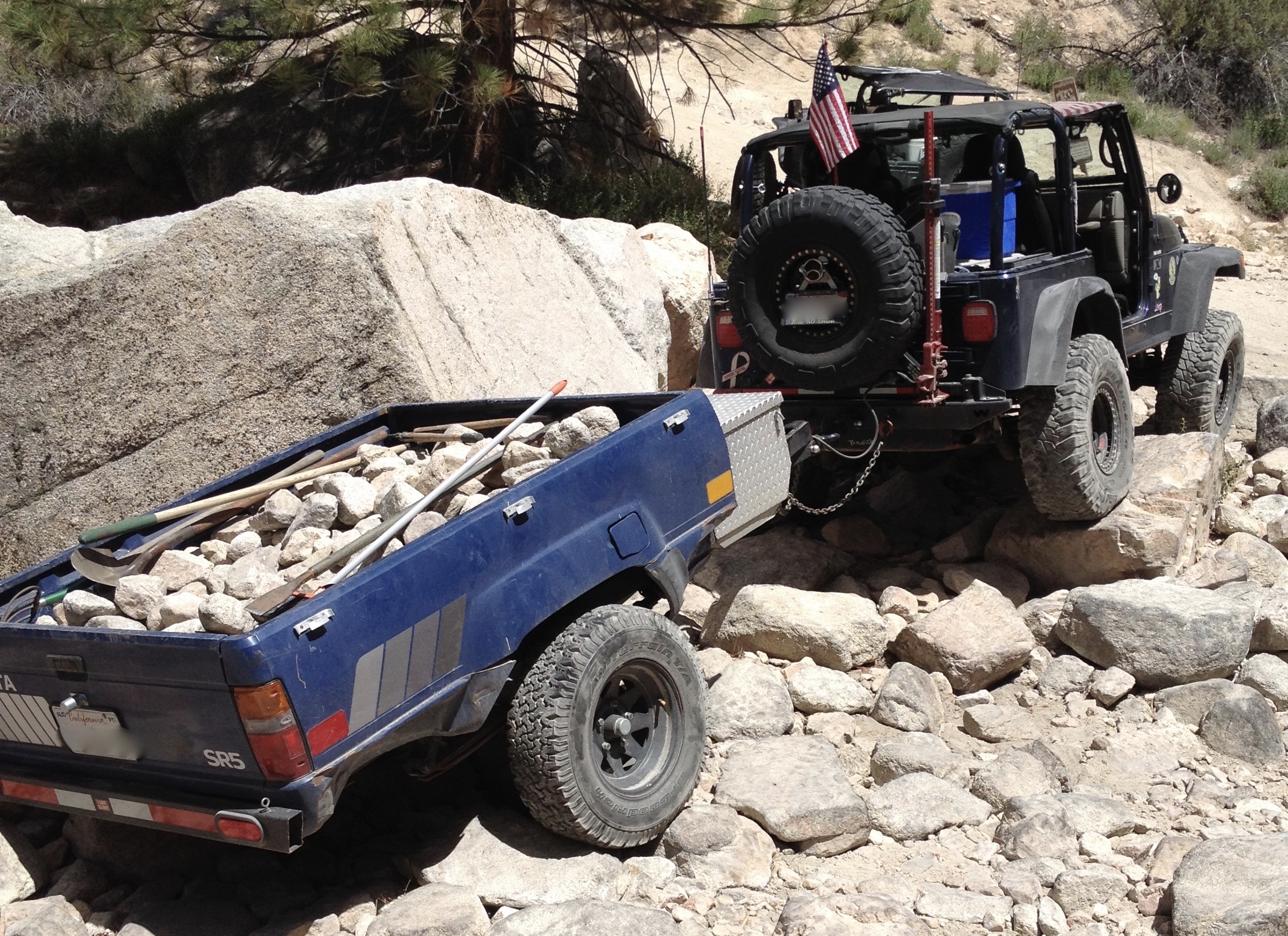

I've towed my trail/trash trailer all over the mountains and deserts of SoCal.
The bumper is a Warn and it had frame tie ins. I probably exceeded the tow rating with this load but it was during a off-highway use only.
I built the frame myself and the axle (3,500#) has electric brakes on it but I did that for the safety of others and myself. DMV did not require them.
Your Bantam fully loaded should be fine behind your TJ.
Edit. This was on Holcomb Creek Trail (3N93) , San Bernardino Mtns. at the West End gate keeper. We were loading out the (rock stackers) rocks and putting them into Gabion baskets to shore up another part of the trail.
It will be fine, but never forget that a Bantam trailer is short coupled and has no brakes. The extra weight will make a panic stop a real panic with a short wheelbase jeep and stock brakes, and sometimes even stopping behind the white line at a stop light can be interesting. BTDT
Better brakes may not be absolutely necessary, but are highly recommended.
When I built my trailer, I was also looking at Bantam's too. If I went that route, I would have installed a different axle with E-brakes on it.
Because I knew that it would be used for volunteer trail maintenance where anything goes to help out.
And I used a pintle hook and ring this particular day. On lighter days I use a ball hitch.
Oh and the tongue is long enough to jack knife it 90*. I've used every bit of that turning it around on the trail.

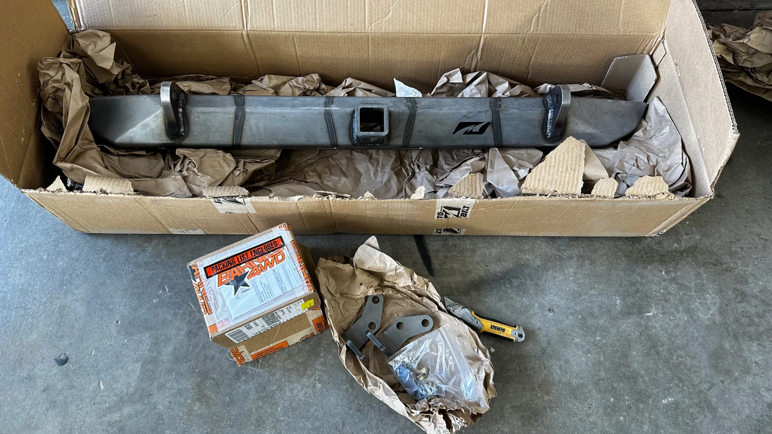

Brown Santa just showed up!
Time to get this to the powder coater!
Install it first, just to make sure you don't need to perform any tweeking. Be sure it fits before you get it powder coated. Nothing worse than having to redrill a mounting hole in fresh powder coat...
