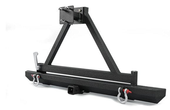

I don't know the brand as it was already on the TJ when I bought it. Will pics help?
It's basically like this one here...

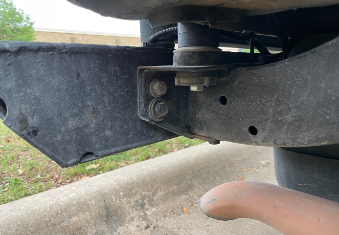

In this pic, see the 2 bolts on the left. A tie in will use those bolts and use the 2 holes in the frame to the right.
Where to find them? Google is your friend. Find out the manufacturer of your bumper and check if they sell tie ins to use.
