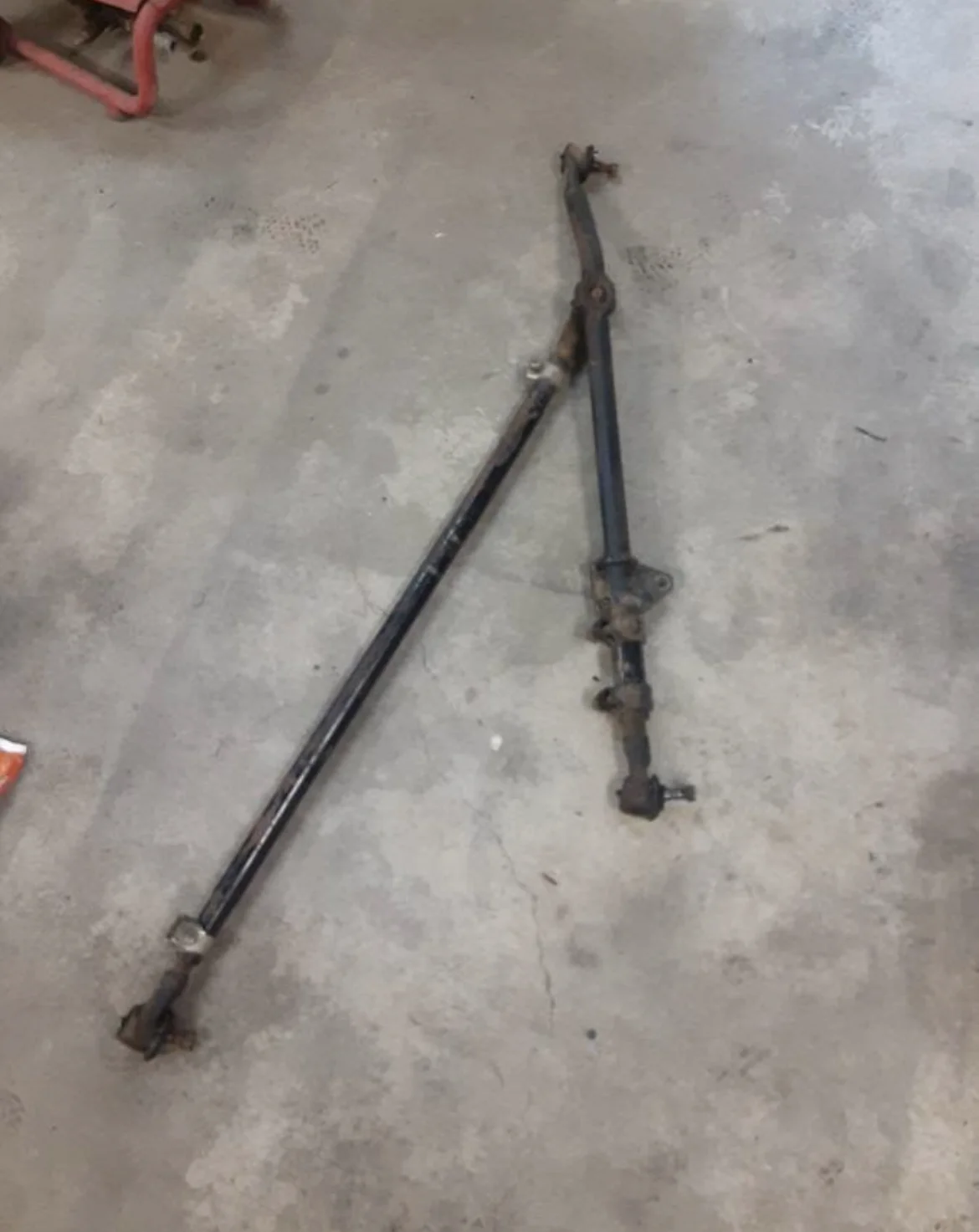

Sorry if it’s already been said but is this a limited run? I’m going to get currectlync eventually but need to know if i should order the upgraded tie rod now or will they be a constant product?
There’s a 250$ currectlync for sale near me… don’t know if that’s a good deal on a used steering setup or not….
Reactions: JMT
That's about what I paid in value of parts traded, so I would say it's a good deal if it's also in decent+ shape
This is about as good a photo as i have of it, unknown miles
That’s what I paid for mine used. I had to replace the boots on the TR ends, which was about $35. At least the TR ends we’re still in good shape because they’re $85 a piece.
