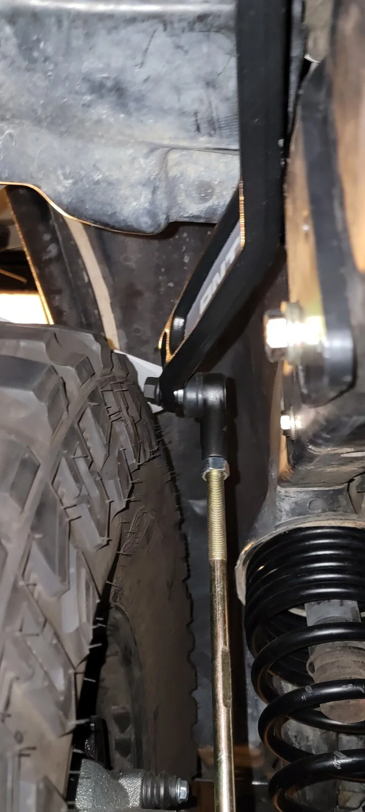

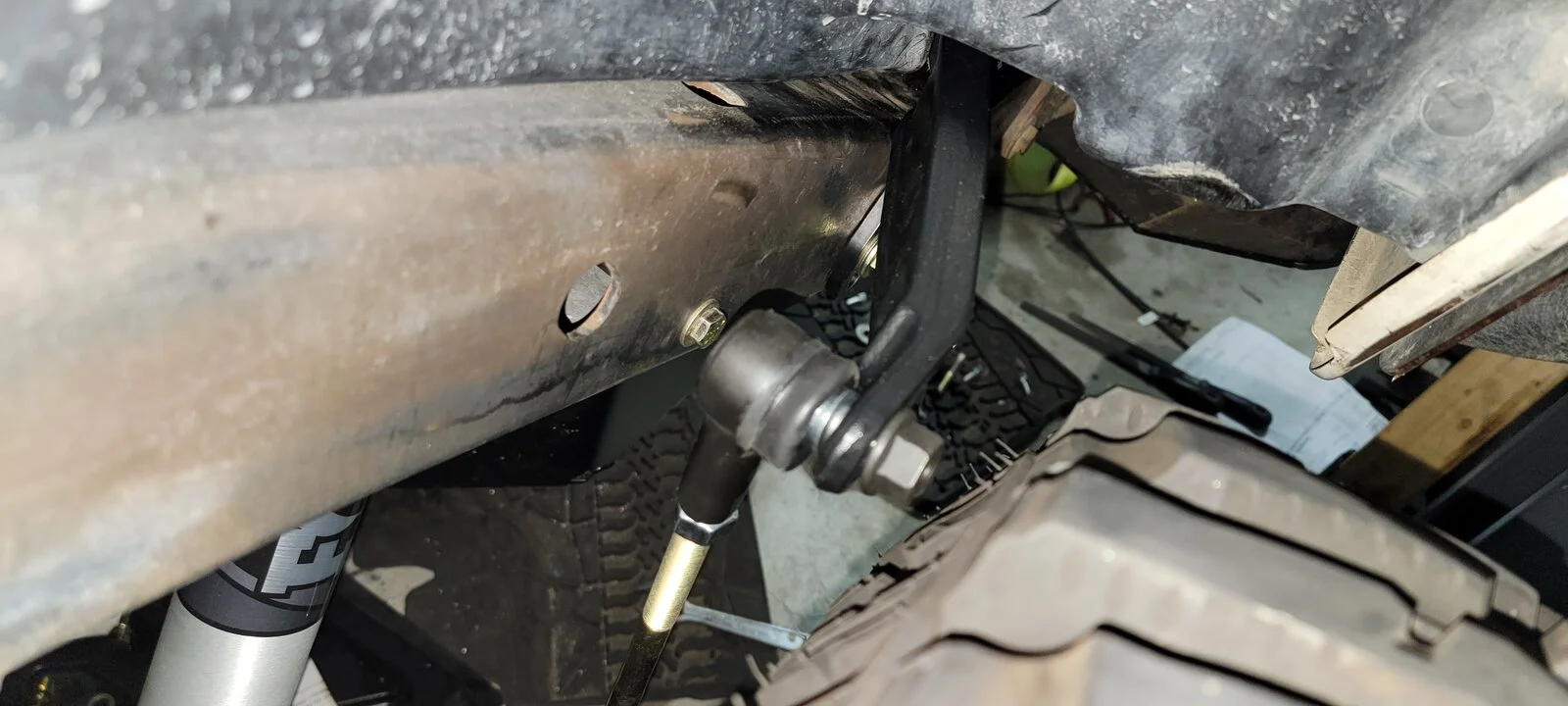

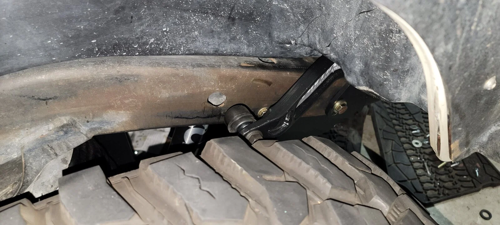

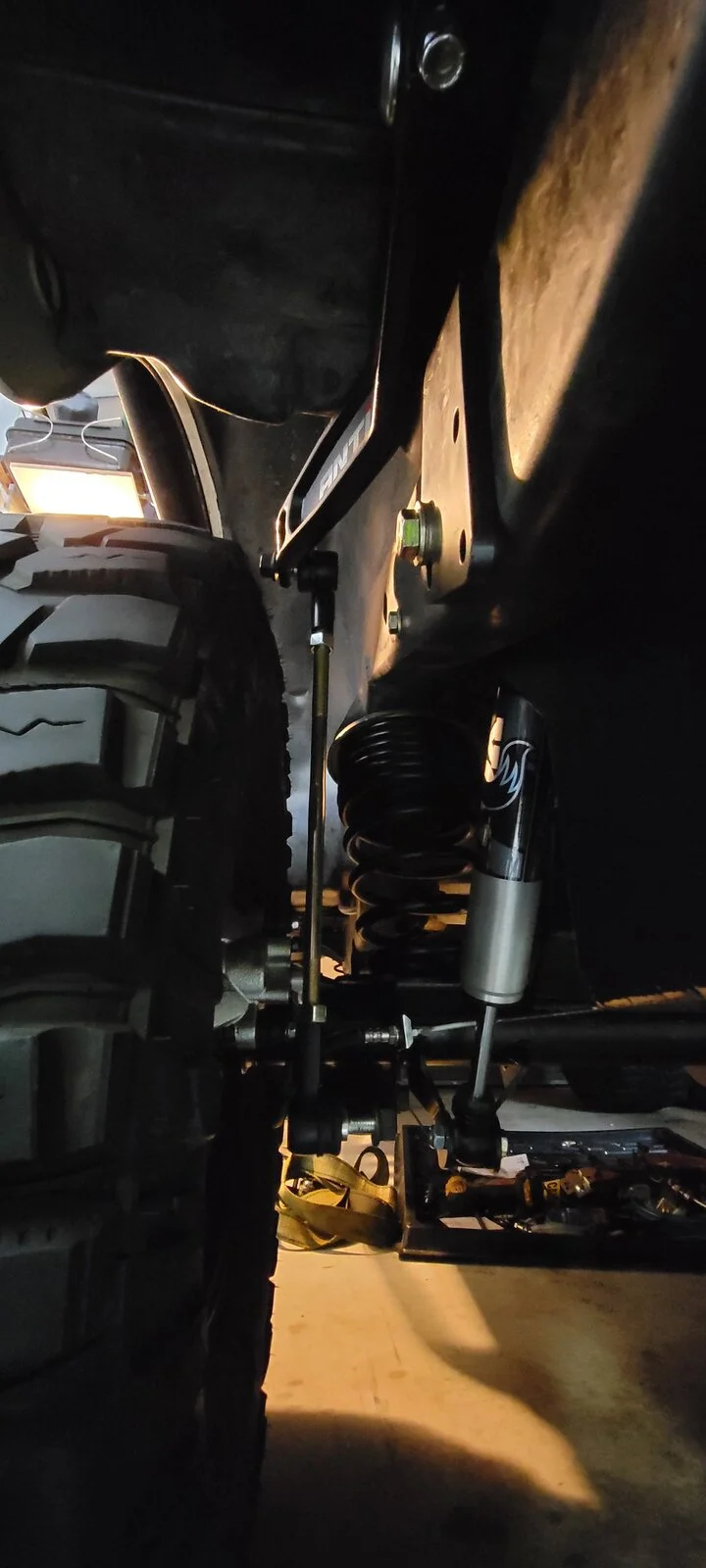

Here’s how mine was installed opposite side of yours.
Are these Tj/Lj rear Antirock arms bent toward the tire too much? I understand the need to clear the swaybar end links on the frame side or maybe the spring perch after relocation. There seems to be nothing on the outer side that would need that much clearance, at least none that I see on my Lj. There are plenty of Images of tire off setups , any more images at ride height?

Cycle it and find out.
I rub the tire going around the corner hard to the driver side with my rear antirock. I think the only thing worth doing would be spacers, but for now I watch the wear and just live with it and try to be gentle turning hard driver on the road.

If yours is only rubbing on one side, could your track bar be off? I spent a lot of time today double, triple checking that I am even on both sides before I test cycled.

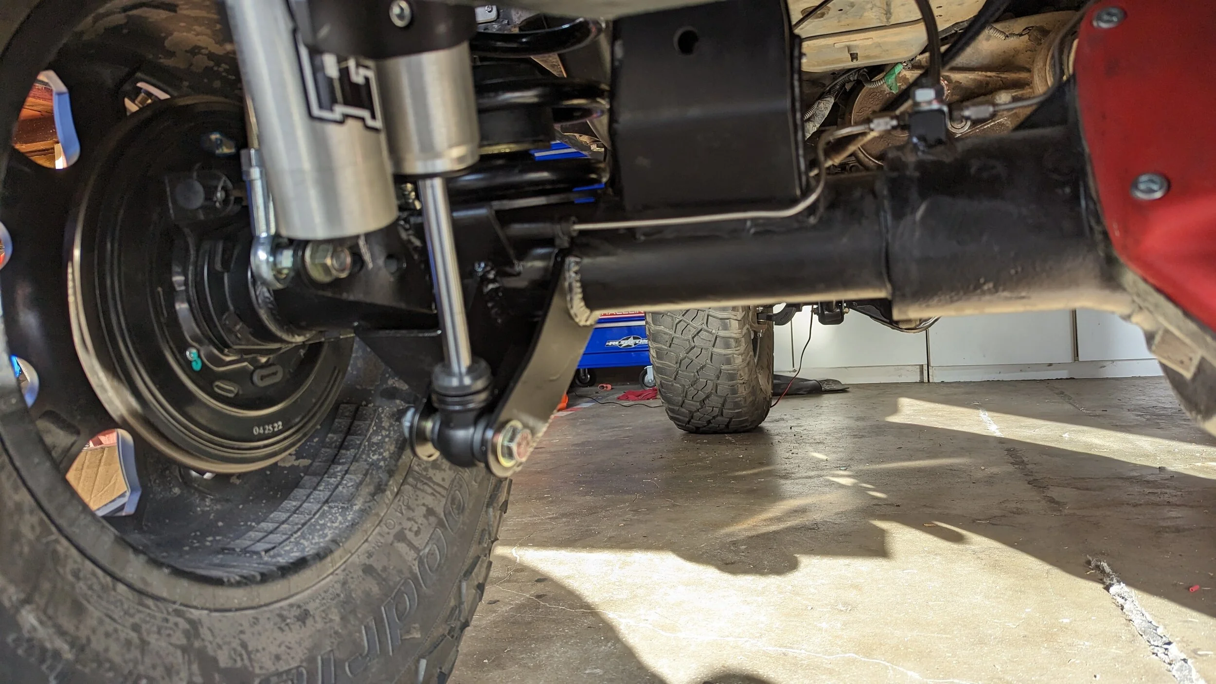

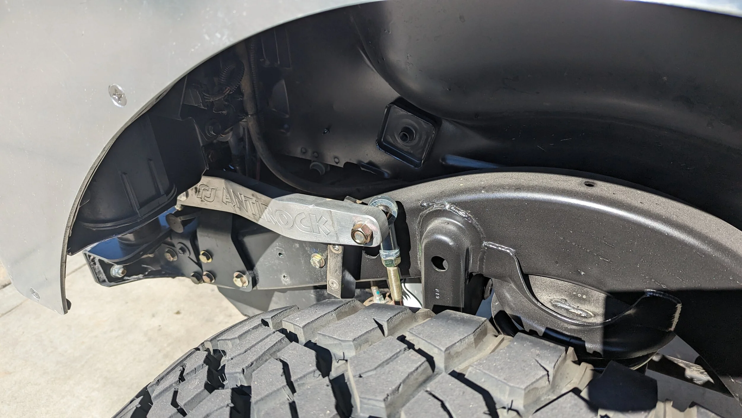

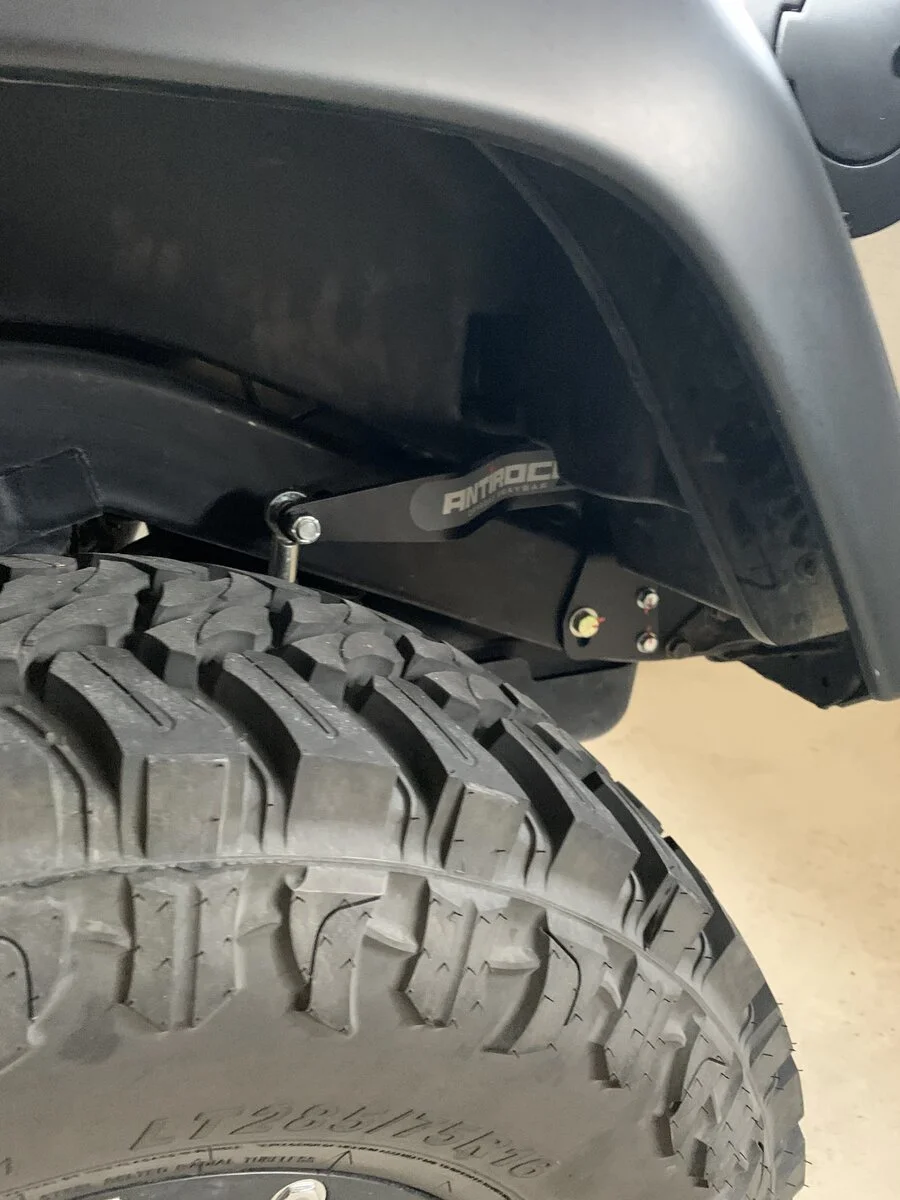

here's how it came out.
I notice your arm hugs the frame pretty close. Are thise arms as purchased or did you bend them to fit? Mine look nothing like this.
