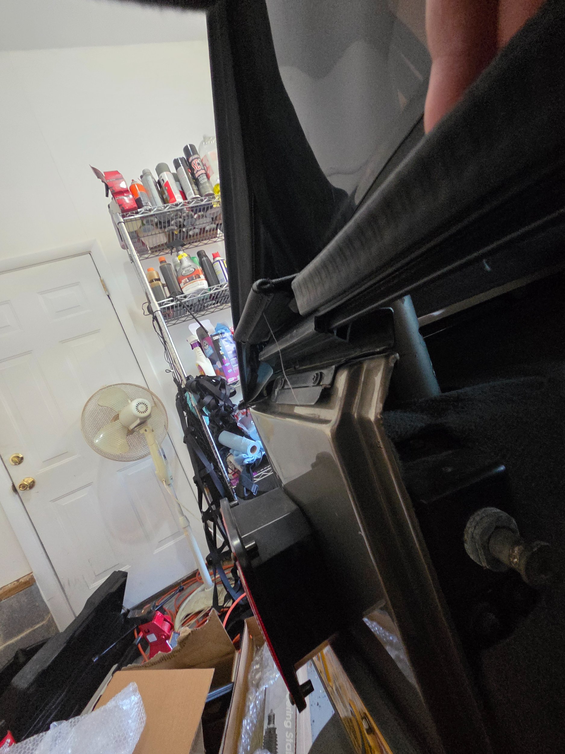

Z Ziondogg Member Original poster Joined May 16, 2025 Messages 70 Location Va Dec 20, 2025 #1 Can someone confirm the tailgate bar rotates into the brackets and not straight in? I'm having a hard time getting it secured.
AndyG Because some other guys are perverts Lifetime Supporting Member Joined Jul 30, 2018 Messages 18,668 Location Alabama Dec 20, 2025 #2 Ziondogg said: Can someone confirm the tailgate bar rotates into the brackets and not straight in? I'm having a hard time getting it secured. View attachment 661711 Click to expand... Crank the rig and turn on the heat. Once the top relaxes some. You can roll it into it. Be sure to open the garage door , outside is better- carbon monoxide Last edited: Dec 21, 2025 Reactions: suicideking, inkedrose and John Cooper
Z Ziondogg Member Original poster Joined May 16, 2025 Messages 70 Location Va Dec 21, 2025 #3 AndyG said: Crank the rig and turn on the heat. Once the top relaxes some. You can roll it into it. Be sure to open the garage door , outside is better- carbon monoxide Click to expand... Thanks, I'll give it a try. Reactions: AndyG and speeding_infraction
