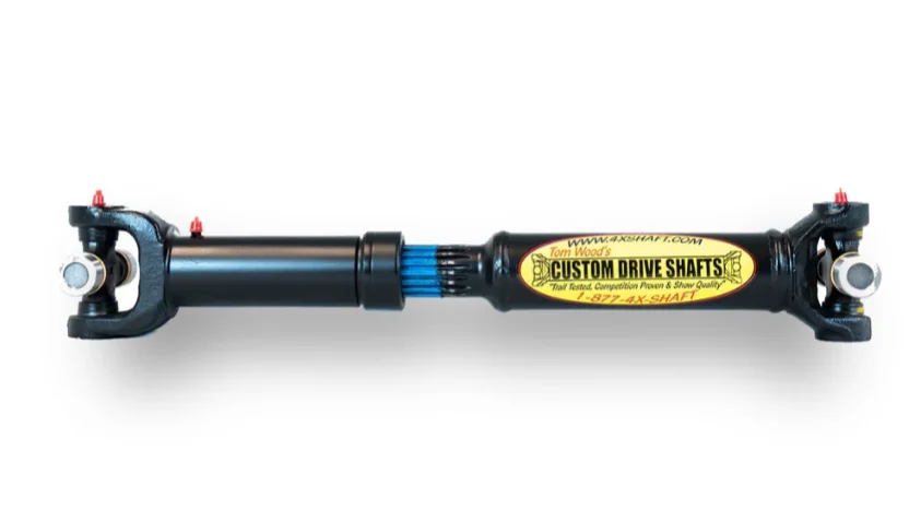

I would need to ask @Shawn at Tom Wood's or someone similar, but I believe the TJ/YJ didn’t have this style because they were too short. CJs had shorter drivetrains that resulted in longer driveshafts. The driveshaft on my CJ with the 3-speed manual was similar in length to that of a TJ unlimited. My guess is a driveshaft needs to be 18-20” or so before it can have a slip joint in it. But I’d need an expert to chime in on that.
Both the older cast iron transmissions and the cast iron gear drive transfer cases were shorter.
First I want to verify that "Stock" in this conversation means no suspension lift, right? That's my assumption but I frequently talk to people who say their vehicle is "stock" even though it is lifted or otherwise modified.
This type of shaft, the type posted above by @cpwolf, could indeed be made for a TJ with an SYE. It's slightly more complicated than that though. Any SYE I know of is going to come with a double cardan style yoke. These are slightly different than a u-bolt style yoke, which means you'd need a different yoke. To complicate things further the u-bolt yoke uses a different seal, which means you'd need a different output seal on the SYE. The yoke an seal together are around $100. If you do those things, you could run a shaft with a single joint at each end that has a slip yoke integrated into the drive shaft (the shaft compresses and extends). The shaft would be cheaper than a double cardan but you'd still be looking at around $700 for the SYE, yoke, seal, and drive shaft. If you can find a used stock output shaft, maybe one that someone else took out when installing an SYE, for $100 you'd only be spending around $400 for the output shaft and stock type drive shaft.
Normally I'd say that there's no reason to install an SYE if you don't plan on running a double cardan. However, if the output shaft has to be replaced anyway, I'm guessing because it is bent or damaged, it might make sense to just install the SYE. Even without a double cardan the fixed yoke output on the transfer case is a better design. I don't know for sure because I wasn't in the room when the decision was made, but I'm pretty sure the reason they switched to slip yoke style transfer cases in the YJ an TJ was due to cost. Whether or not the OP should do this depends on the price, how much you prefer one design over the other, and how much that preference is worth to you.
