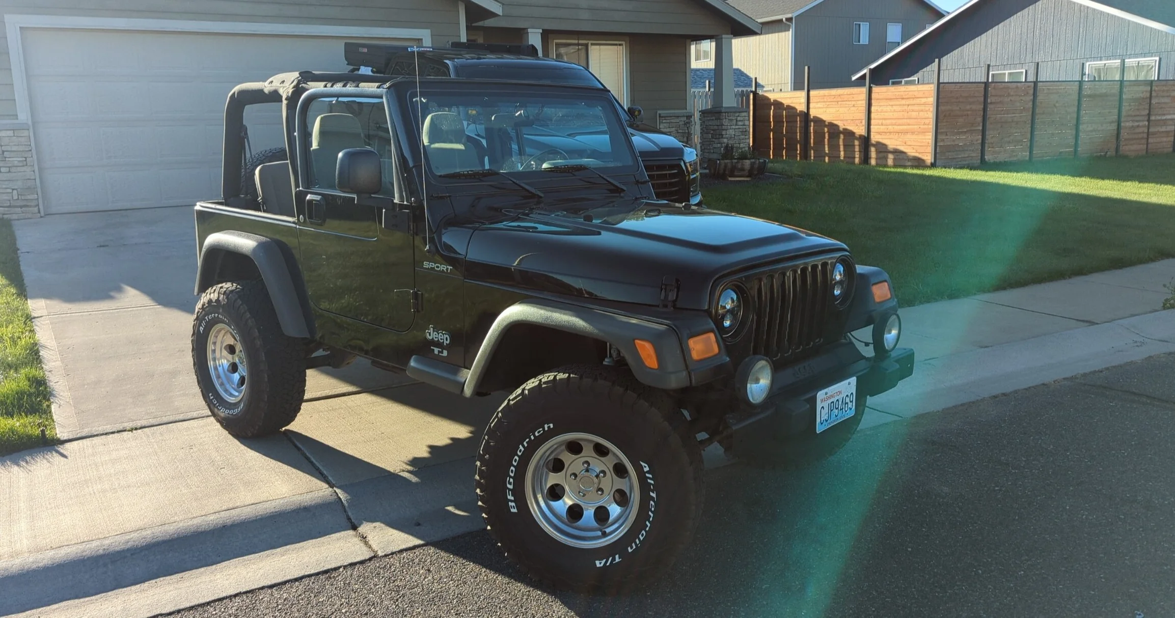

My kids new to him 2006 on 2.5" springs... Steering was a little washy but really twitchy, quick. Did a dry steer inspection, found a steering tie rod and front trac bar bushing bad. Replaced all with new trac bar and ZJ steering, set toe and she is stable but man is the steering still twitchy. Any input on the wheel and the thing just darts, so this part hasn't really changed any. It's on narrow 33's, 10.5 wide @ 26 PSI for now. Is this a product of the tires (thinking not) or steering box issue?
There is a small clunk in the back on a bump, need to chase this down next weekend but I do not believe it is the rear trac bar.

Looks like his 06 has 2.5" lift springs and 2" pucks in the front, sits level. My 2002 has 2.5" springs and a 1.25" BL. His bottom of front spring to underneath side of shock tower is almost 1" higher than mine however, my 02 sits 1" taller at top of fender/bottom of hood. I'm super confused here, only thing that makes sense is that the 2006 had an incredible amount of rake in it? Either way, I would suspect that this could create some caster issues with 4.5" of height change.?.?

To add some closure here.. The caster was 4.25, this blows my mind as I never had this problem with the same setup on my 02 before adjustable control arms. Anyway, got him a set of control arms and got the caster to 7 degrees. Steering is still very fast but much more stable.
