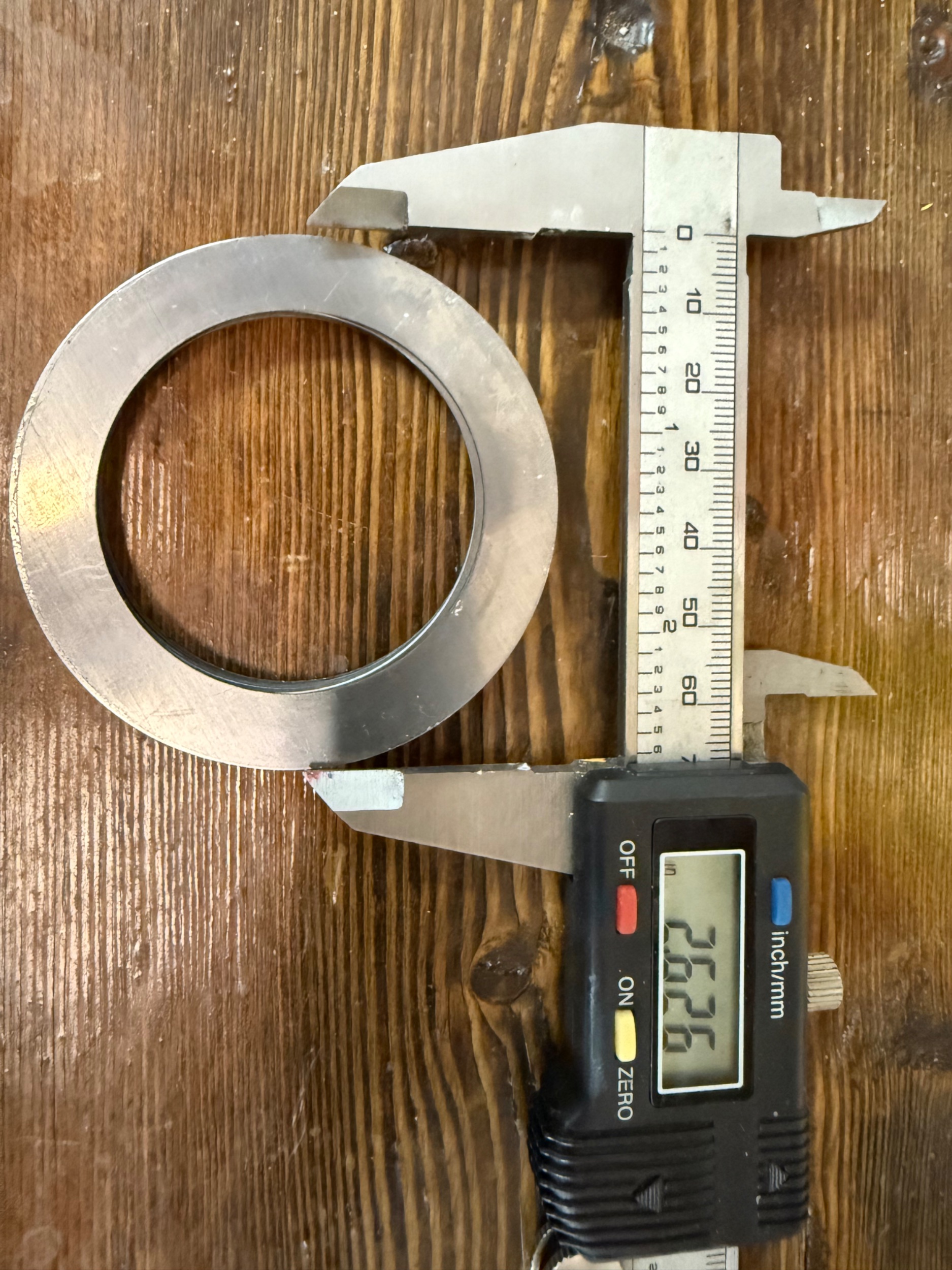

Trying to replace the ring and pinion on my LP TJ Dana 30 with a Super 30 kit and Eaton e-locker.
Ordered SK30214 and they appear to be inboard shims.
Will and Dana 30 outboard shim kit work?
-Mac
Looks like the OD is 2.65" and they're about .5 inch "wide."
Dana 44 shims look to be 2.25".
-Mac

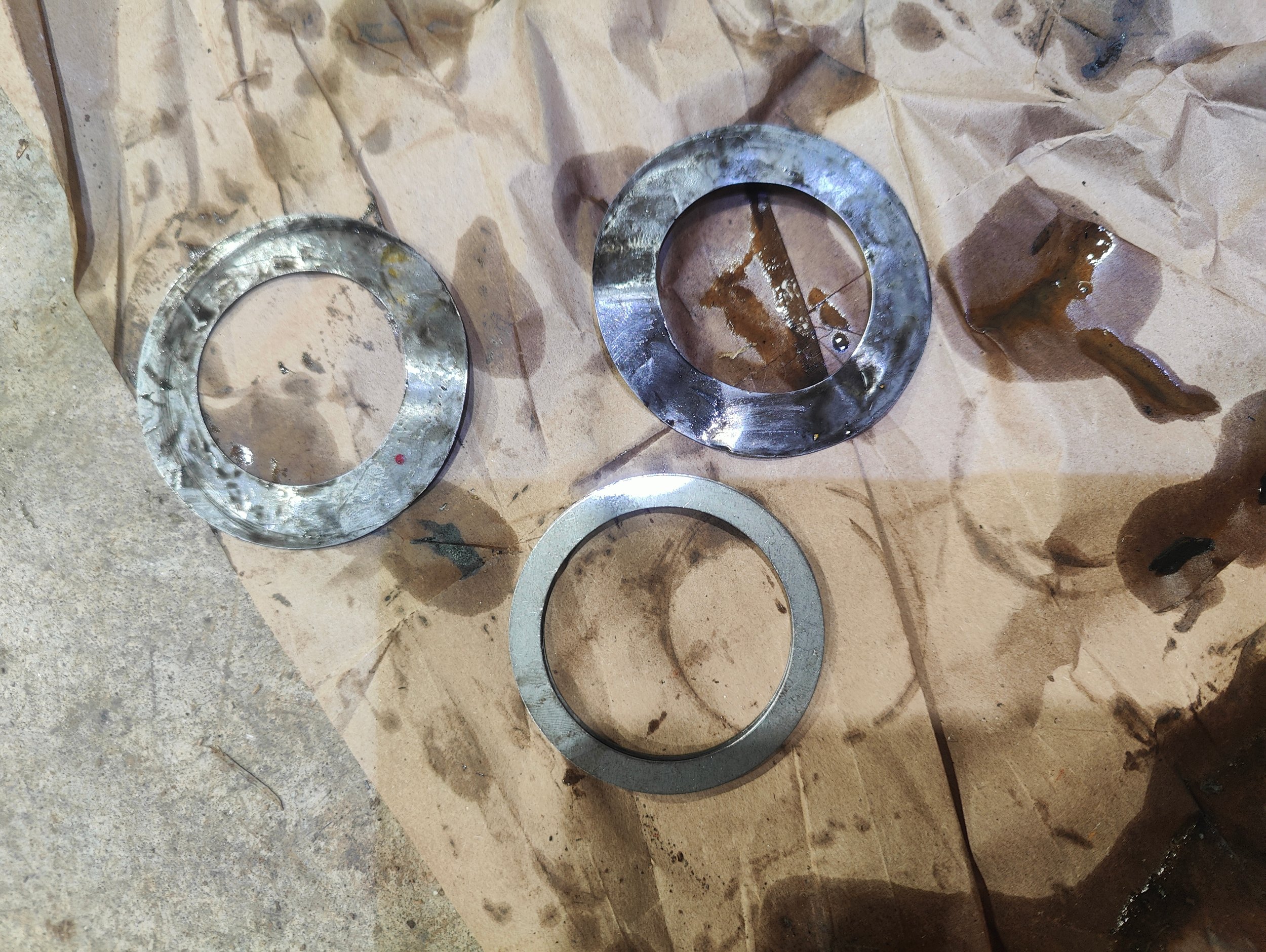

I’ll dive down the rabbit hole and see if I can recall what kit I used. I think this is the pile of shims I used. I think this is what your asking..
They are in a 713F200 box, but I’m not sure it’s the kit they come in.
Yup that would be them. Have a part number?
Looks like the shims for a Dana 30 are supposed to be inner shims...I can use what I ordered and pull the carrier bearings and replace the outers with same size inners.
What I'm trying to figure out is how I ended up with outer shims...they must have come with my install kit, and I can't find the leftovers anywhere.
Trying to figure out how to order the outers... although at this point I think I need to use the inners unless I want to wait a few weeks for shipping.
