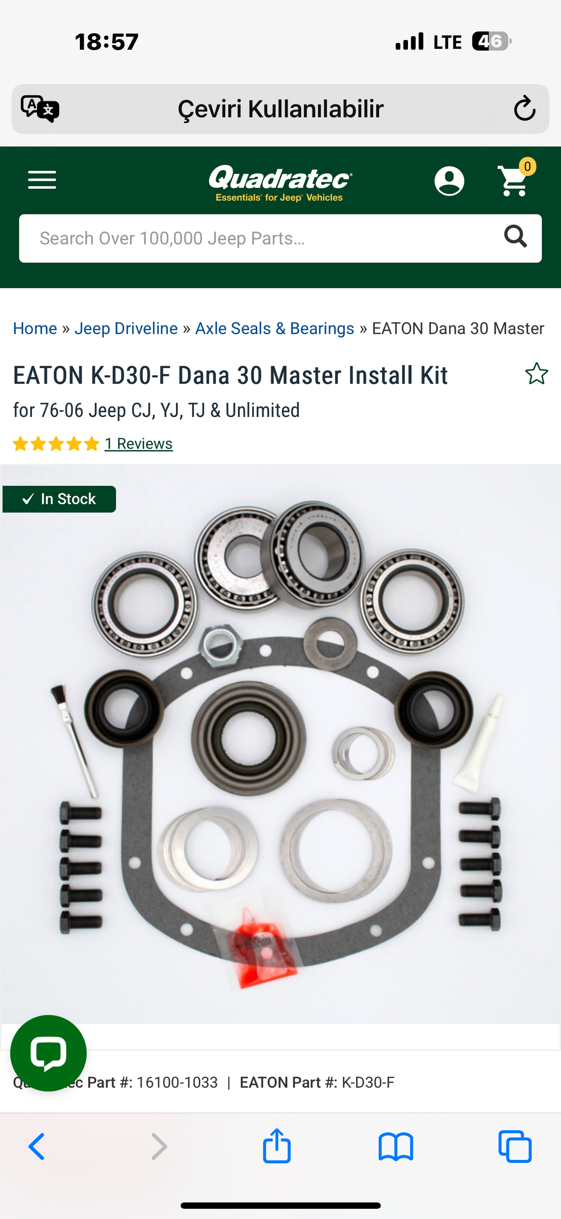

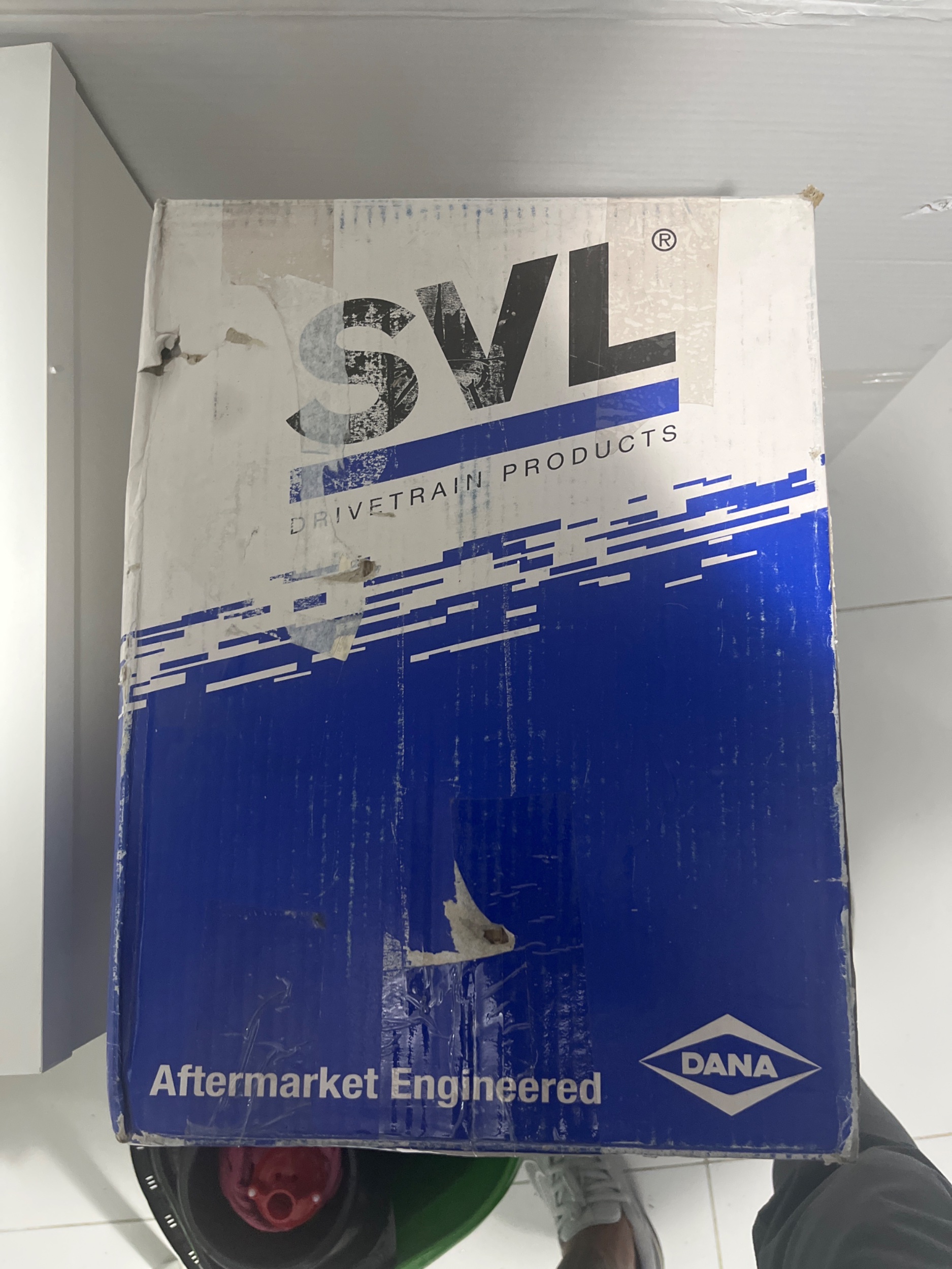

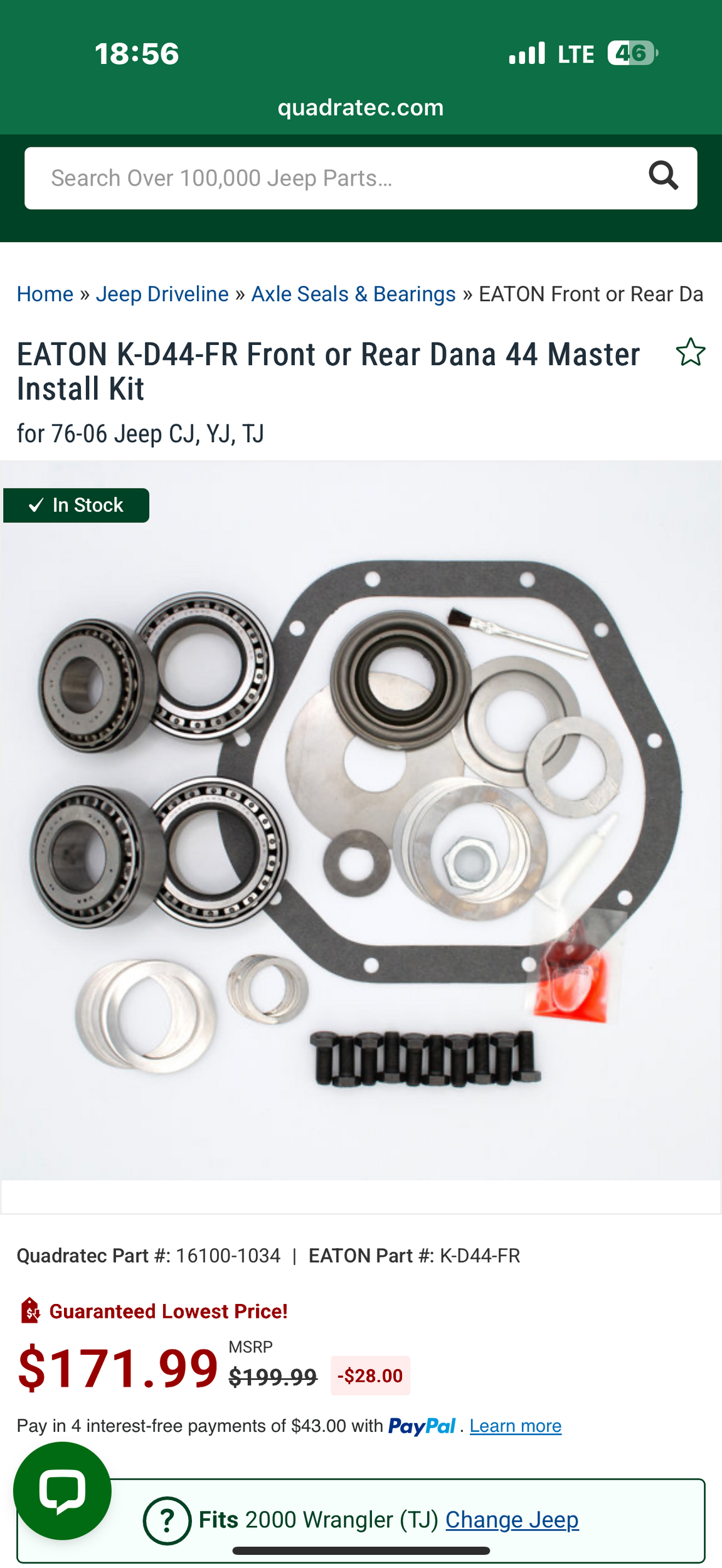

İ already bought them :/
Knowing you're OCONUS (outside the continental unite states), I'm pretty sure there's not much support for Dana equipped vehicles in Cyprus. My suggestion, and if you're going to have a local shop do it, buy DANA Spicer master install kits using quality components with Timken bearings. Also, since you're opening up the rear axle, and you're having US products shipped, replace the rear axle seals and bearings.
İ already bought install kit that i share.. i wish it will work🙏🏼
