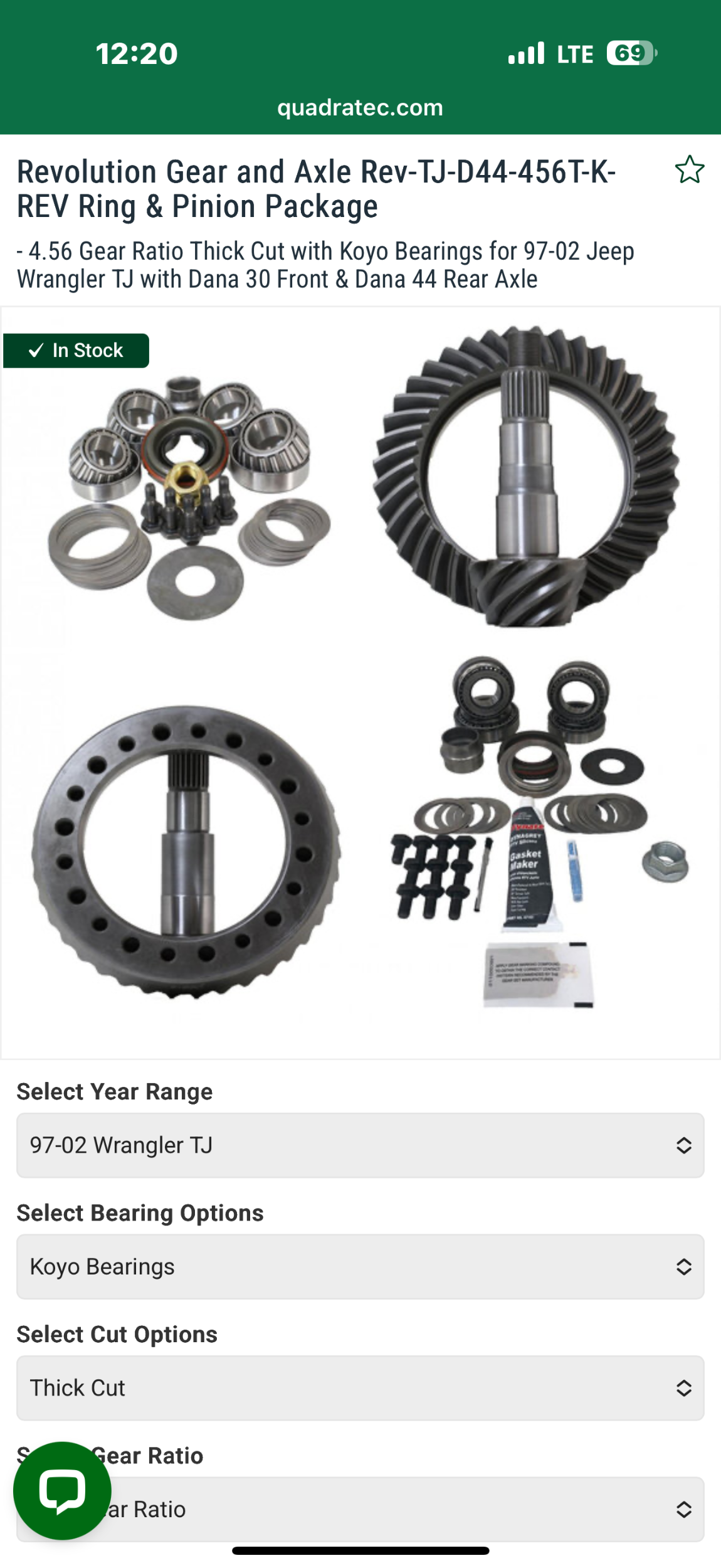

I bought a 4.56 ring and pinion and an install kit for my Dana 44and dana30 3.73. But I think I need to buy a 4.56 thick gear to change it. Or 3.92 and up. Otherwise, I can't change the ring and pinion I bought. Is that correct? Thanks in advance for your help.
That or change out the carrier.
This is why most folks that do regears install lockers...it solves the carrier break problem neatly.
-Mac
-Mac
What u think about it?
