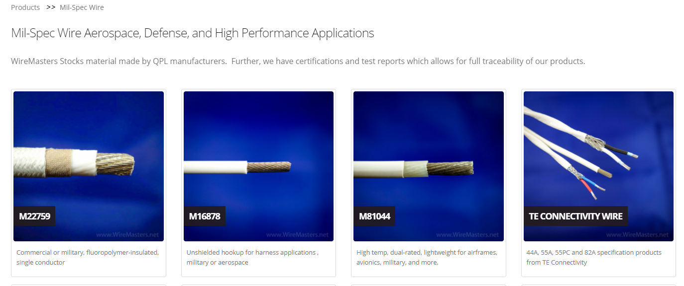

Aerospace Mil-spec is never a bad choice:
https://www.wiremasters.net/products/mil-spec-wire
