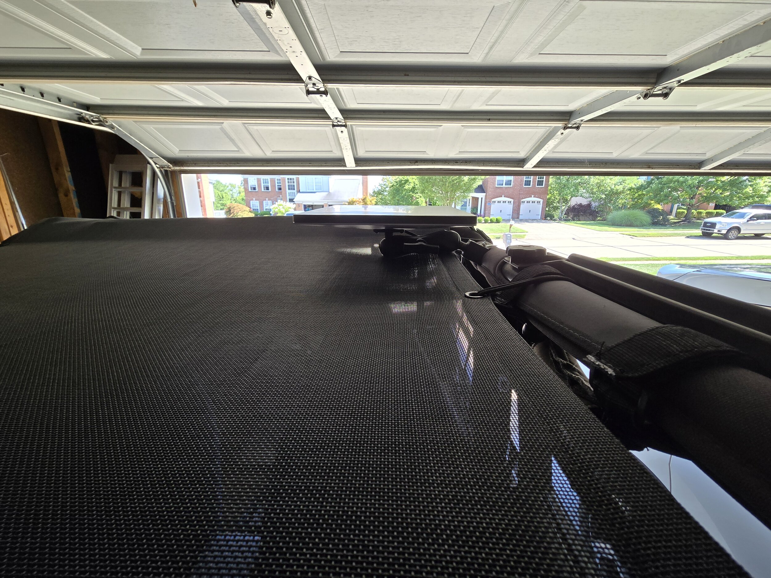

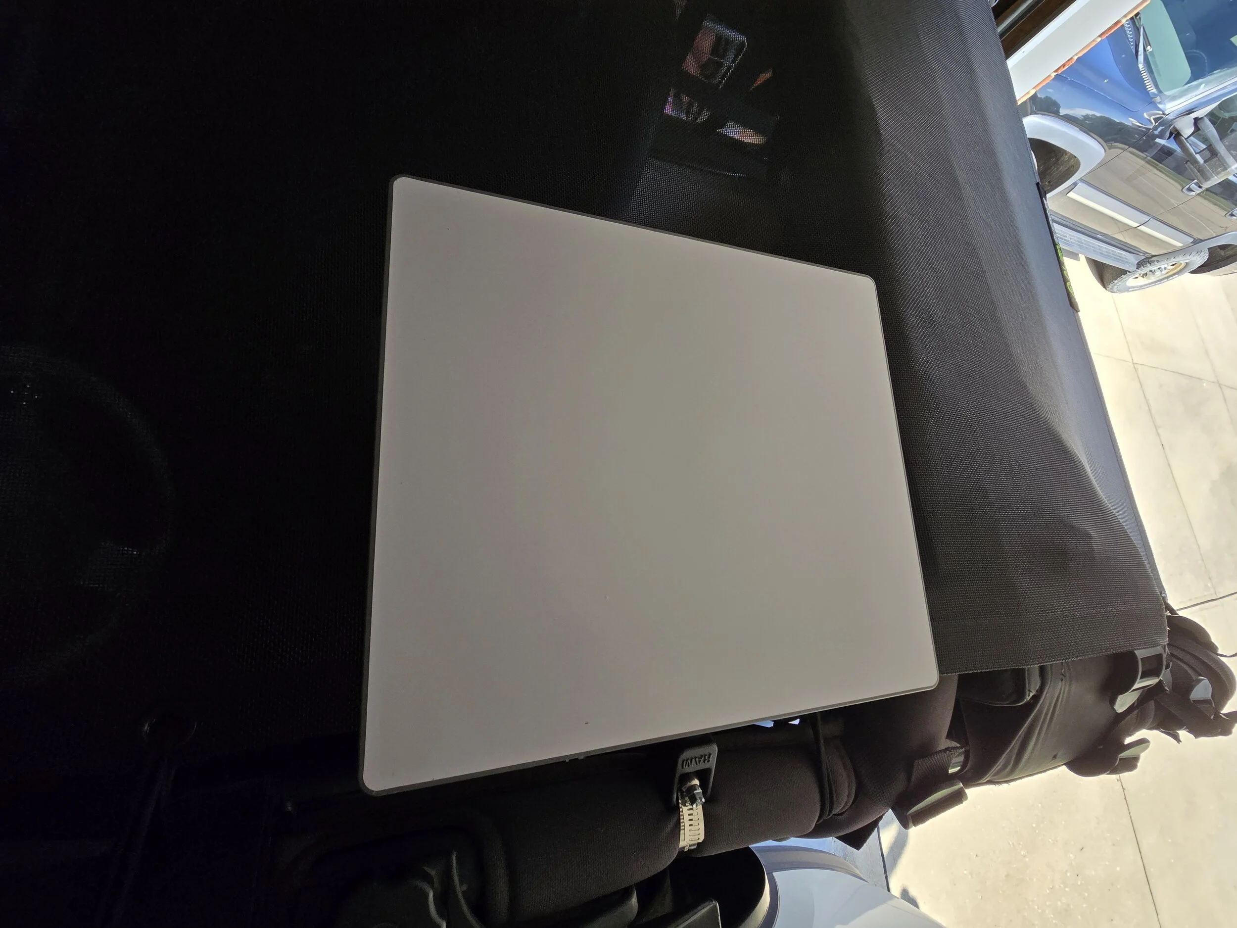

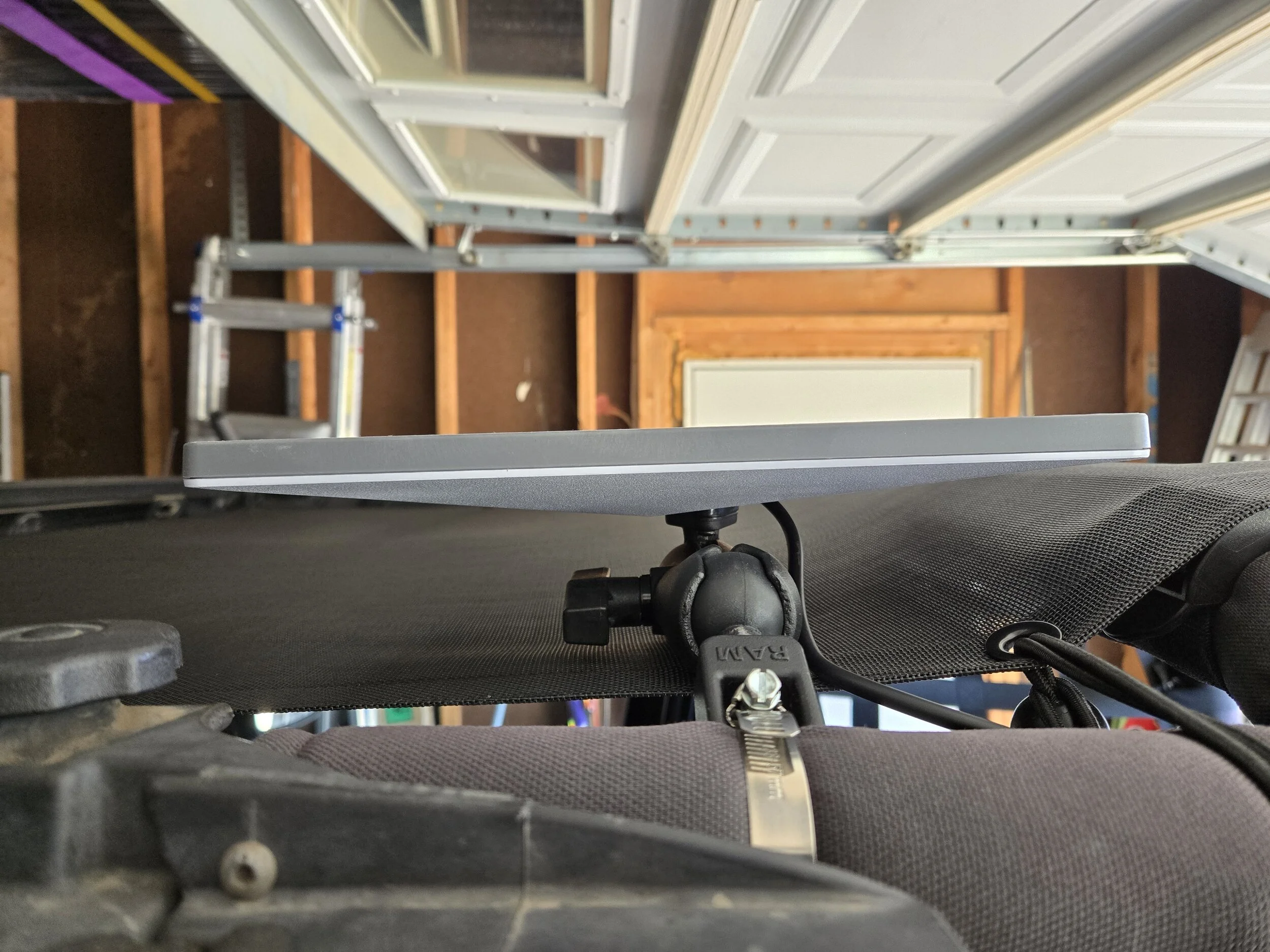

What I ended up with incase anyone else is interested. All below are C sized ordered from RAM Mounts https://rammount.com/
RAM® Strap Hose Clamp Base x 1
https://rammount.com/products/ram-108bu
RAM® Double Socket Arm - C Size Medium x 1
https://rammount.com/products/ram-201u
RAM® Ball Adapter for Starlink Mini x 1
https://rammount.com/products/ram-238-sta1u
