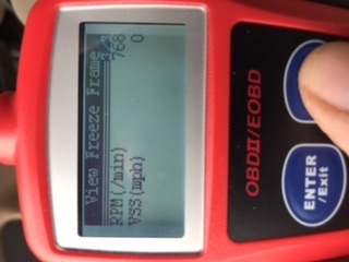

So I was able to get my hands on a buddies ODB2 ready. It was pretty low tech so it wasn’t able to read current engine data but I believe I was able to get the information I needed. The code reader takes a “snapshot” of current engine conditions when a CEL is tripped. So I let the jeep warm up then pulled an injector plug to trip a CEL. This took a snapshot of the temp and other engine info. Here are the results.
I’m now thinking that temperature isn’t an issue. So I’m troubleshooting poor fuel economy

The IR scan shows 187 but it is not in the actual coolant like the engine temperature sensor is. OBD scanner shows 194 so it appears your coolant temperature is ok. Did the outside air temperature drop recently. It has where I live and my last fill up was 1.5 mpg less than the previous tank. It typically runs a bit less mpg during the colder months.
I live in SoCal, although I think it’s freezing out it’s only about 45 at the lowest.
