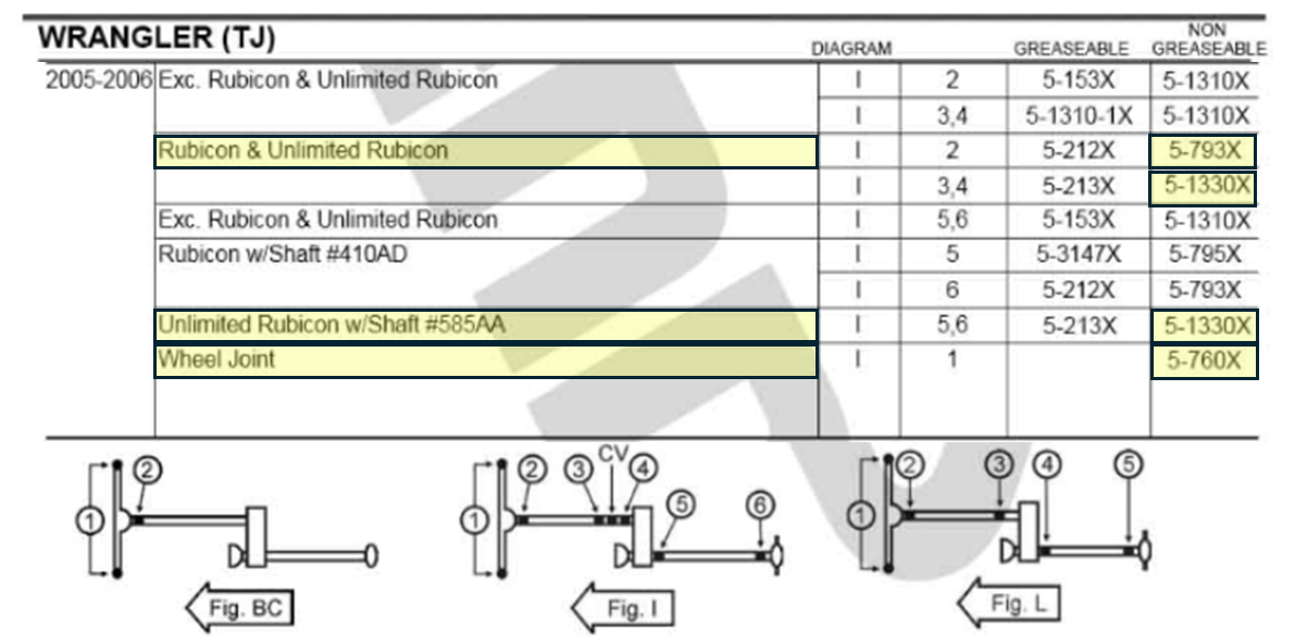

I hate to beat a dead horse here about the spicer u-joints... But I am about to order and replace all my ujoints for my 06 Rubi Unl
It is my understanding is to use the spicer brand for all the joints. Here is what I gathered, and please correct me if I missed something.
I chose the non-greaseable since its my understanding they are also stronger than the greaseable.
(1) Front L/R axle shafts - Spicer 5-760X
(2) Front Drive Shaft connecting to front axle - Spicer 5-793X
(3 -4) Front Drive Shaft connecting to Transfer Case - Spicer 5-1330X (there are 2)
(5) Rear Drive Shaft connecting to Transmission - Spicer 5-1330X
(6) Rear Drive Shaft connecting to rear axle - Spicer 5-1330X
When in doubt call them. The diagram looks to be from Denny's driveshaft? You will also need the cv centering yoke for the front and the rear has a cv socket flange. I rebuilt my rear tom woods in June and the stock front in 2024. front parts are from denny's. Rear is from Tom woods. I did all greaseable but that's my choice and I have a 06 rubi lj also.

Reference...
-Mac
Reactions: LJMolina and JMT
Spicer brand, same place you get the rest of the u-joints. Denny's show 2 for rubi front driveshaft #211179x which is greasable, #211996x is non-greasable..
