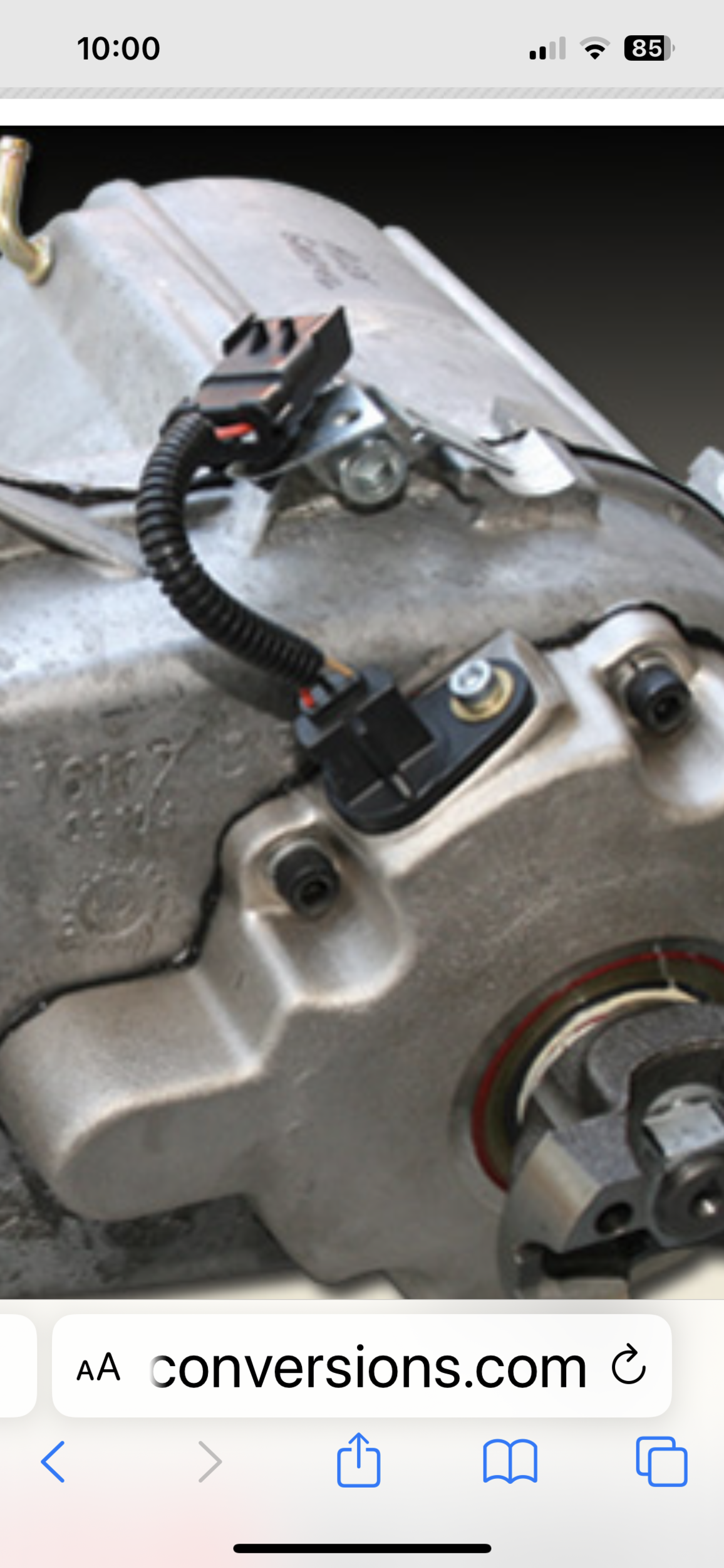

On their website, they have the sensor with the washer under the bolt and over the sensor. Are you saying it shouldn’t be like that?
I’ll need to look. JB responded on a Sunday, said they’d send a reolacement.
They don’t manufacture the sensor, so not on them, and they are a stand up Org for sending a new one. Their SS SYE is super solid, much appreciated.
I tried to find what you’re looking at on their website. I couldn’t find it. Do whatever they say. I just remember having the conversation with him about the washer location on the phone. The purpose of the washer being underneath the sensors was so the sensors depth was not too far in relative to the tone ring, but that was 4 yrs ago.
This is the pic on the back end of the SS SYE on their site. Sorry, I hear you, I’ll follow their directions, but I thought I had etc. if the replacment isn’t the fix I’ll get a pic to them and ask if I’ve got it wrong.
I’m thought that the sensor was installed in the cover when I got it, but I’m not 100%.
The gold part under the bolt head is a sleeve built onto the sensor. you can see it on both sides. Mine also came with a small silver washer that was supposed to be placed between the sensor and the TCase rear housing for positioning the sensor at the proper depth for the tone ring.
On the one in the pic it has a bent tab on the upper edge that may accomplish the same purpose. Mine does not have that bent tab, so ignore what I say if yours does.
