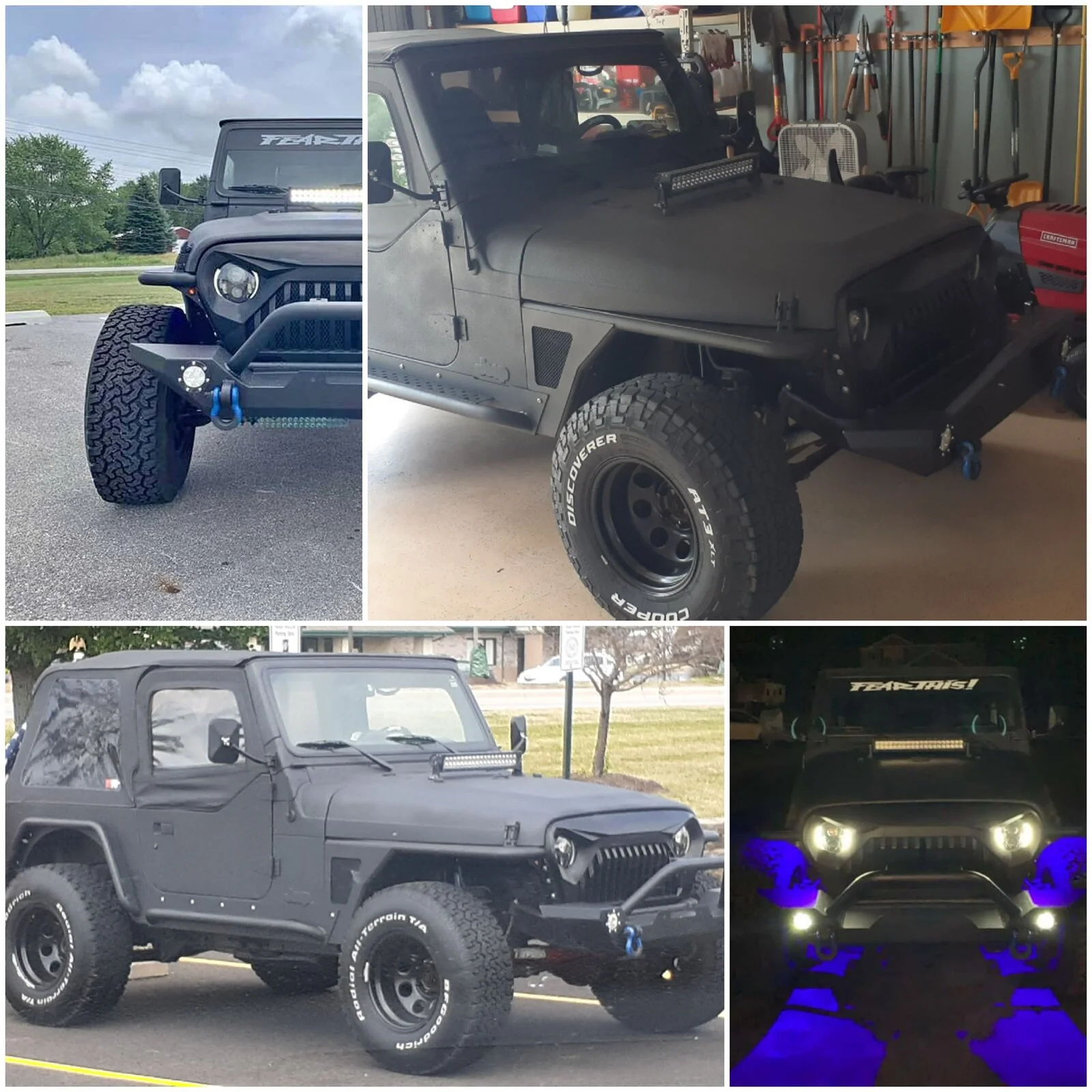

I think your jeep is telling you to get rid of that hideous grill, light bar, underglow and window decal. Nobody wants to be on the front page of The unfortunate TJ of the day thread.

If that's supposed to be a joke, I'm not laughing. I bought the Jeep that way and like it. The "fear this" decal was removed as soon as I bought it. You're actually the first person to ever make a negative comment about how it looks in the 2 years I've owned it.

snorkels and angry grills will get you banned from this forum !!!! :rolleyes:
