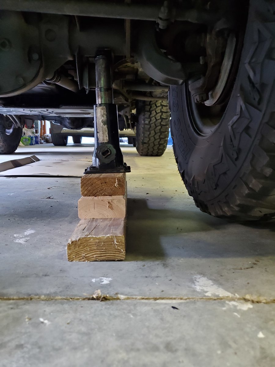

I have the original factory jack (was missing the lug wrench and extensions but got a compatible set). Wanted to check everything out to make sure would work with the 32in tires. Lubricated with WD-40 and checked it out on the bench and it only extends the height of the narrow shaft. I thought that was the full extension so I jacked the jeep with it to see if it would get the tire off the ground. Didn't reach the axle so I added blocking and it worked the outer sleeve engaged but still stopped at the same height. Any suggestions on how to fix that. Seems pretty tight at the stop point, I didn't want to force it too much.
Soak it in motor oil and let it rip with an impact wrench :LOL:

I'm guessing you have some crud build up on the teeth. Using some kind of agent to soften it up is would be a good start (PB blaster maybe).
