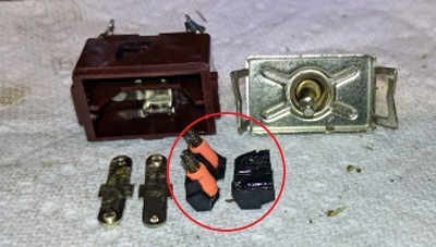

This is the post-mortem... the black plastic part circled in red broke in half. The toggle fits into the middle of that piece & flips the two rocker contacts sitting on the left. Cheaply made for sure.
