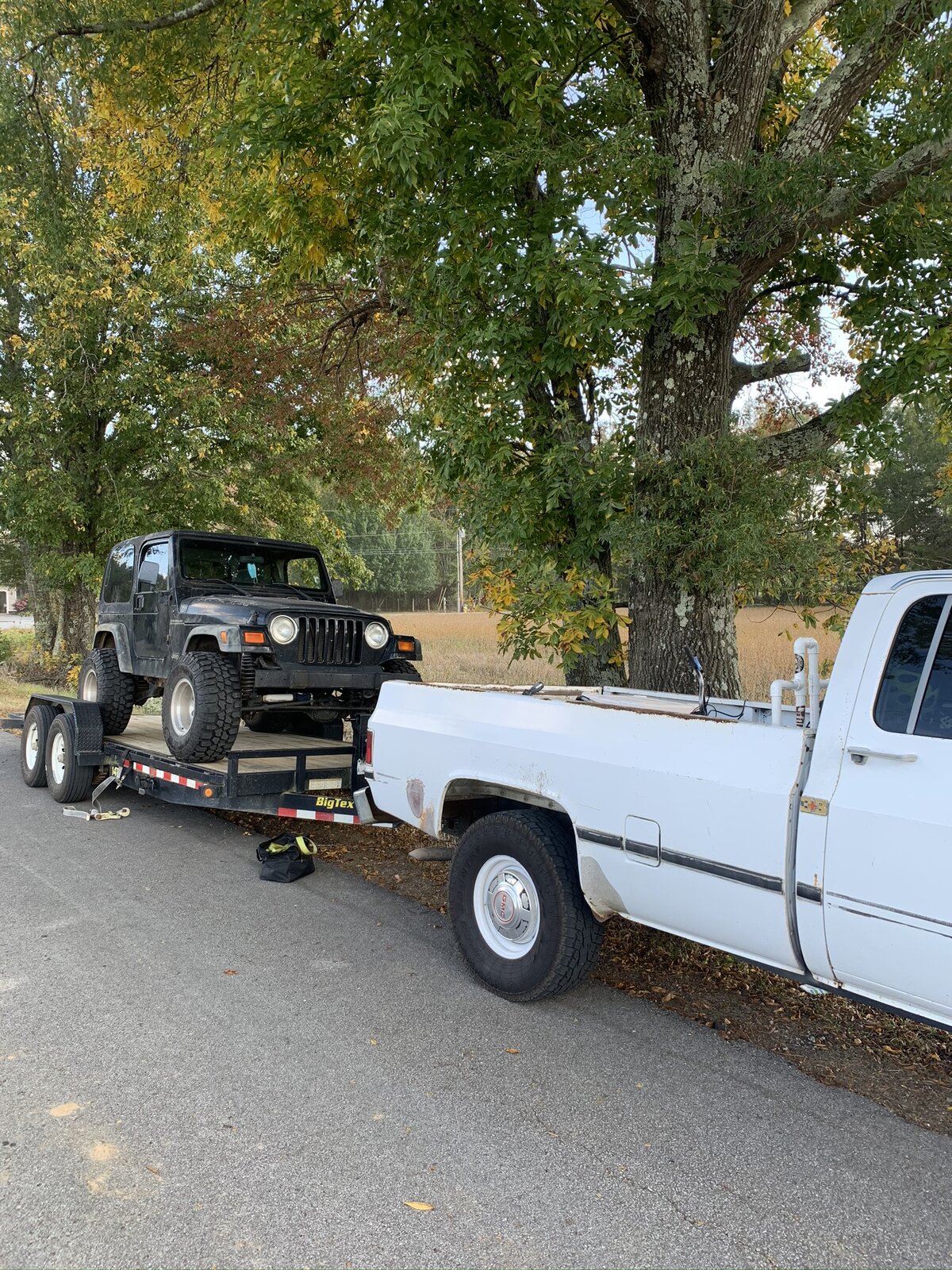

Loaded on the trailer at about 18 mph since the trans was shot. My buddy put her in 2nd and talked dirty to her at about 2k RPMs.

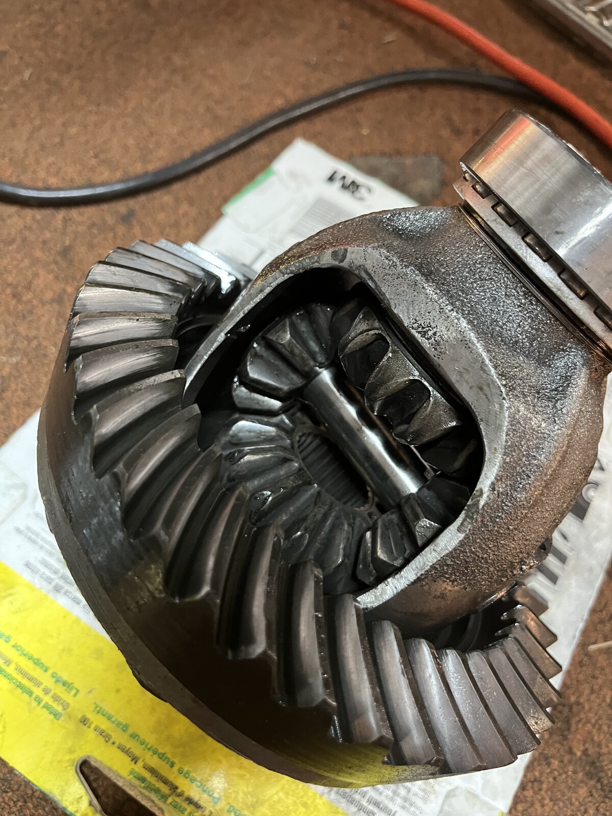

• Diffs drained (looked great, pure luck), lube lockers installed, pinion seals front and rear

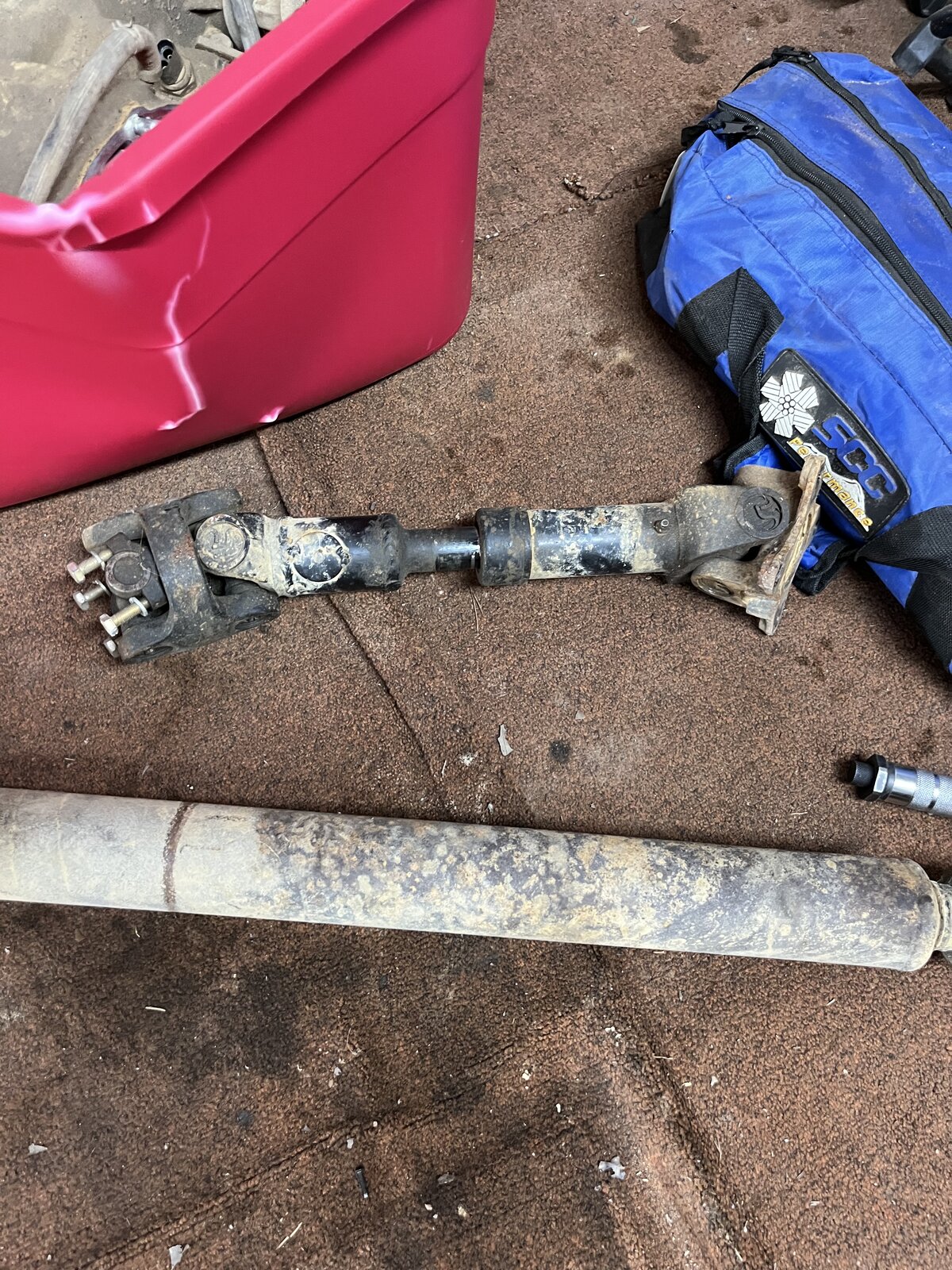

• Couple of u joints on both drive shafts

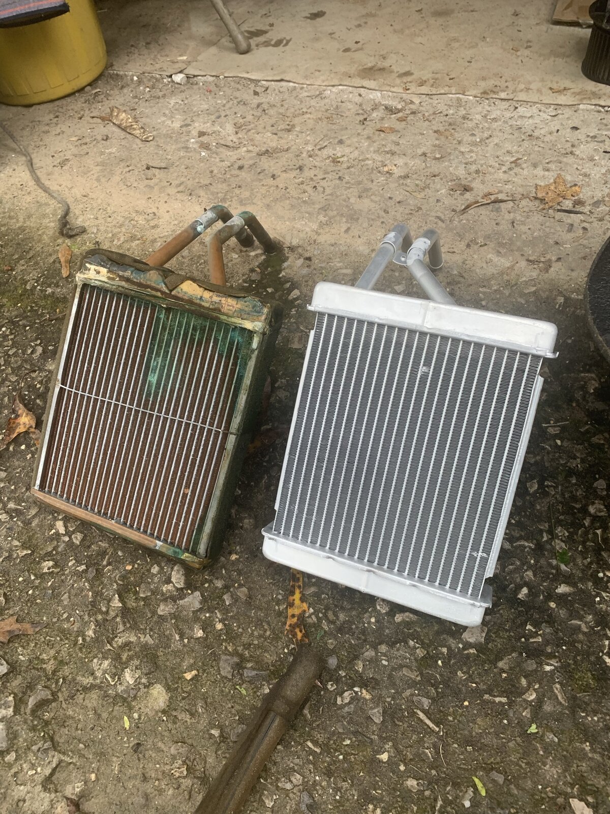

As winter approached, my heat sucked so I parked it and began the dreaded heater core change. Opted for aluminum to avoid doing this again for a long time.

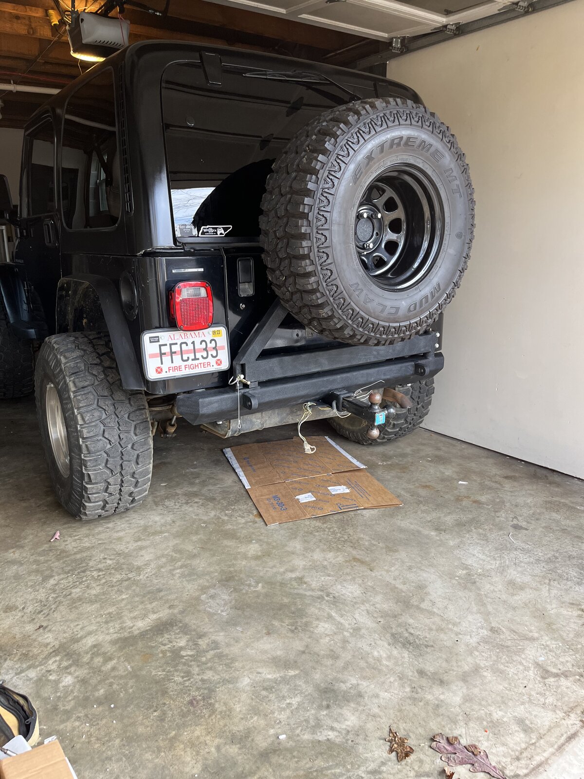

• Rear tire carrier

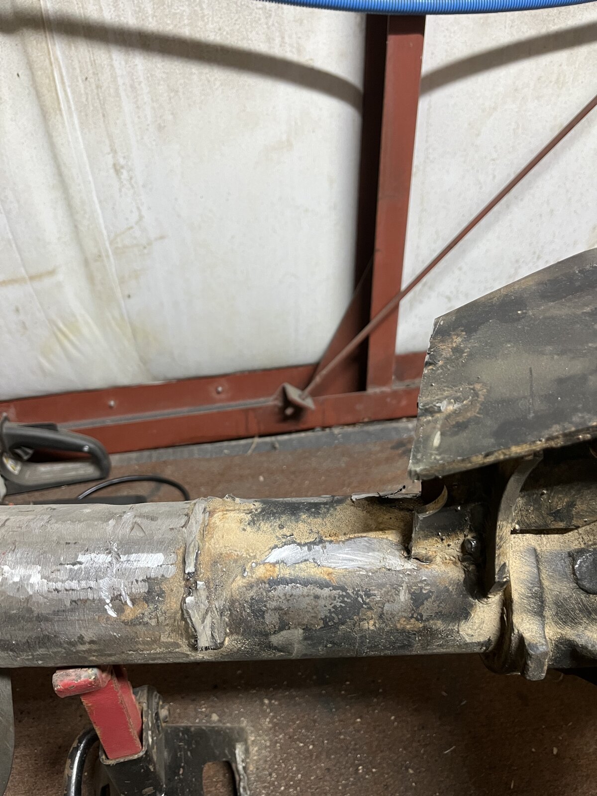

The axle swap project tested my fabrication skills. My goal was to use the factory control arms, trac bar and sway bar. But I had a modular 1/4” truss from a leaf sprung XJ already installed on the 8.8. It became clear that cutting the brackets around the truss was not an option as I couldn’t manipulate the brackets into the space between the two upright axle plates. I chose to remove sections of truss, mount the TJ brackets, fabricate the removed truss sections in order to place them around the new TJ brackets. It worked! Slow and steady.
WHEW! Finally finished. Could not be prouder to have plan A get scratched and plan B come together! This project forced me to think and be patient to stick to the original end goal.

I lucked out with an Alabama, garage kept beaut! She had everything (see above) and she had nothing. Could not even drive it home. But I could fix that.

• Rear tire carrier
