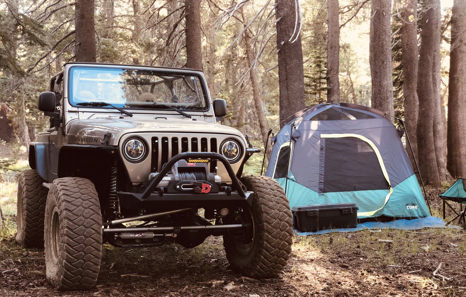

My camp photos. A stock Wrangler, a tent and two chairs ;o)

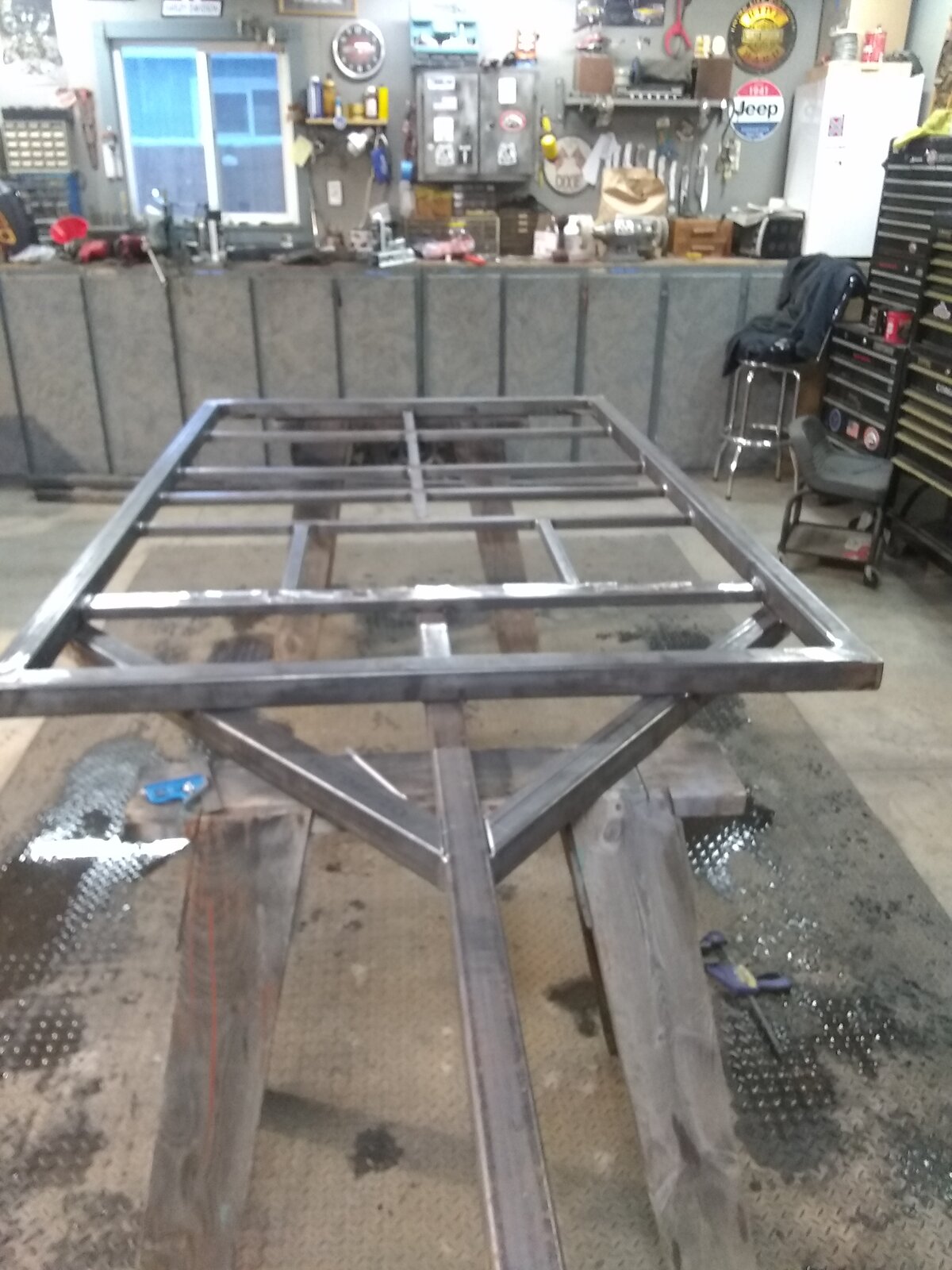

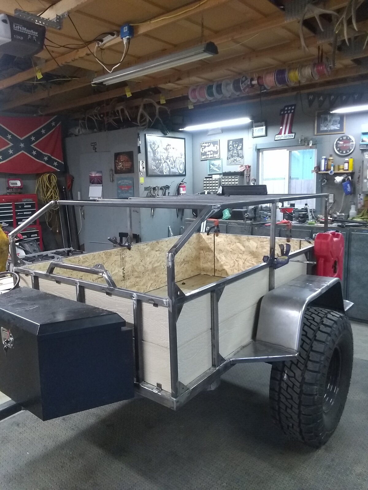

your trailer setup looks interesting. More pics/info?
I built the trailer. Everything got treated with Truck bed coating and then painted. 3500 lb Axle 33x12.50 tires. Cut the fenders in half and added 6". The removable tables work great. Rod Holders on top. Adding Shocks this winter and a RTT. It pulls great and you never know it's there. Trailer is 4'x6'. Leaf springs
