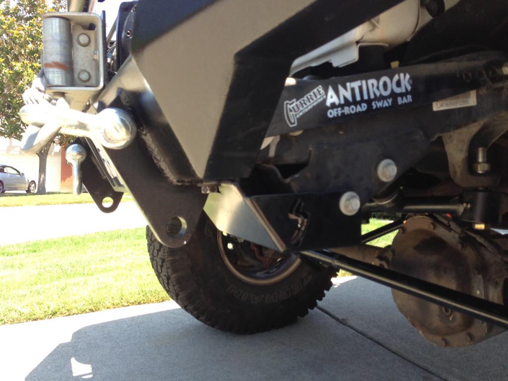

  3. Maybe - for liability purposes, I don't think you'll find any that will publish being rated for towing. If you call the manufacturer directly and ask, they'll usually give you a yes/no verbally. I had a set of tow points custom made that fit over the bumper and bolt into the frame for $100 at a local shop. Also, you don't have to use the bumper; there are brackets that attach on the underside of the frame you can use instead.

The attachment points I had made are welded 3/8 steel and bolt to the frame thru the bumper using the OEM bumper bolt holes (same ones the OEM recovery hooks would mount to). If you zoom in on the 3rd pic, you can get an idea. Here's a better pic that may show better. This way, the force is on the frame and not the bumper, like it would be using the rings with backing plates.

It looks like these brackets tie into the bumper not the frame. I am surprised that I cannot find D-ring/bow shackle brackets that tie to the frame. All I have found so far are on custom bumpers or a large tow point frame that spans across the front frame. I think the brackets DaveC had made may be one of the best options.
