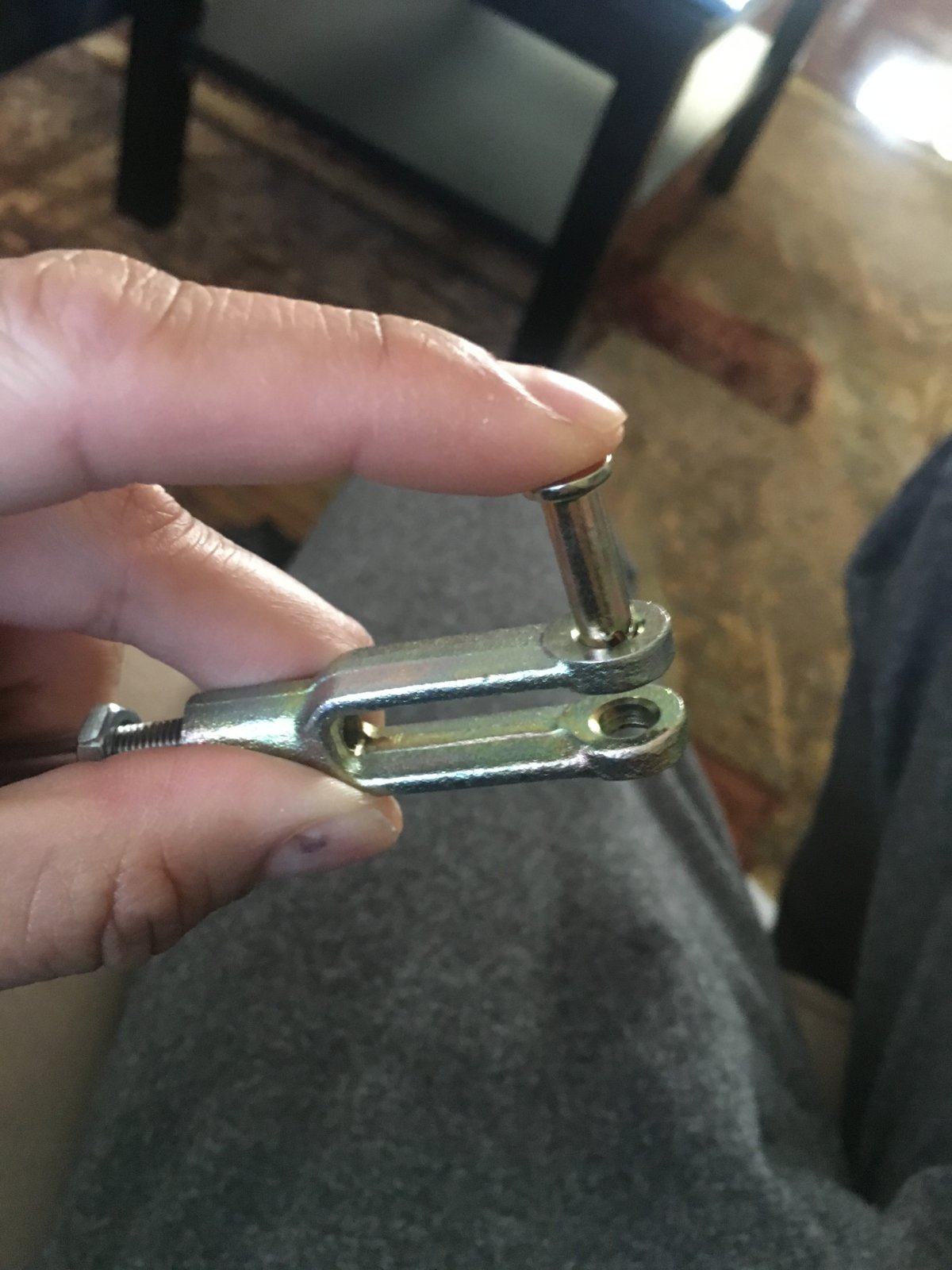

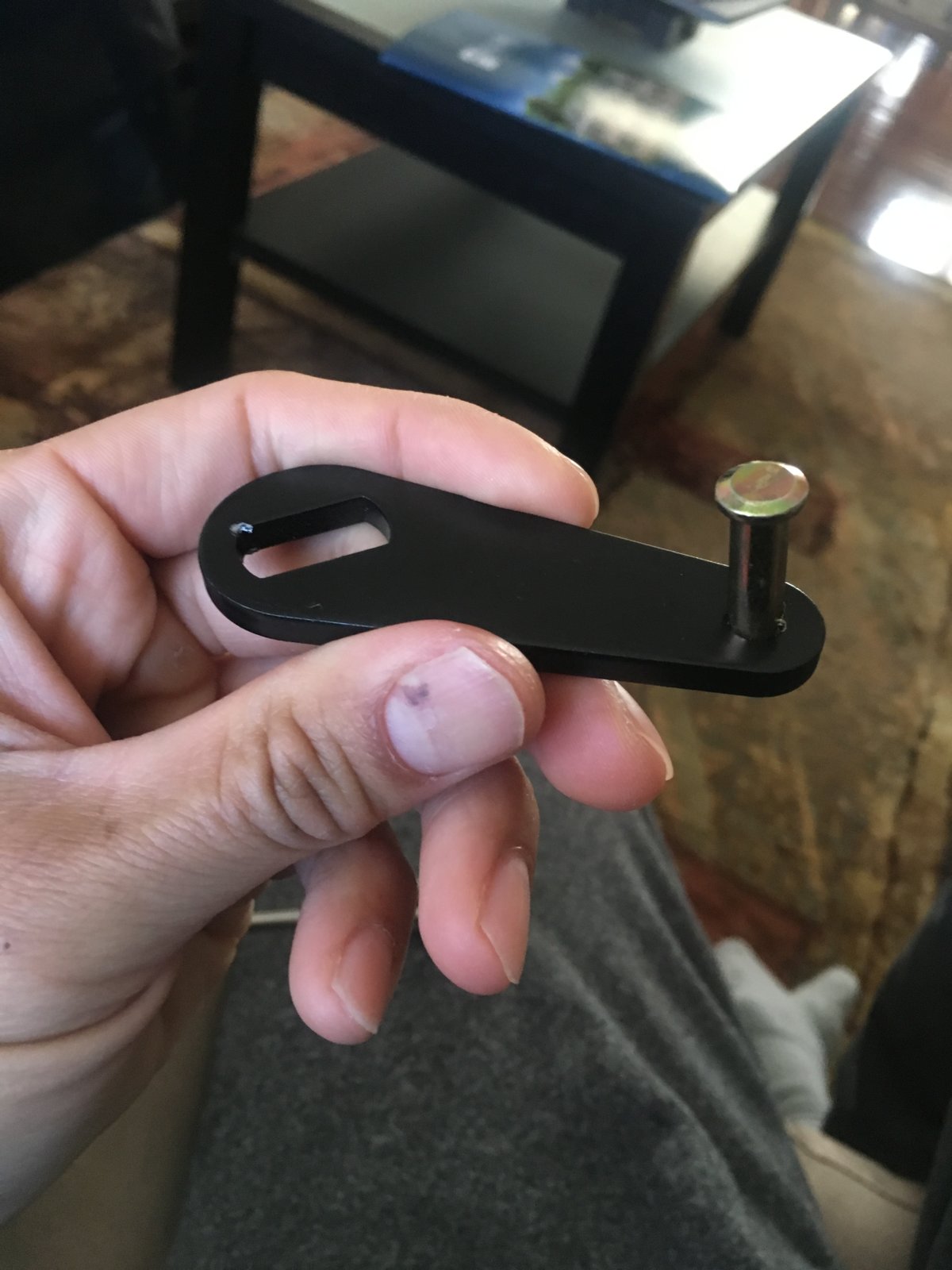

Am I doing something wrong or is the clevis pin too big to fit into the holes of the hardware it’s supposed to go in? Do I have to drill the holes bigger?

I didn’t have any issue with mine so the coatings must be thicker on yours for some reason. I would just ream them out and run with it unless you want send it back an wait.
Hardware company put in the wrong clevis pins. Drill it out slightly clamped in a vise or get in touch and wait for the right ones to show up.

Is it possible to pick up the correct size pin at Home Depot? If not who do I contact for the right hardware?
Mine didn’t have that issue. May be a hardware issue. My hardware was missing one piece. Just email Gerald
What piece were you missing? So I can check to see if I have all the parts.

I know. It’s all good. Just that small clevis pin. Not Savvy’s fault.
I am unaware of Home Depot's stocking inventory so I have no way to answer that question. Contact Savvy. I already sent Michael an email telling him to check the hardware kits.

The Clevis pin. Fortunately I could run 15 miles to town and pick one up at Ace.
Looks like I’ll be checking out my local Ace

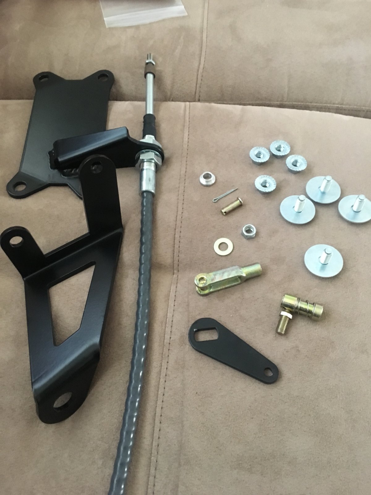

After reading this i had to run and open my hardware kit and check. My fits perfectly. It must be a one off mistake.
I will say this. It takes alot to impress me now a days. I was impressed with the way this kit is built. I was not expecting the plates to be so thick. And the cable so stout. I won't be worried about it failing in my lifetime.
Edit.... still wish they would have provided instructions. Or at least a card with a link to get them ( i have them now thanks to this forum)
