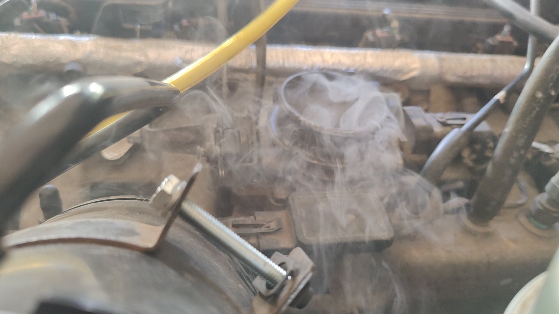

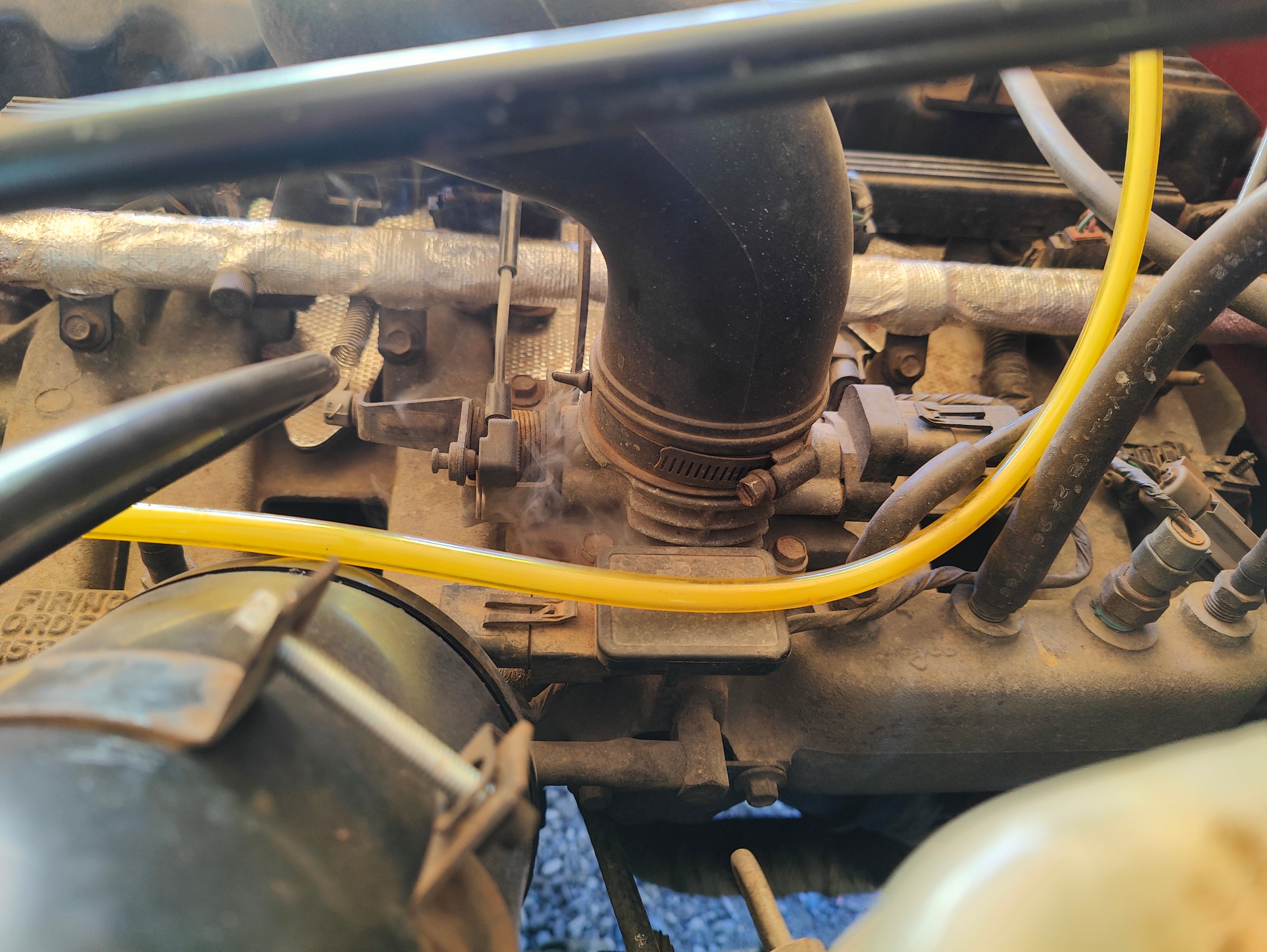

Been fighting a rough idle since I purchased my 06 TJ (4.0L 6MT) and am hoping for suggestions on how to proceed. Jeep has been to two mechanics recently and neither can figure it out. I'm experiencing a moderate shake at idle that smooths out with any throttle. No CELs and runs great when moving. Warm idle hovers around 650rpm. Turning on defroster or A/C also clears it up significantly (I believe due to slightly higher idle RPM). Running voltage hovers around 13.4-13.5V since I do not have the battery temp sensor.
So far I've replaced / checked the following:
- New Spark Plugs (XP985) - Changed twice
- New Coil Rail (Standard Blue Streak)
- Replaced All O2 Sensors (NTK)
- New Fuel Injectors (Precision Auto Injectors) - Changed twice (Fuel trims were originally rich, now normal)
- Added injector and fuel rail heat shielding (DEI)
- New IAC (Mopar)
- New TPS (Mopar)
- New MAP Sensor (Mopar)
- Cleaned Throttle Body
- Checked for vacuum leaks, none found (per both mechanics)
- Replaced entire EVAP system (Mopar)
- Replaced fuel pump (Bosch)
- Replaced battery (Interstate MTX-34)
- Replaced Alternator (Ohio Gen. 330A)
- Replaced idler pulley, tensioner and belt
- Big 7 wiring upgrade (sanded grounds to bare metal
- Checked engine compression (180psi +/- 5psi all 6 cylinders)
- Checked catalytic converter back pressure (no issues, per mechanic)
- Smoke tested exhaust, no leaks found (per mechanic)
I'm sure I missed a couple things, but I feel like I've replaced just about everything that could be the culprit. Any ideas?
