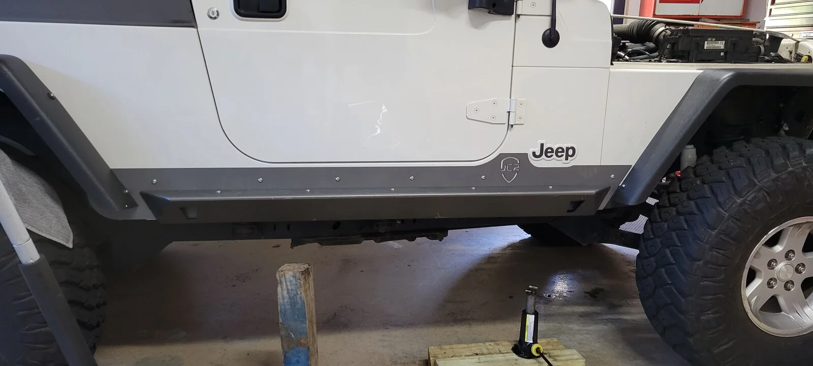

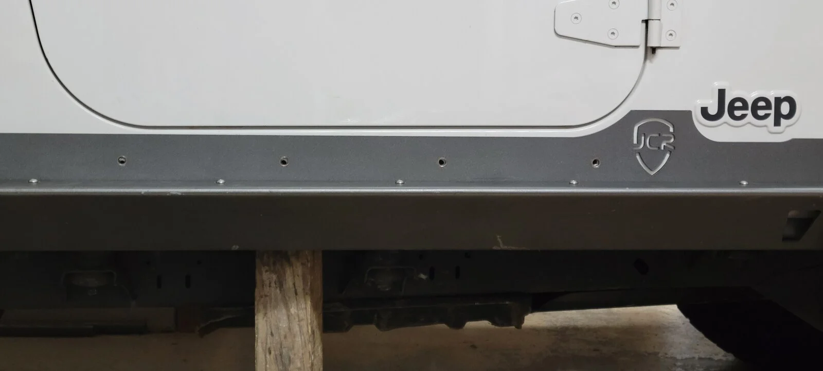

From your original photos the backer plate looks to have an equal reveal between the door opening and top of backer plate. In the latest photo the reveal is wider toward the front versus back.
From JCR's video install
it appears the backer plate is held up in place and drilled. Then the slider is bolted into the clips on backers tabs, followed by "no preloading" and drilling up through the torque box and floor. *Cringe* (Nutserts all the way!)
If you bolt it up using the existing holes and the backer plate is flush across the entire piece without the slider on, does that change only after bolting the slider on?
It may be that one of the tabs on the backer could be welded on a touch high which could pull that area of the backer away from body creating your gap.

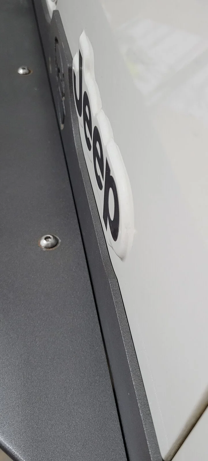

I checked every single tab on the backer plate to check just that. They are all the same measurement and the backing plate is flat not bowed or distorted. It's flush until you bolt up the slider which then preload the backing plate pulling it away from the tub where it has less bolts. The front most bolt.on the fender does very little to keep the backing plate tight against the body. That sheet metal is just too thin.

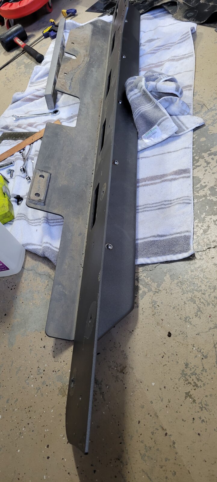

Got them a little tighter but realized the fender isnt the issue. My previous install probably is the issue. The slider is straight not bent, my torque box is not bent with no noticeable deformation and the side of the tub is straight. It almost seems like the spacer pad on the rear of the slider, under the torque box, isn't tall enough.
I got frustrated with it so bolted the slider and backing plate together to fit up to the tub. Replicating a savvy style install as best I could with these sliders. With the plan to make sure everything was flush, flat and redrill holes if I need to. What I found was the slider plate is not level with the bottom of the tub or the bottom of the door when everything is up against the tub and torque box like it should be. It sits higher in the rear but the base plate is perfectly flat to the tub now. What was happening before was the slider was twisting the base plate pulling it away from the tub slightly near the front when you tightened everything up which is not ideal. I plan to mess with it some more this evening with an additional jack. Any input or advice is appreciated from those have done this before. Maybe the lj being the difference here? Some progress anyway and a learning experience.

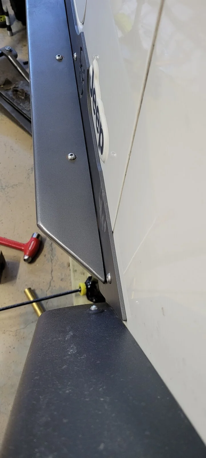

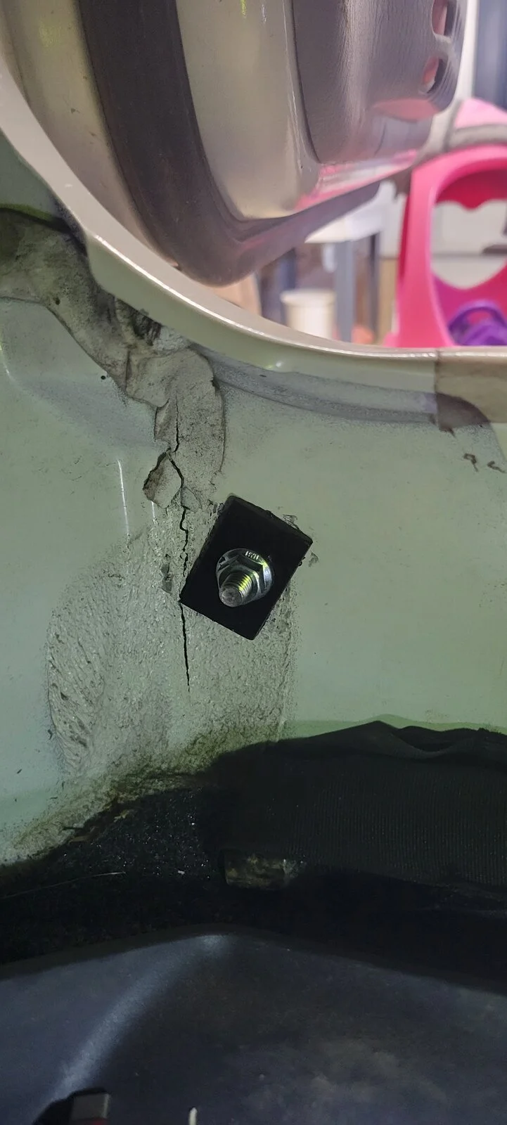

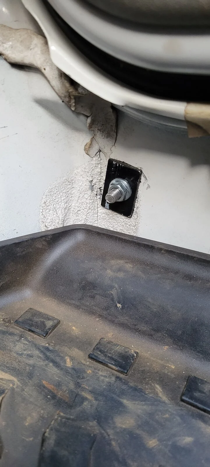

I want to highlight installing a noticeable difference after correcting my passenger side. On the JCR sliders I installed them a bit off which lead to them pulling away from the tub a bit as noted previously. I was jacking the slider up from under near where the bolts run through the torque box. This is roughly how JCR says to install them, backing plate first then the slider after. I needed to open the torque box holes up a but as they were off just slightly after adjusting.
Well I found it worked better by bolting the slider and backing plate together tightly, checking for square, then slide it on the tub. It relieved all the outward tension, can opener effect, to my tub. I wanted to point out my mistake so hopefully it helps other in the future. Not a bad slider but I think their install steps could use some tweaking along with nutserts instead of drilling up through the floor.
Pics below show the difference. It closed up the seam sealer cracking issue I had. I did confirm no spot welds were broken.
Before:
After:
