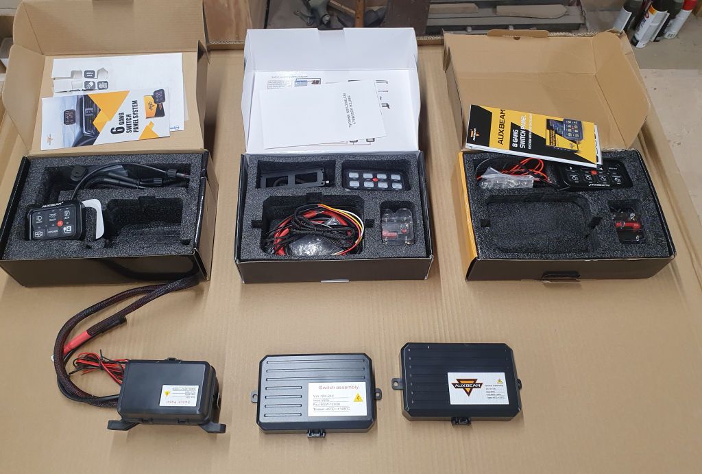

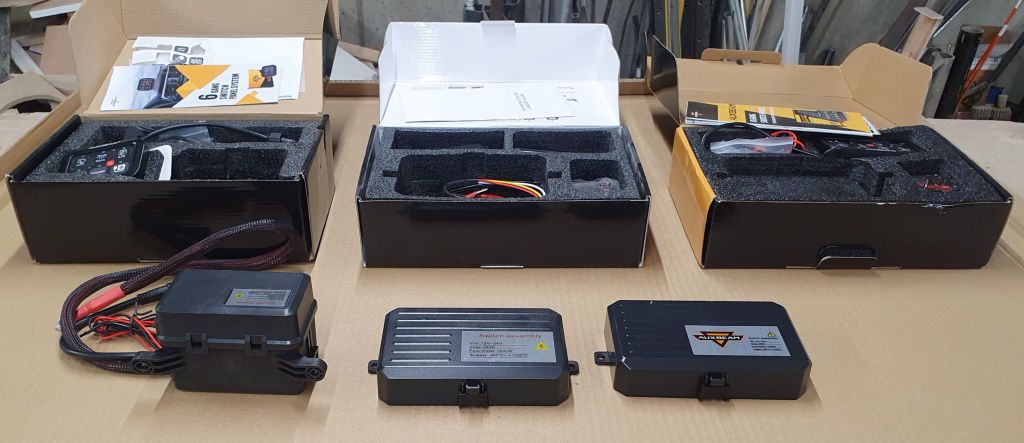

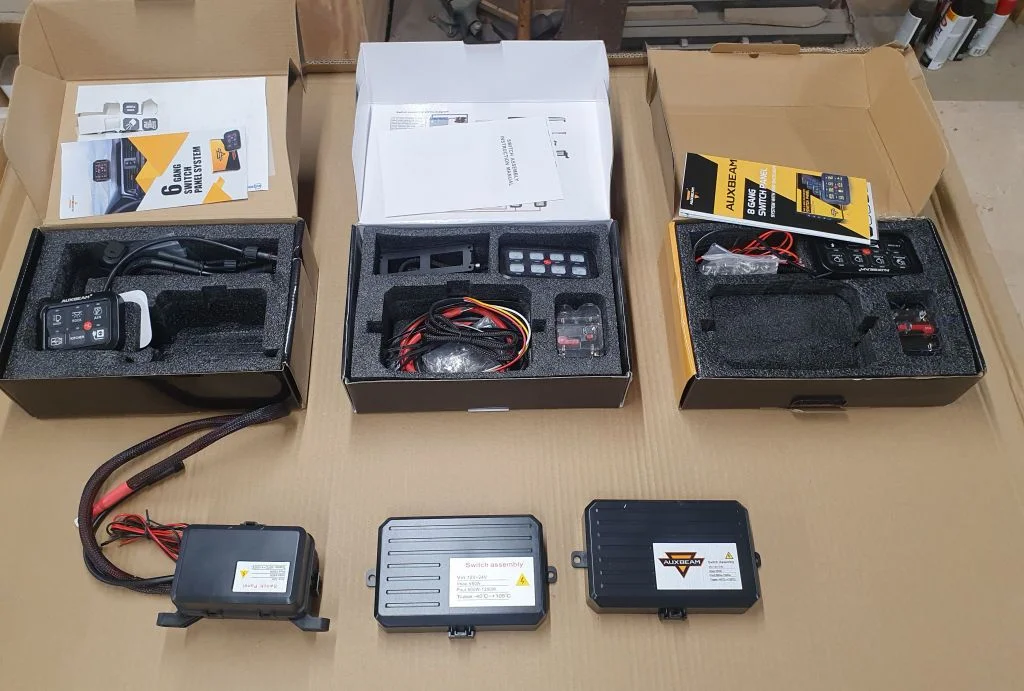

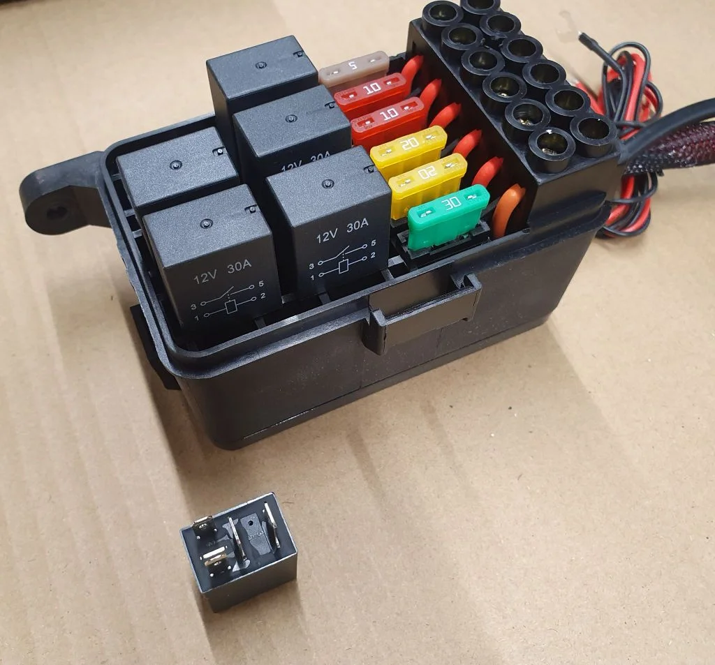

Since Auxbeam has sent me all three kits to review over the past year or two, I've got them all here so I can compare them for you. Left to right, the 6-gang relay unit, the non-BT 8-gang solid state unit and the 8-gang Bluetooth solid state unit.
The relay box in the 6-gang kit is smaller in two dimensions than the 8-gang boxes, but it is taller. When I did that review (https://wranglertjforum.com/threads/auxbeam-6-gang-on-off-control-switch-panel-kit-review.53068/), I found a very easy place to mount it in the TJ - I mounted in on the grille brace rod. I used 1/4" insulated wire clamps to go around the rod, and bolts through the clamps and the mounting lugs of the relay box. The rubber of the clamp grips the rod very well when the bolts are tightened. I angled the box down about 45 degrees; if it is mounted horizontally if will stick up far enough to interfere with the closing of the hood.
The six-gang unit *does not* use Bosch-style relays, they are smaller 4-pin relays. Replacements are available, at the time I did the review and I found compatible relays on eBay.

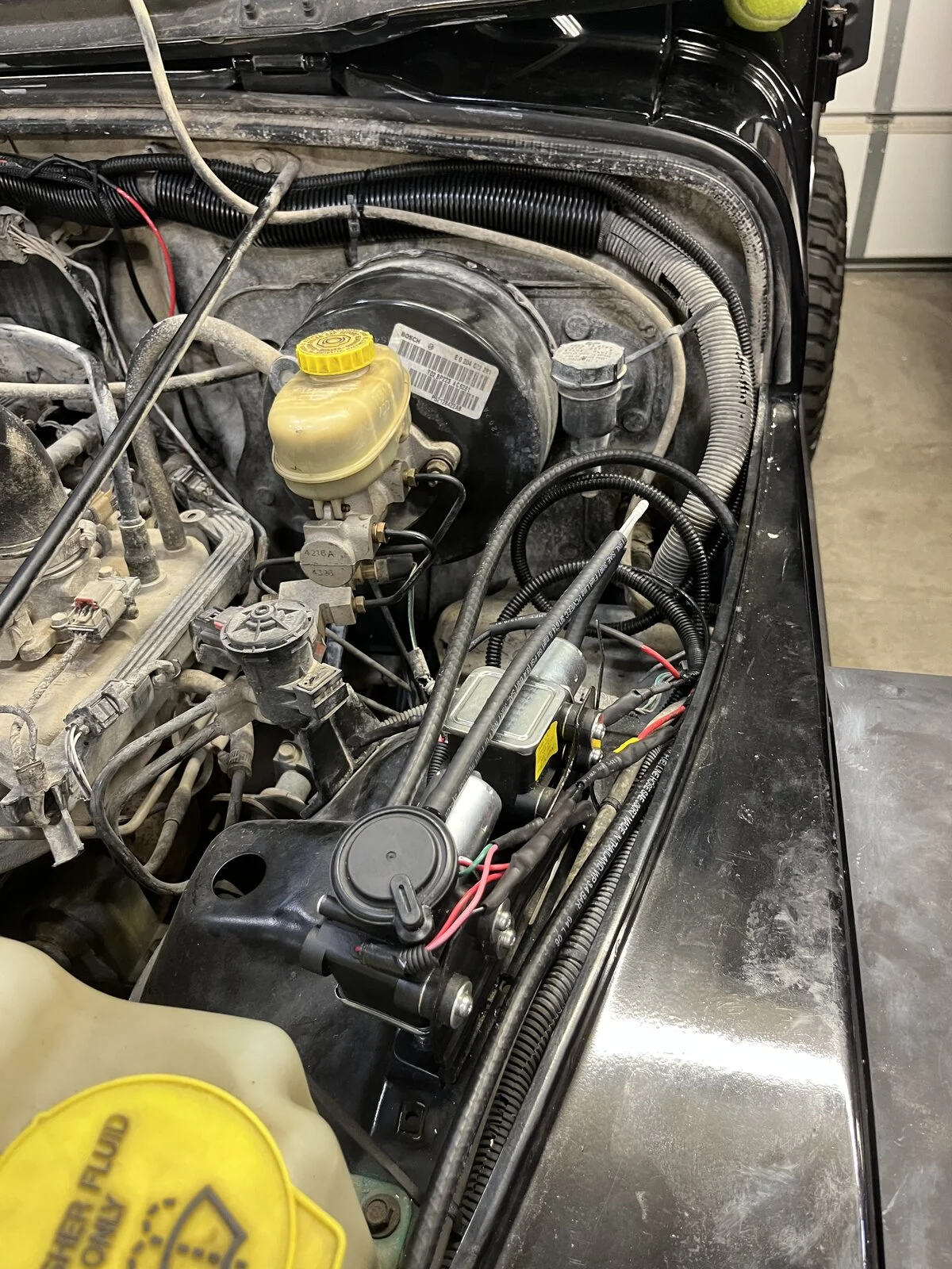

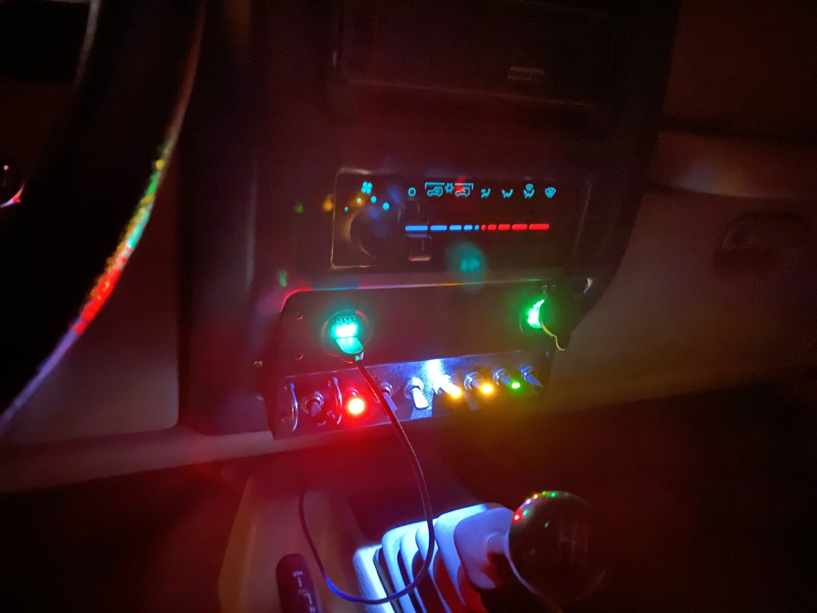

Another thank you to @jscherb for PIF'ng the Auxbeam kit. With it finally installed and a month or two of getting to use it, I have posted a review of it here. I find it exceeds my exceptions in every way other than not having an OE look. I also gently compare it to the NiRider 6 Gang Switch Panel and the DIY Duel Switch Panel mod.
So the previous owner had 3 sets of lights, KC Halogen and I liken that look Vs the LED Cubes/Bars etc that is what I have on my son’s 08 JK.
But the switches were all 3 different that the PO out in, kind of cheap, and now I need room for 2 more for lockers, and I have Rick lights and want reverse spots on my bumper. So that would be 7 total. (Lots of lights on the ranch doing Deer Surverys are helpful)
I went with this to try, and so far was a pretty nice setup.

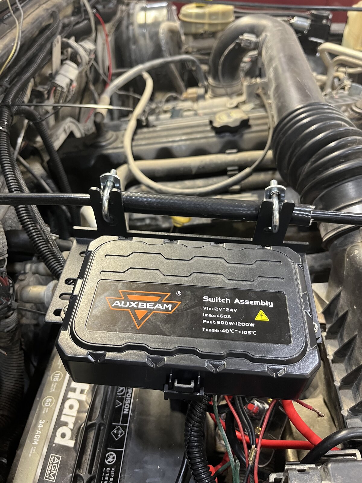

I put the main box above the battery which is going to be a PITA when I have to work on battery, but oh well.
I wired up both lockers using the bracket they are on to the drivers side. (I added wire loom on these wires after the picture.
And everything worked well….but OF COURSE…one spot doesn’t come on all of the sudden. I can’t do a project that just finishes, I 100% of the time have 1 small issue. A new bulb is on the way, ha.
I also added the separate headlight upgrade wiring and Quadratec Hella 130/90w bulbs for the headlight.
One complaint, to Mount the controller above the rear view mirror I have to order an extension cable for it, not huge, but of course that’s not coming until this weekend.
Either way, the wiring, setup, everything is easy.
The BT app, is wholly unnecessary unless you want to change things etc from standard setup. It’s easier to use the app than toggle through etc, so it’s a “nice to have “ feature, not really needed per se.

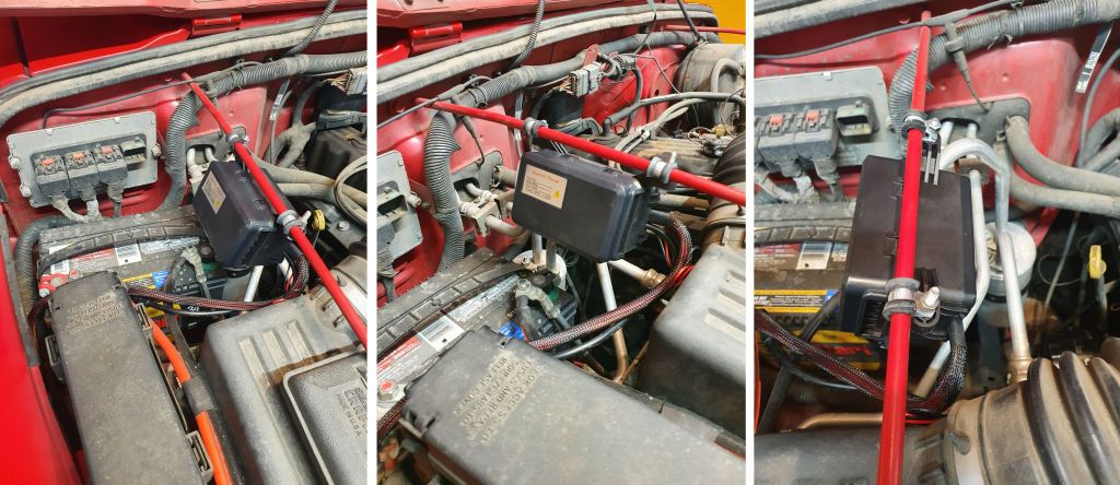

I used the same location for the control box but hung it vertically
Keep and eye on it. Vibrations could cause it to creep in which case it will drop down on top of your battery. That could be problematic
