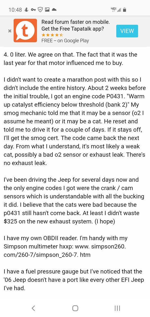

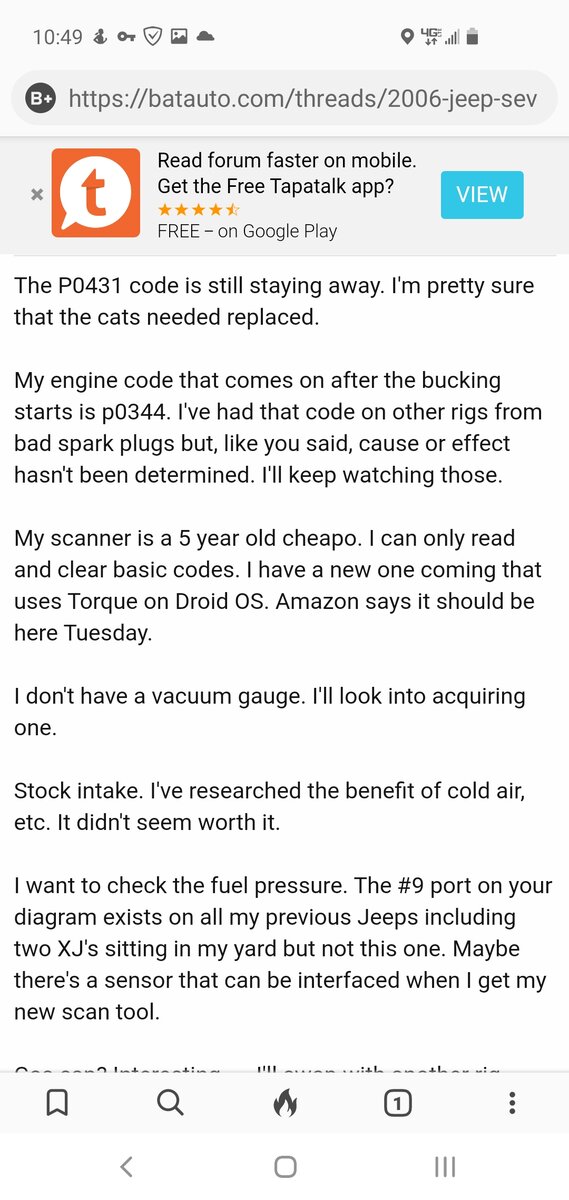

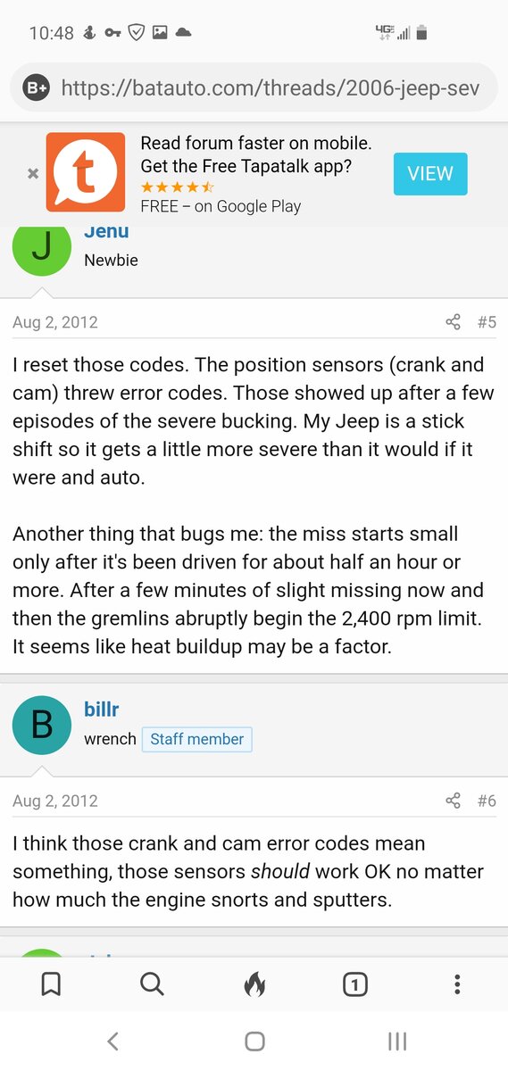

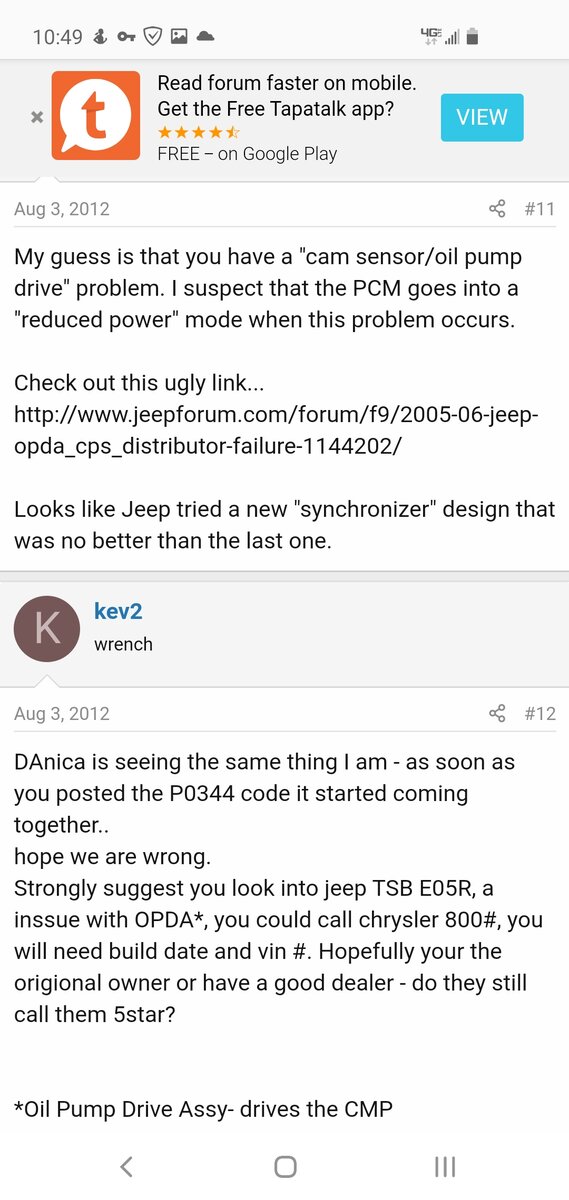

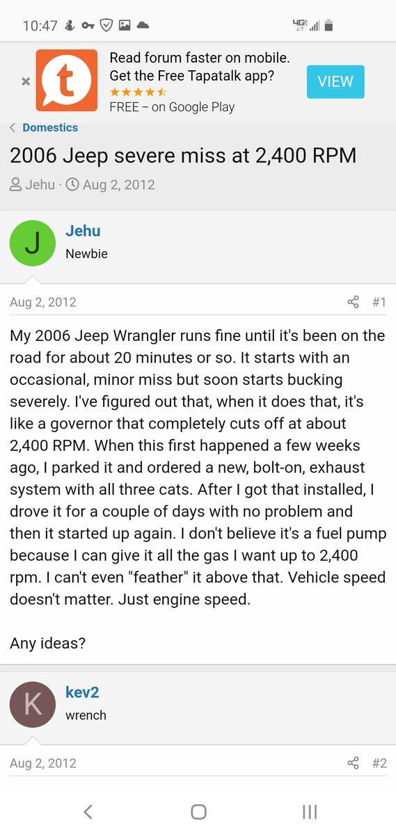

I haven't been on JeepForum in quite a while, so I cannot remember for sure if anyone was experiencing the same symptoms as me, but I did come across this last night. He describes the same thing mine is doing. Although, they did go off in left field with diagnosing the symptoms to begin with, until someone finally introduced him to the infamous conundrum.
