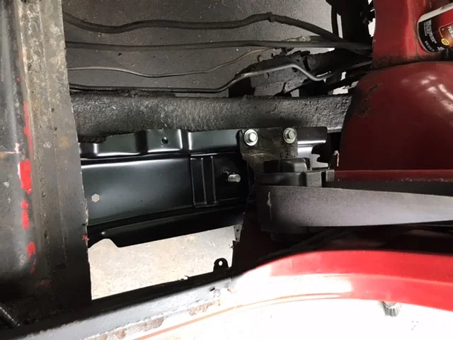

10 hrs today (23 hrs running time) - Removed and replaced driver’s side body mount in front of roll bar. Removed left front fender, cut out remaining pieces of torque box on driver’s side. Test fit torque box for alignment to body mounts. Fit replacement new, driver’s side front & rear floor pans All lines up well. Need to remove a few more small pieces of torque box flange & clean up paint to bare metal and weld torque box & then floor pans View attachment 188972in.
How did you remove the previous torque box? How did you seperate the body from the frame enough to be able to weld the new torque box in place? Did you remove the spot welds or just air hammer the gap?

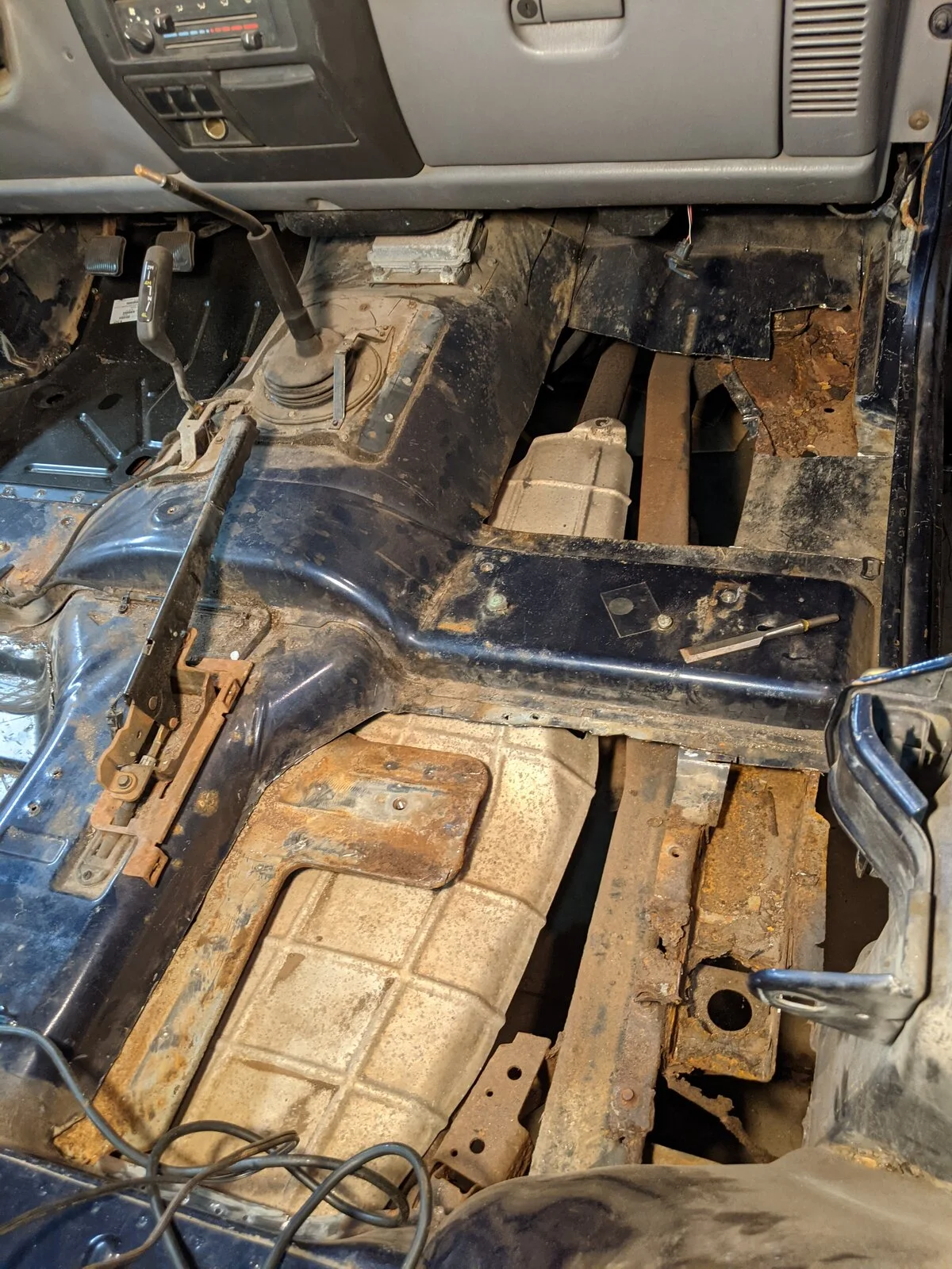

My rocker plates, torque boxes and 4 floor pans are rotted out, and have been making work on the project for couple months now. Pans are removed and am working on removing the existing torque boxes. Any recommendations on removal methods? Up until finding this forum I've been flying blind, but was able to find a guide to the locations of the spot welds, I just cant seem to find them on the jeep. Essentially I just have the top ribbons and front left of drivers side left. Having difficulty finding a grinder able to reach the area.

They are probably too rusty to see from the bottom. What about from the top, underneath the carpet? I recently replaced the rear body panel on my car that was in an accident. I used a spot weld cutter from Napa and it worked well. Dry-run for TJ repairs! My plan for the Jeep is to cut out as many spot welds from the top (inside tub) as possible. This should make welding the new torque boxes in from the top easier but it might not matter if the floorpans all have to be replaced anyways. Drilling the spot welds out in the existing panels saves you time in having to drill holes in the new panels to weld through. Either way, you will want to drill holes in one side of the repair, either new or old, to do the plug welds. Look for videos of collision repair on youtube. The method is pretty much the same as what we are dealing with.

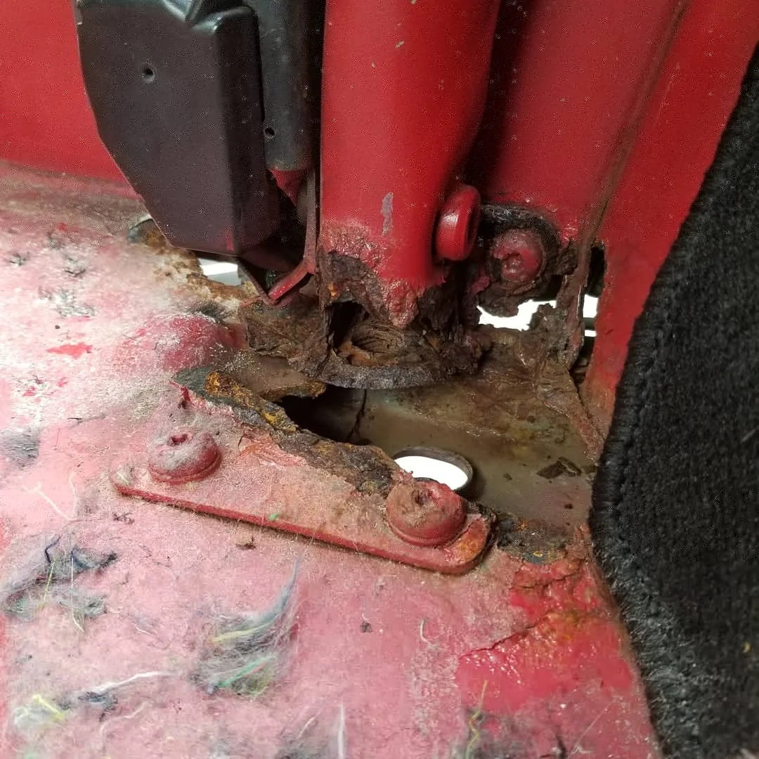

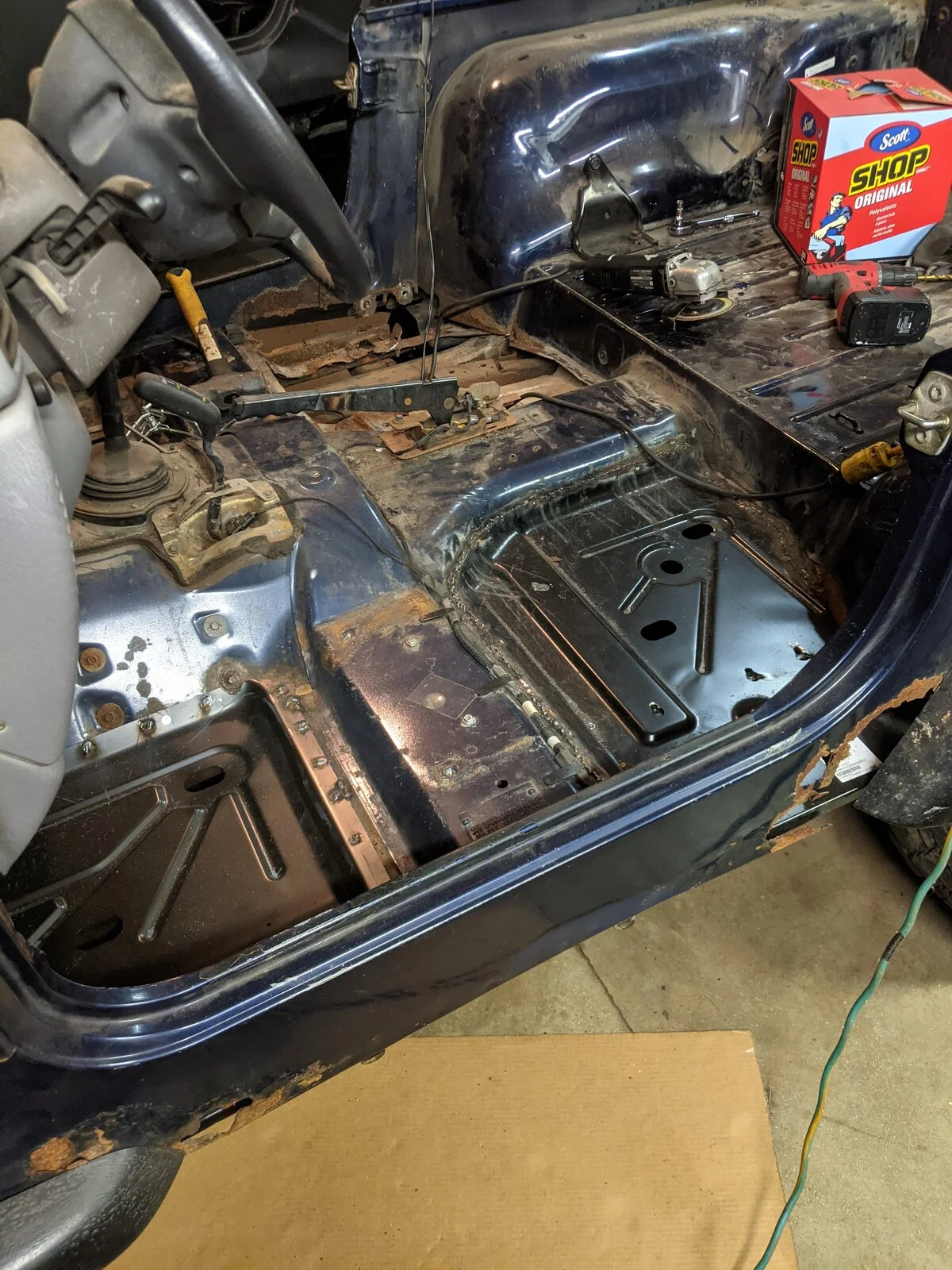

Finished up on one side. I ended up prying the metal to find the spot welds. The spot weld cutter work well until I lost it, the replacement broke nearly immediately. I had success using drill bits and upping the size until the weld was removed. Welds aren't pretty, but also my first job. Rear I welded the perimeter, front I predrilled and spot welded as suggested above. Just gotta wait until it isn't 100 degrees outside to hit the other side.
Reactions: matkal
View attachment 270121Finished up on one side. I ended up prying the metal to find the spot welds. The spot weld cutter work well until I lost it, the replacement broke nearly immediately. I had success using drill bits and upping the size until the weld was removed. Welds aren't pretty, but also my first job. Rear I welded the perimeter, front I predrilled and spot welded as suggested above. Just gotta wait until it isn't 100 degrees outside to hit the other side.
Damn, you have some rocker panel work to do too. Looking good. Get yourself some seam sealer to go around the perimeter for the front floorplan if you haven’t already. Thanks for posting the pics.
I know it. Roll bar needs a new driverside connection plate too. I also broke 8/10 body bolts in some way. Rear passenger is free spinning, so I anticipate cutting into the corner panel to hold the sheared nut in place.

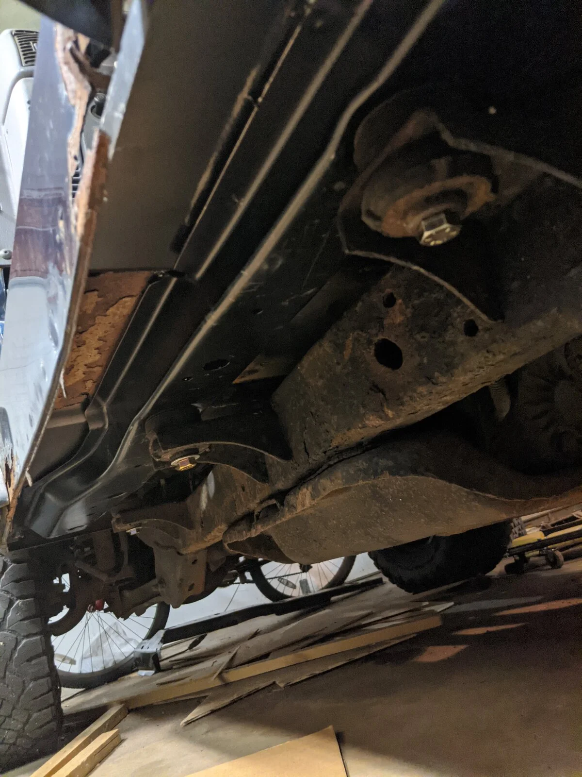

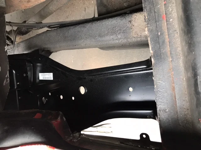

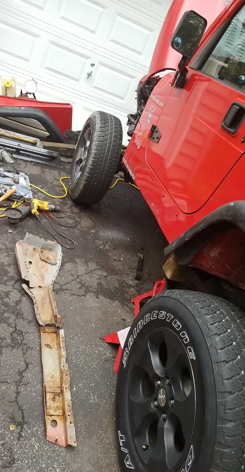

First time posting but long time reader. I did mine early last summer and it took a good bit of time for a 21 year old kid who bought a harbor freight welder for 100 bucks. My jeep is a 97 4cyl and mine torque boxes were rusted just at the point of the body mount but also the corner of the tub where the cage ties to. I just cut some sheet metal to cover the tub spot but for the torque box I just went through every tack weld and drilled it out. Then used those holes in the tub to buttom weld the new torque box right in the same place. All I used was a basic. Set of sockets, floor jack, drill, angle grinder, and a welder. Was well worth my time but it did suck. I'll include my photos as that often helps me visually.

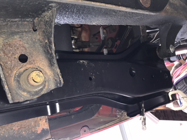

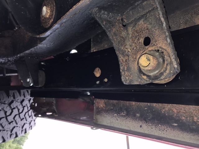

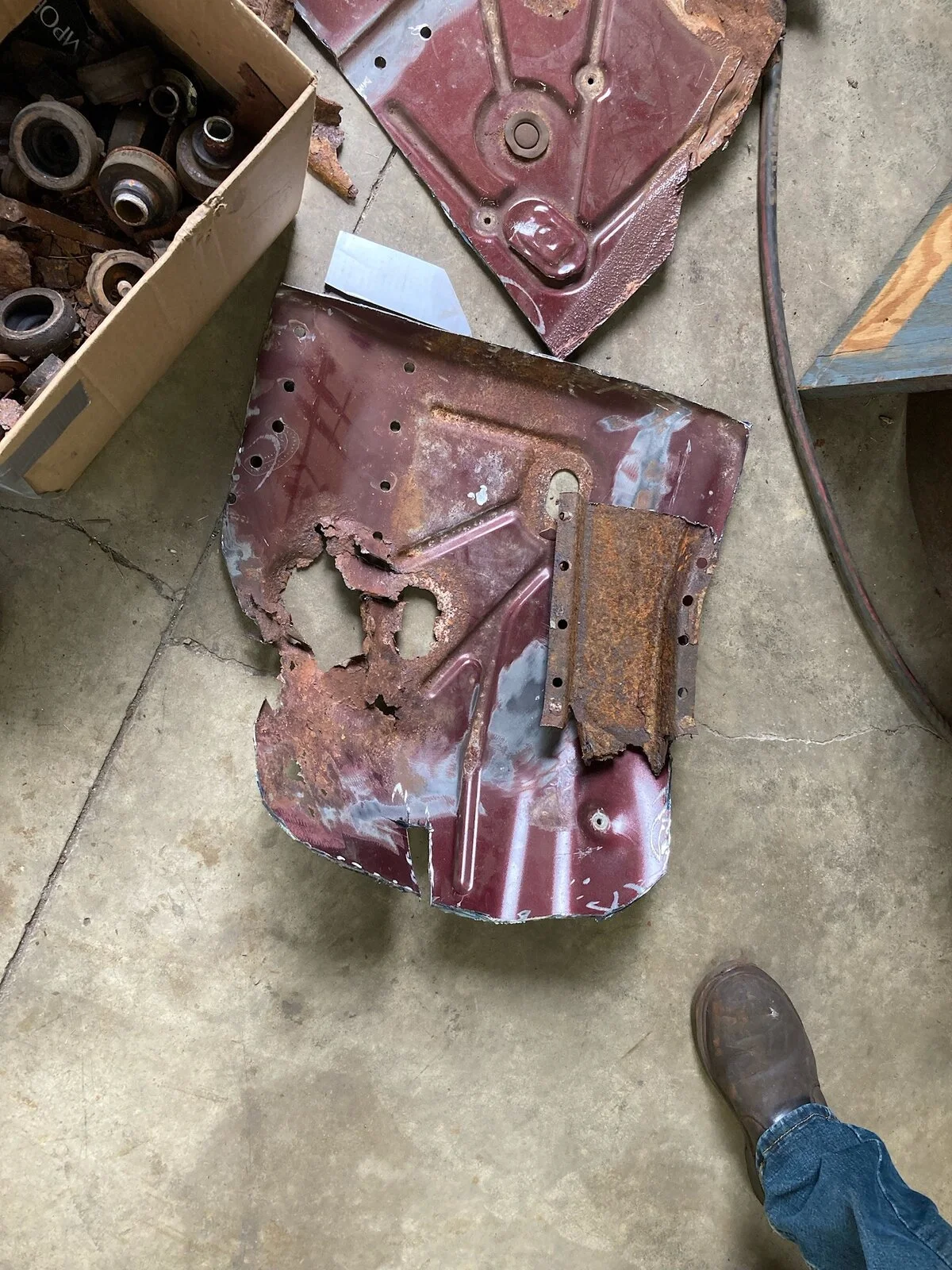

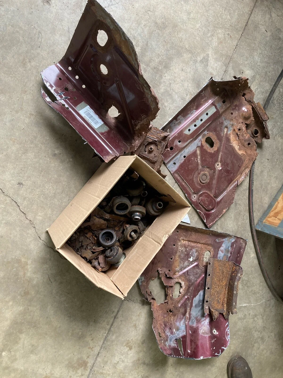

The Jeep is home. Here is what the floor and boxes looked like.
