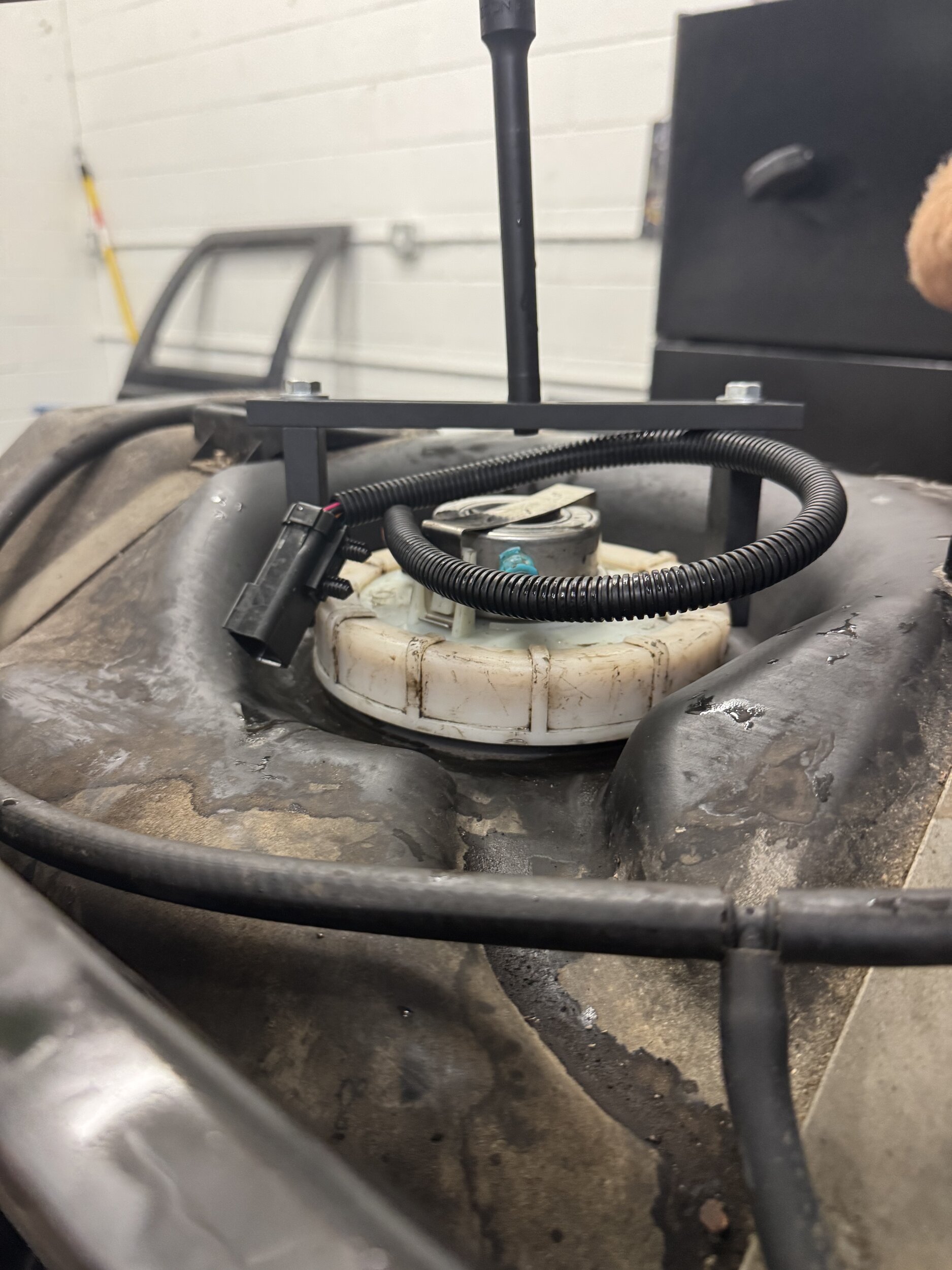

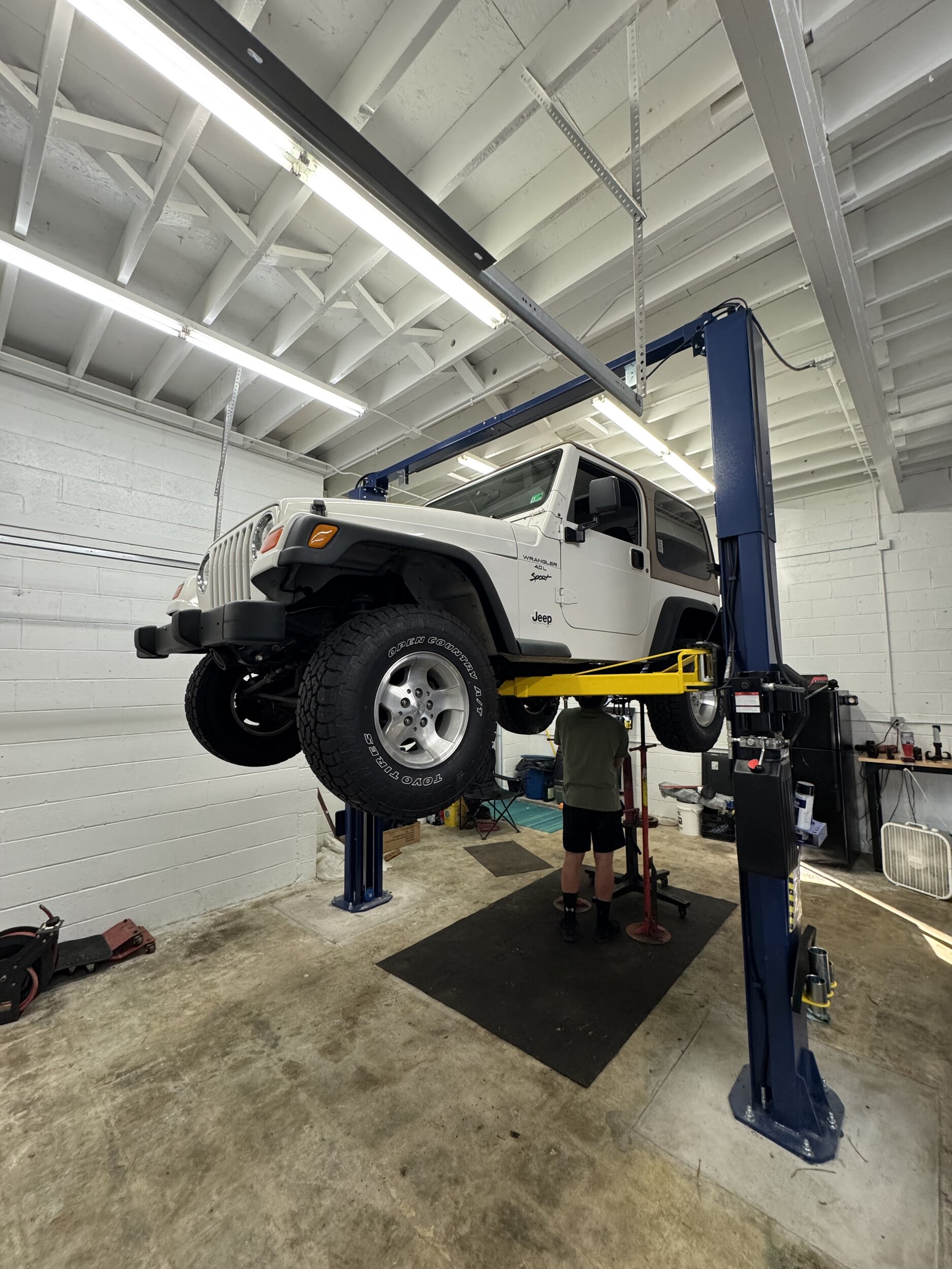

Dropped the fuel tank this evening and replaced with a Delphi fuel pump assembly. Pretty easy except the damn locking ring around the pump on the tank that thing is a biatch to get back seated correctly. Just had to man handle it and finally got it. Acceleration feels smooth and almost maybe more power. Starts up on first crank now which was the goal! Figured I’d share.
My brother and I dropped the tank on his '11 to replace the fuel pump due to periodic stalling.

Did you buy that locking ring removal tool or did you fabricate it ?
Yeah I bought the tool. I’m pretty confident my problem is the check valve but I’ll inspect the old pump and save it just in case. Hoping this Delphi lasts me awhile.
