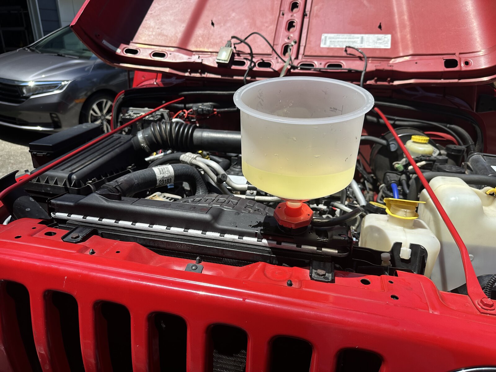

Early summer update:

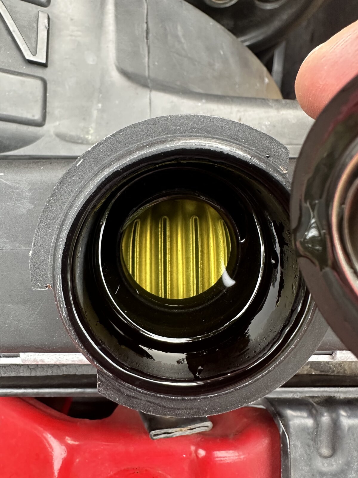

  • Second ThermoCure flush and coolant change, this time drained the block and put in new hoses (should have done that the first time) one day I'll learn not to take shortcuts/rush on this thing
  • New driving/rock lights

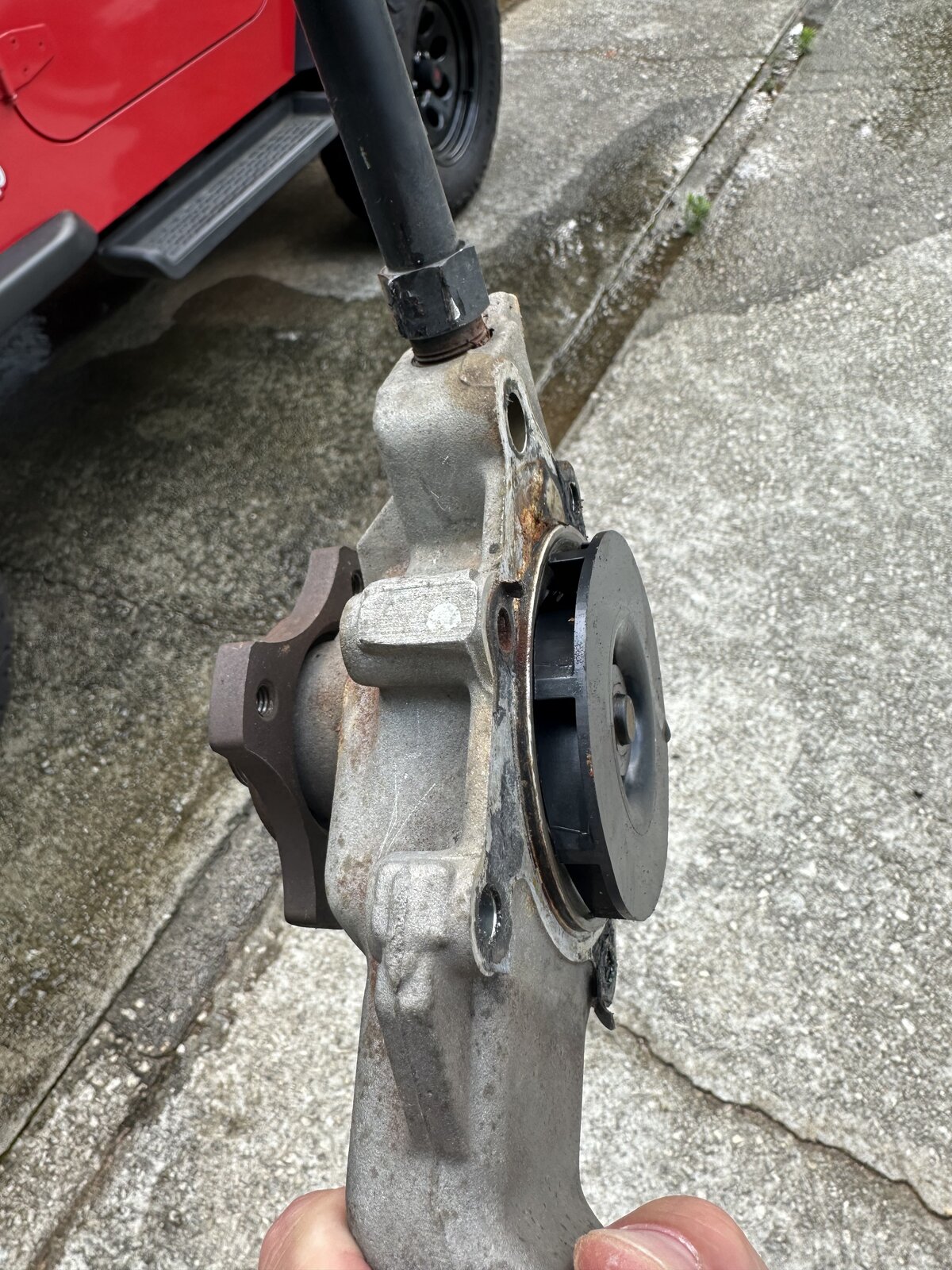

  • Have all the parts to swap in my new Mopar Water pump, at which point everything in the coolant system will be new except the Rad (which looks clean and is still leak free)

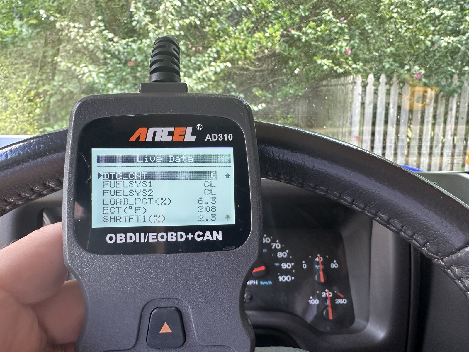

  • Need to find the motivation for the Water Pump swap, not loosing coolant but when sitting at idle for ~20min the temps will creep from 200-220 and as a result the AC output creeps from ~40s to high 50-low 60. Need to find a good way to sanity check the pump before I go and swap it.

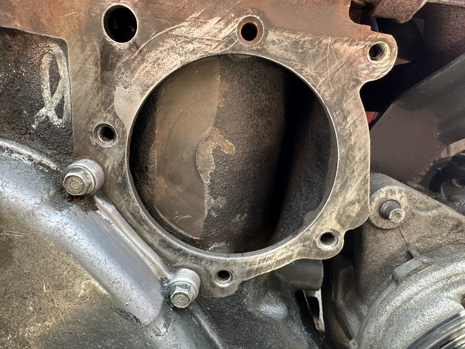

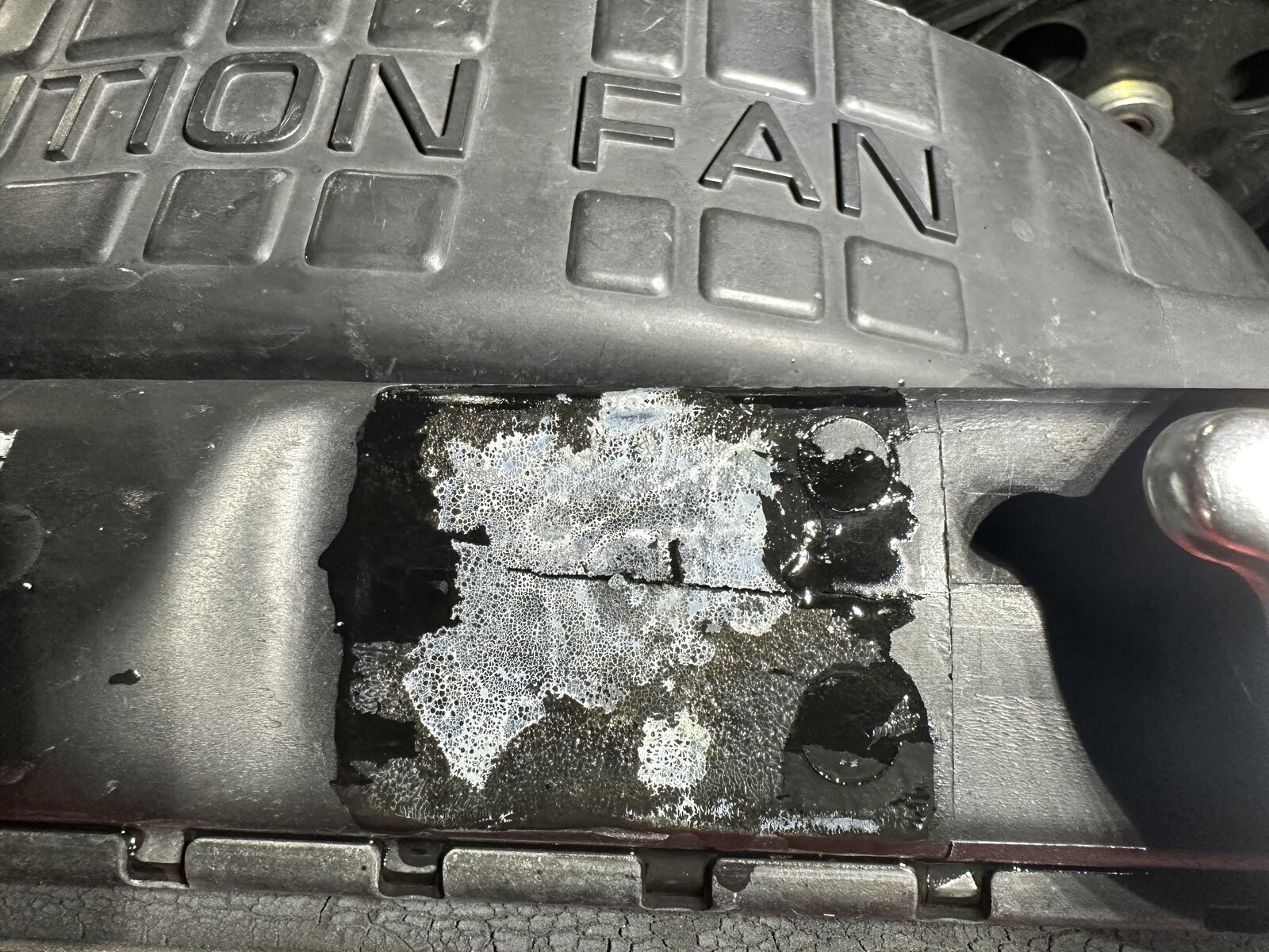

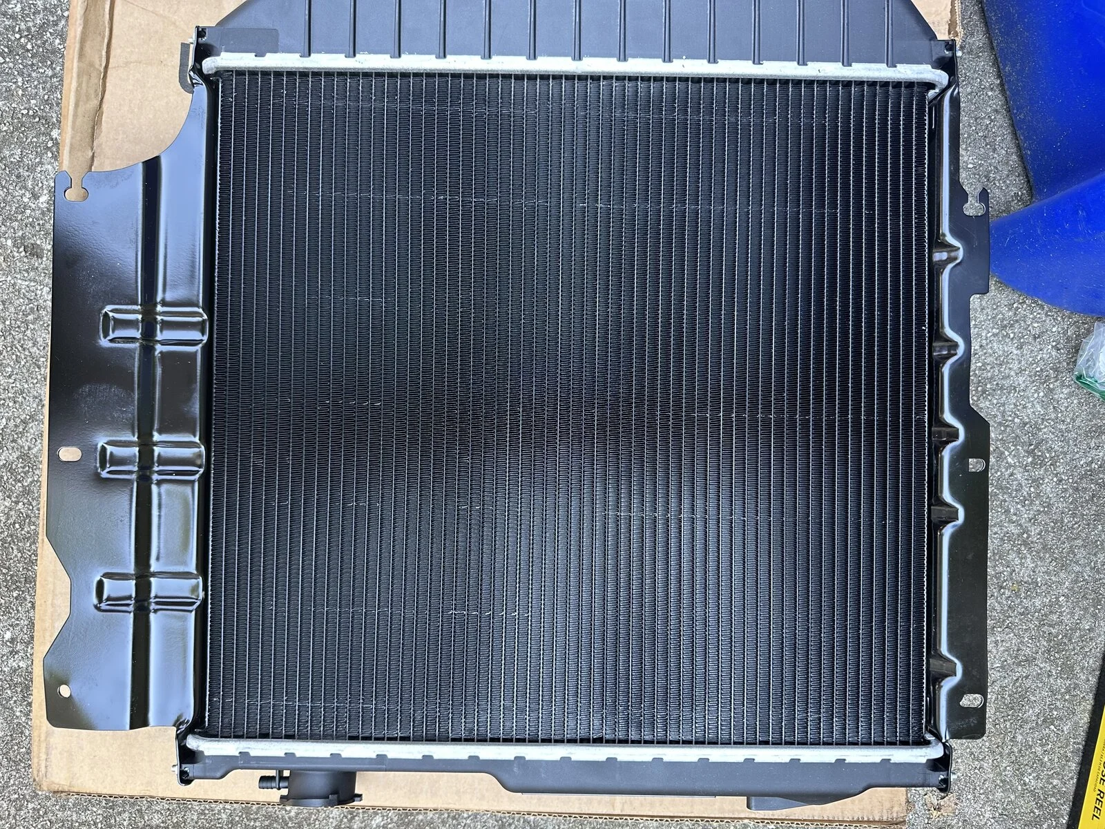

Cracked my radiator on a literal milk run to the grocery store. Of course it’s 2 weeks after redoing a coolant flush. WeRMopar.com Are the only ones who could source Mopar.
decided to also do the water pump since I had extra room with the radiator removed but in retrospect, doesn’t look like I needed to.
Hope this is clean enough (inside) will take another pass or 2 on cleaning the block before installing
Radiator arrives Tuesday, hoping I can have everything buttoned up before my nieces and nephews arrive on Wednesday for an end of summer get together.
Got the water pump installed and the belt back on, treated myself to a cordless ratchet, now all I need is FedEx to be in time tomorrow, water pump not to leak and temps to drop by 40 degrees
Got 45min of mixed road/HW driving yesterday with the AC on blast, temps 85+. OBDII showed 198-205 during stop/go and when I left it idling for ~10min I saw 215.
Water pump and hoses look dry, and non scientifically AC felt colder.
