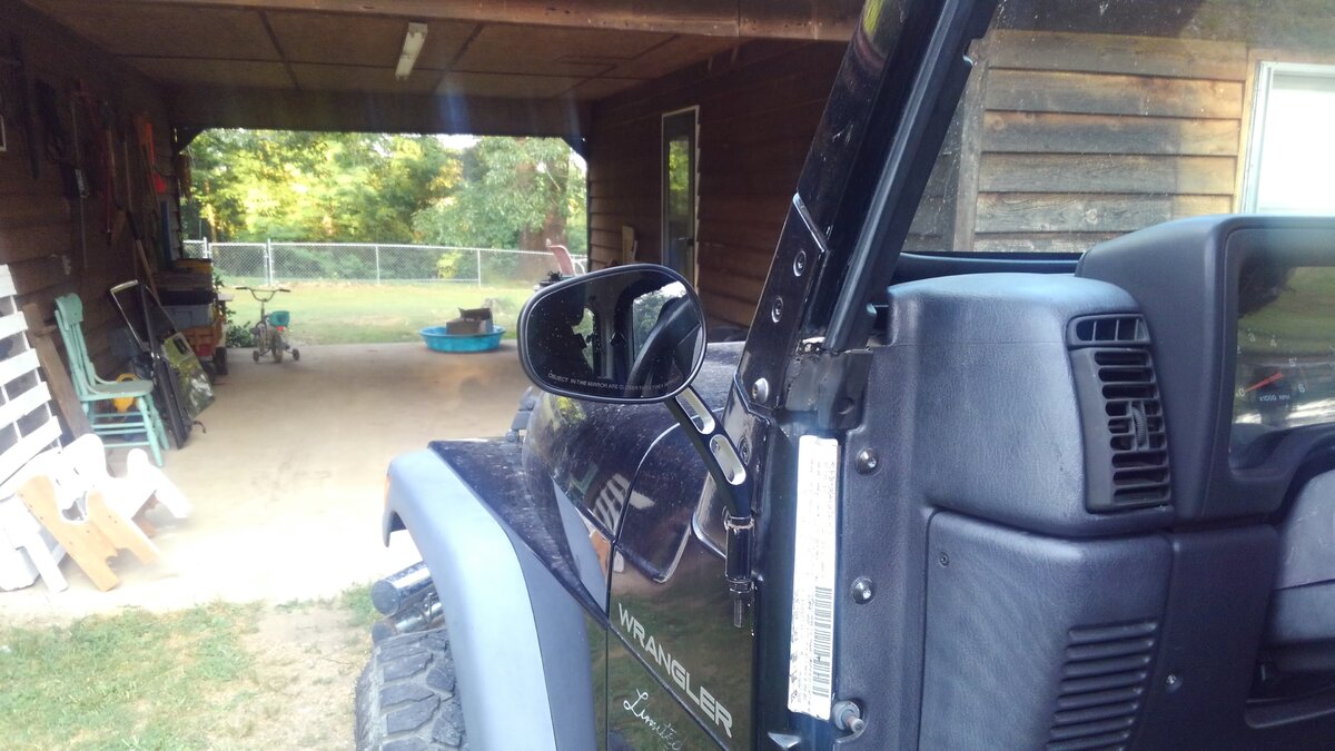

I run these Haley mirrors when door-less and they like a champ, a little hard to see in the second picture

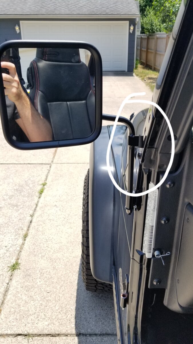

I bought these mirrors from quadratec when I had my JK years ago. They work on my LJ but at highway speeds they like to fold in, never seems like I can get them tight enough or something. Anyways, I had a coworker weld a tab on them and I glued some rubber on the edge. That stops them from folding in and it helped with how shaky the mirror is. Someday I'll get a better setup, but for now this is working fine
(Edit: Sorry, don't know why a picture of my frozen AC unit was there🤦‍♂️)
