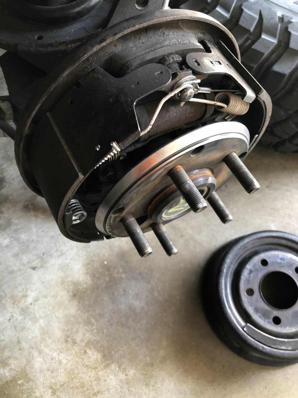

the only thing is , what if the axle flange is just bairly up on that little flange inside the rotor and pressure from the lugnuts press one side down and then there ya go with another wheel wobble. After putting the tire and everything back on and running the jeep up on jack stands there was a ever so slight movement in the tire. but on the highway it rode so smoth .You posted a video showing a brand new rotor spinning true. That tells you the axle flange is seated properly to the rotor. Not sure why any further measurements would be needed?
i really hope the axle flange is seated properly. ill get back to it again tomorrow
