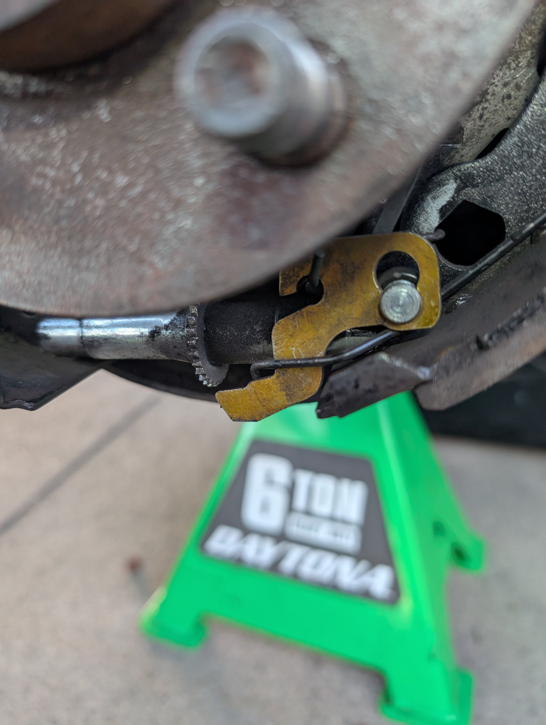

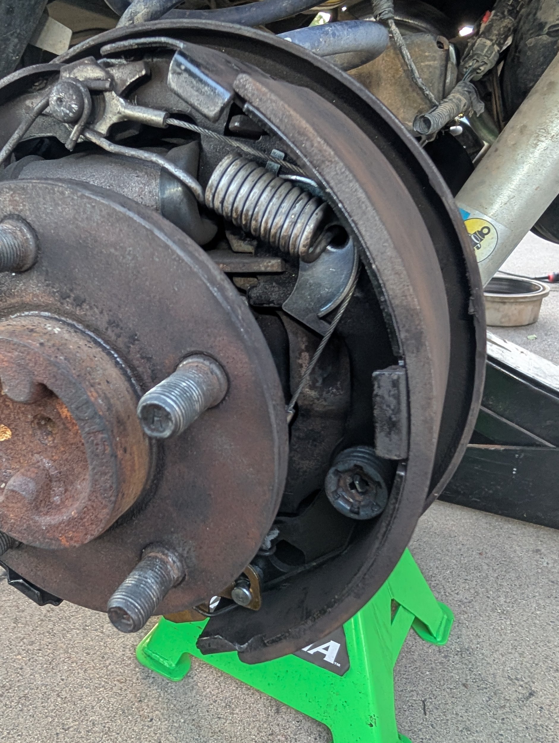

I've recently noticed a dragging sound that sounds like it is coming from my driver side rear brakes. I can hear it when I'm coasting at lower speeds where tire and engine noise didn't drown it out. When I hit the brakes the noise goes away.
Today I pulled the drum off and the only thing that looked off to me is that the parking brake pawl isn't in contact with the adjuster wheel. Not sure that this would cause the noise I'm hearing. Is there a way to adjust this properly?

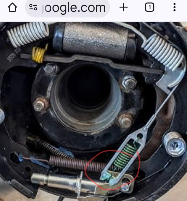

Maybe you have that pawl spring bracket on backwards? Hard to see. Here is a proper picture of the orientation of that part circled in red.

It appears that the contraption holding the spring is not oriented in front of the pawl like in your picture. I'll need to correct that in addition to removing the slack in the cable.
It's possible the lip on the rear of the cable guide isn't seated properly in the hole in the shoe. That can cause slack in the cable. The guide should be seated completely flat against the shoe if it's fitted correctly.

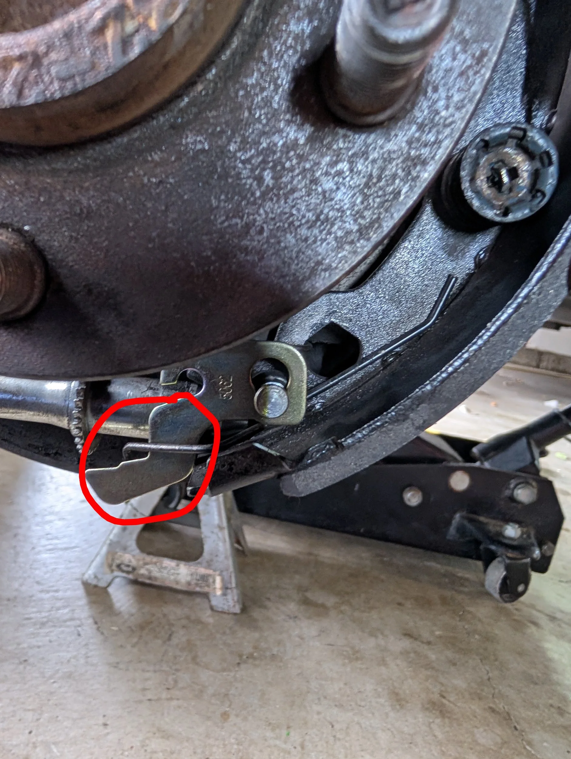

Ok, so ended up doing exactly what you recommended and I installed the guide and the retaining spring first, rather than trying to install the cable, the cable guide and the retaining spring all together. Once I did that the guide remained firmly in place. Buuutttt, my problem remained that the bracket was still not making contact with the star wheel. After several trips back and forth to compare driver vs passenger side I noticed that this tension spring on the bracket wasn't sitting the same.
I pulled it off and compared it to a new one and I either tweaked it when I originally installed it or it was crap out of the box because the springs didn't sit quite the same next to one another.
Installed the new retainer spring and everything looks as it should now. 👍
