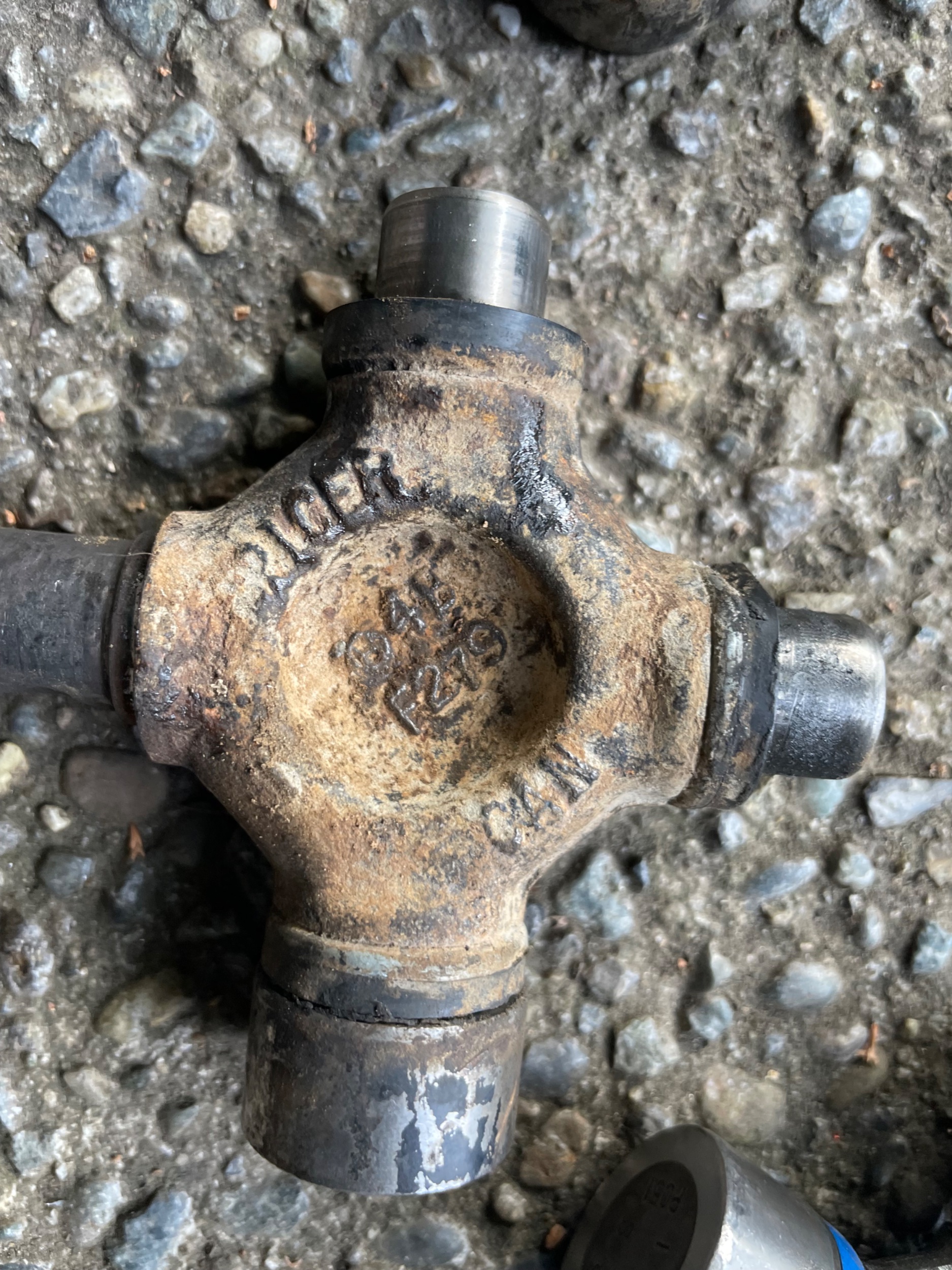

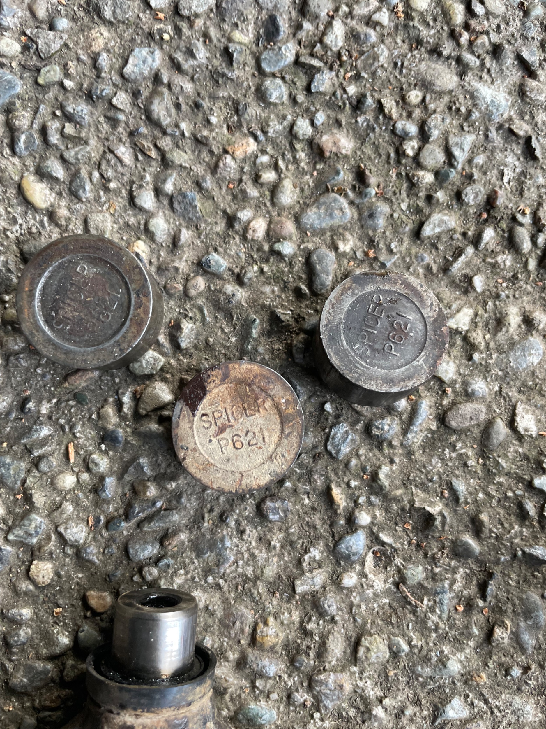

Best bet is to mic the cap diameter and then the cross section and call your favorite D/L supplier. A good Napa typically carries Dana/Spicer U joints and may be able to match/measure it for you as well. Id say away from Precision stuff.
