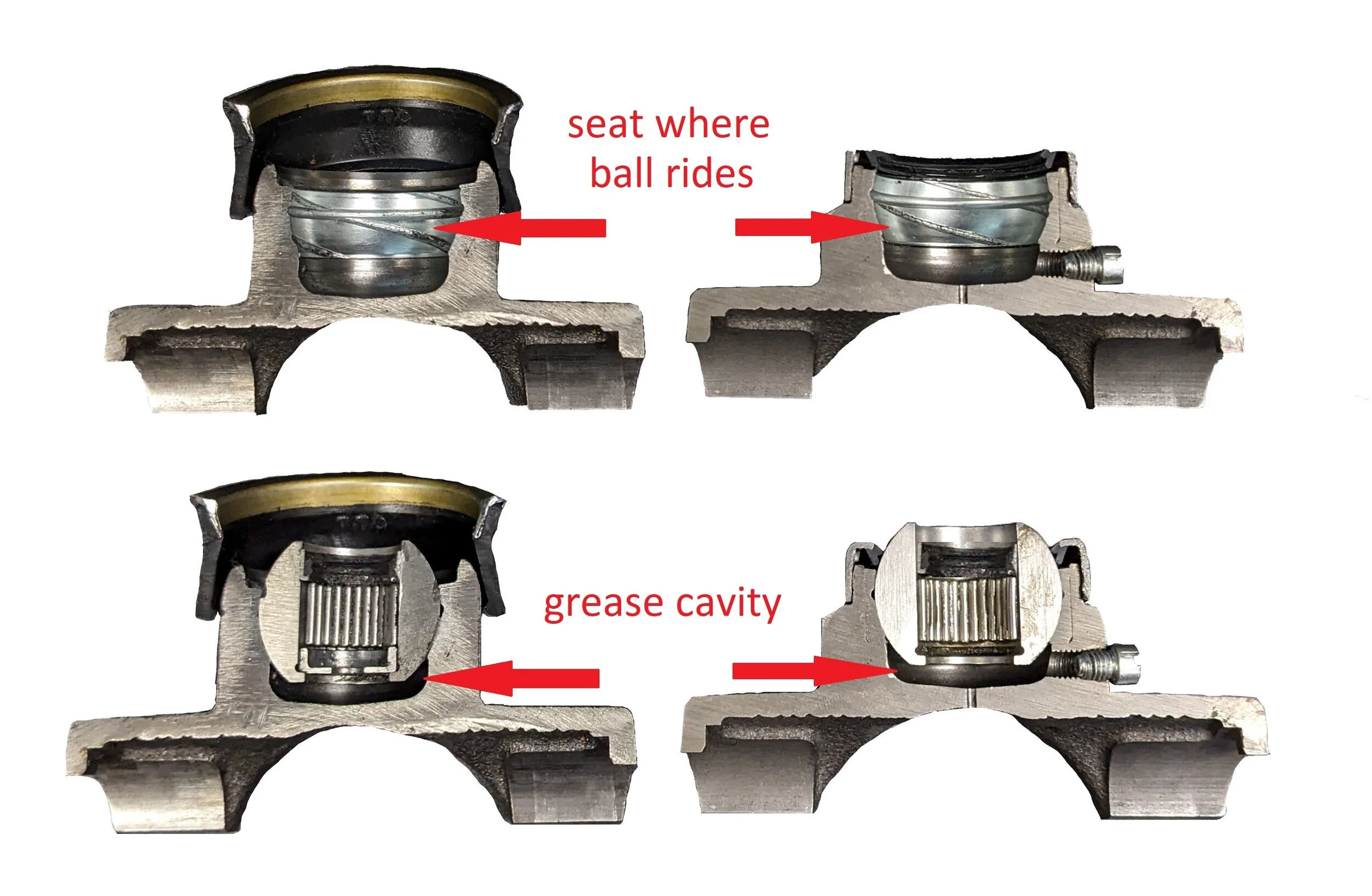

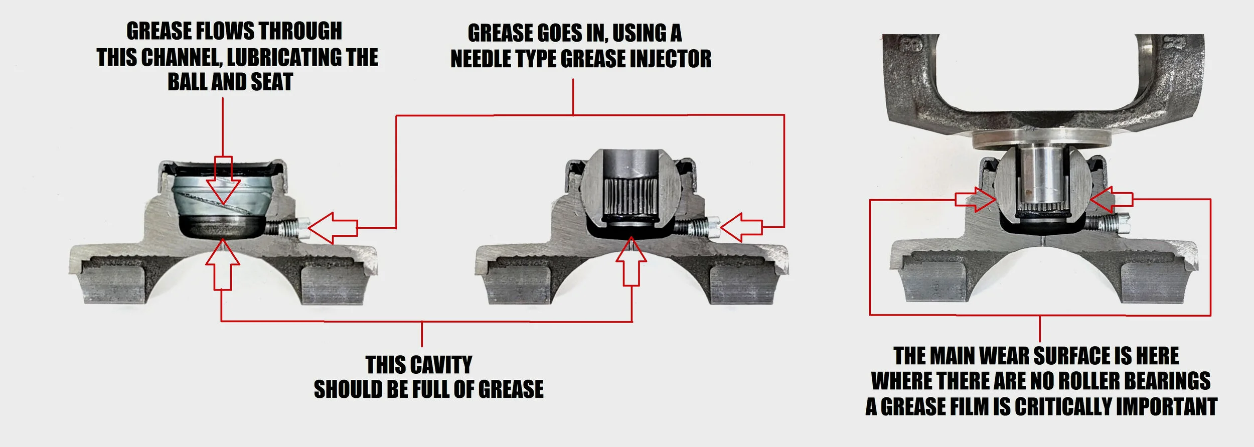

The centering ball on 3 Tom Wood’s DS on Jeeps are Greaseable. You have to use a different grease needle
We always use the greaseable 211355X. This is because in my opinion, when talking about the centering ball specifically, non-greaseable doesn't mean it doesn't need to be greased, it just means that you cant. Take a look at the photos below to see how the centering ball gets lubricated and you'll see that there is just a small cavity of grease under the ball. This can and will burn up or leak out eventually. Also, the rubber boot on the centering pin side of things that serves as a dust shield for the non-greaseable socket yoke can limit the flexibility of the joint. Or at least the rubber boot can get pinched and destroyed. In most stock applications this isn't really a problem, but in a lifted TJ, where the rear shaft is short and the angles can become extreme, flexibility is a concern.
