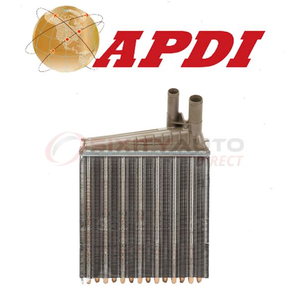

Has anybody found these in an APDI brand heater core? Their stock photos look a little different than most, in that the tank matches the OEM color and the tubes actually look copper.
Would like to bump this back to the top for others to chime in on. A new heater core may be in my future, and the Performance place has been possibly been sourced out lately.
I bought one of those, as well as two others, all had the plastic turbulators. OSC appeared to have the same ones, but in a smaller tube, which may make it harder for them to escape and end up in the block, but I have not used one.
