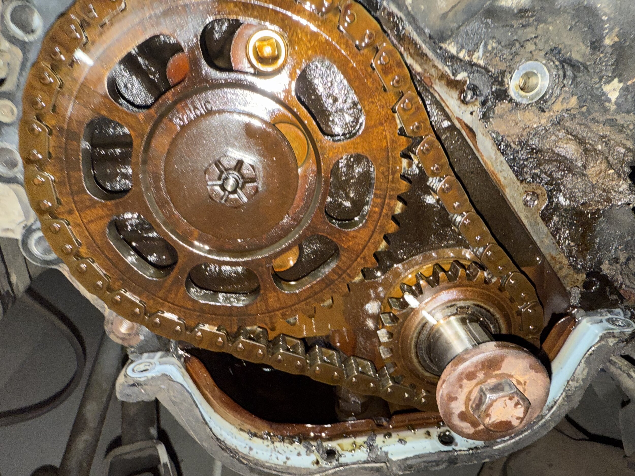

R Rcardenas New Member Original poster Joined Oct 5, 2024 Messages 14 Location Salinas Oct 10, 2024 #21 Any ideas kinda lost at this point
macleanflood I break sh!t Supporting Member Ride of the Month Winner Joined Jul 24, 2021 Messages 9,659 Location Fall Creek, OR Oct 10, 2024 #22 Set it where you think it should be with the dots lined up. It's not an interference engine...so you've got nothing to lose but a little "time." Pun intended. -Mac
Rickyd Nevermind! Supporting Member Joined Jan 2, 2020 Messages 7,464 Location North coast,CA Oct 10, 2024 #23 Rcardenas said: So I turned crank over 360 put chain back on turn it over and at tdc number 1 marks don’t lineup they only line up at 6tdc Click to expand... You weren't supposed to take the chain off. Reactions: GregBelleville
R Rcardenas New Member Original poster Joined Oct 5, 2024 Messages 14 Location Salinas Oct 10, 2024 #24 Any ideas kinda lost at this p Rickyd said: You weren't supposed to take the chain off. Click to expand... yes but does anyone know why when the marks line up it’s in exhaust stroke and not compression is that. Normal for this engine
