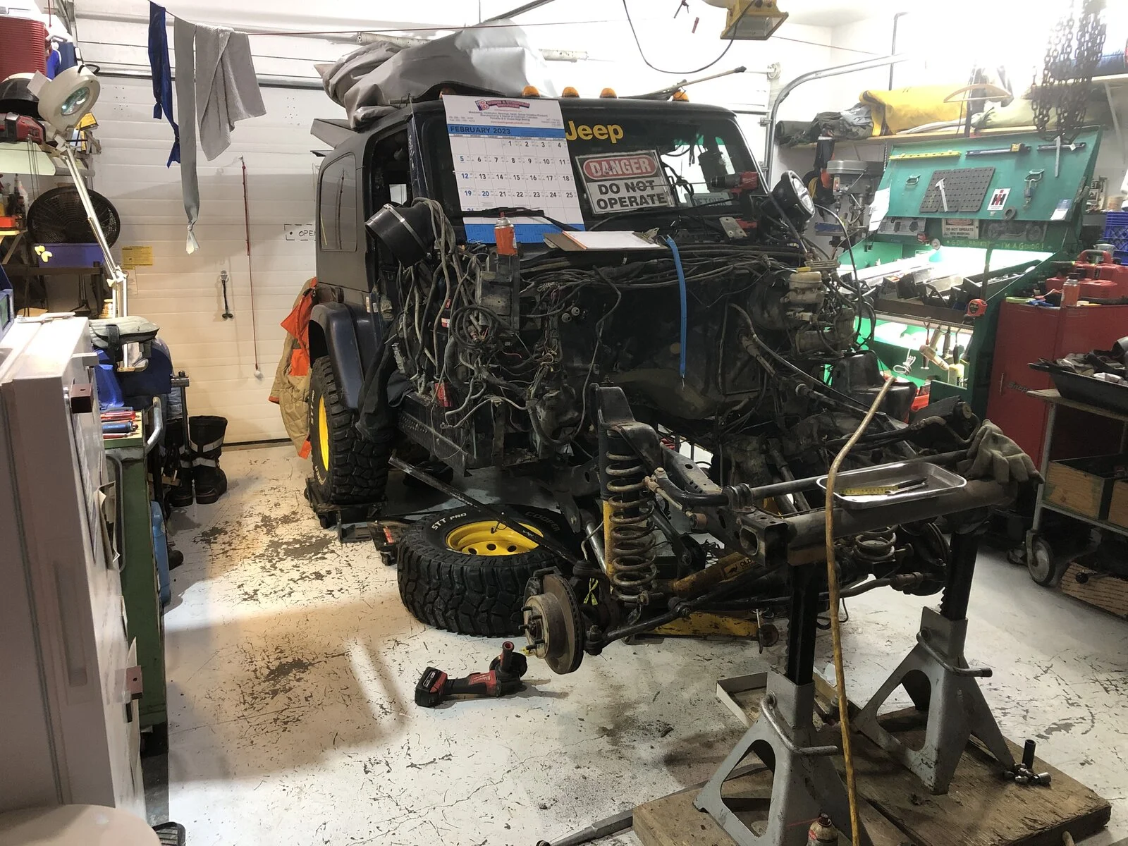

I’m finally healed up after almost 3 years absence from work

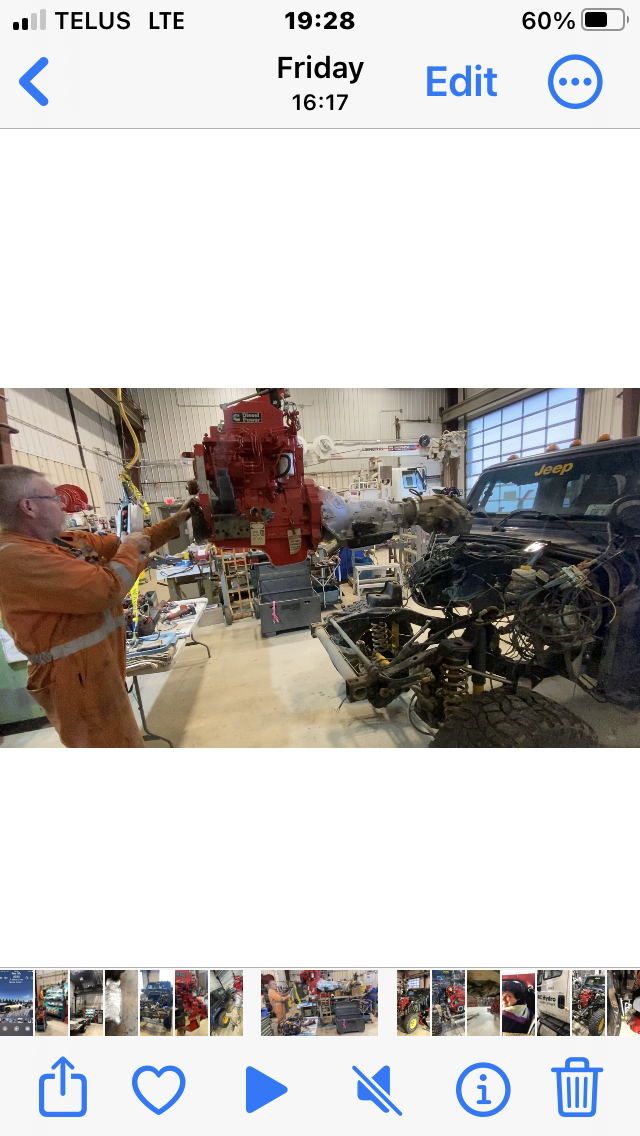

•As mentioned initially, I’m swapping in the 4BT, but it is also powering a built automatic 4L60E ( shifting simply with toggle switches , no arguing please 🙈😉😊😅 ) , instead of a stick tranny.
• at the time when I ordered the built tranny (2019), I was unable to push in the clutch pedal with my damaged hip joint and due to the unforeseeable surgery date we decided to stay with the automatic
• I’m continuing with my current setup of Cooper STT’s 33-12.5-15
on 3.73 gearing for now
• stronger Dana 44 front and regearing to accommodate 35” tires, is pure dream land at this point , my health issues since 2019 cancelled my initial plans and the wallet vacuum recovery after 2 private surgeries on top of a new driver-side hip joint hasn’t happened yet 😊
• back to the beginning last

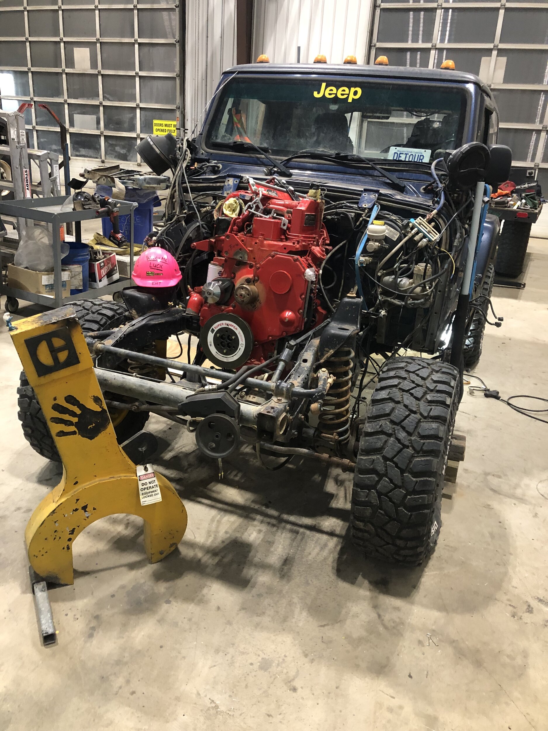

Tuesday :

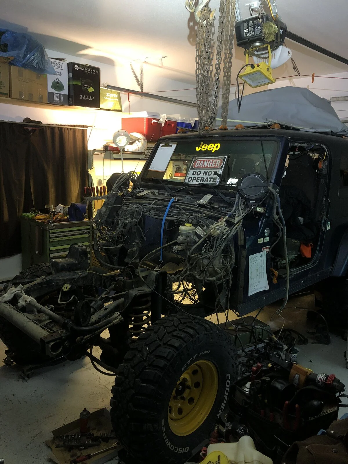

•Removed front sheet metal + bumper and eliminated / marked existing wiring for replacement
• miracles still do happen, I DID NOT break or twisted off a single bolt while removing fenders and grill !!!
•We’re certainly are not x posed to the salt belt, our LJ is 2005 👍🏿💯%
•installed 1-3/4” booster blocks on front coil springs to compensate for the additional 160 kg the “li’ll Cummins shaker “ puts on the scale
• (3.5” rubicon express lift kit was installed by PO)
•Next update sometime next week after shoehorning engine/tranny/TC between frame rails, including custom fab/modify engine and trannymounts

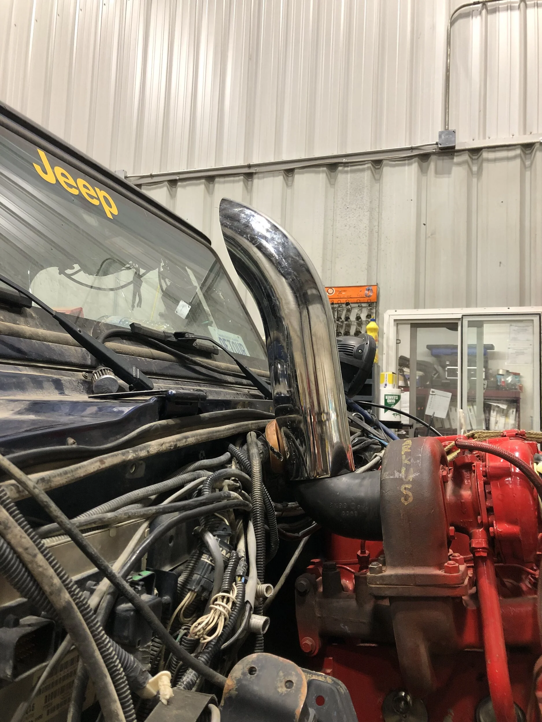

Howdy All
True to our licence plate “DETOUR”, we’re taking our sweet time with project “SPARKPLUG-Delete” , but we gained some ground in the last couple of days 👍🏿
Finally, spark plugs got deleted and DETOUR is rolling coal 😊

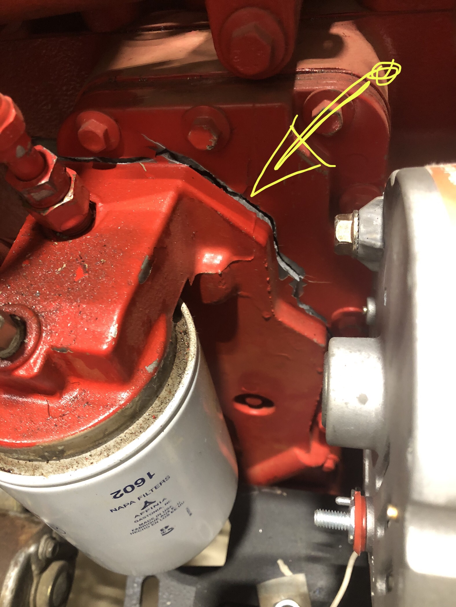

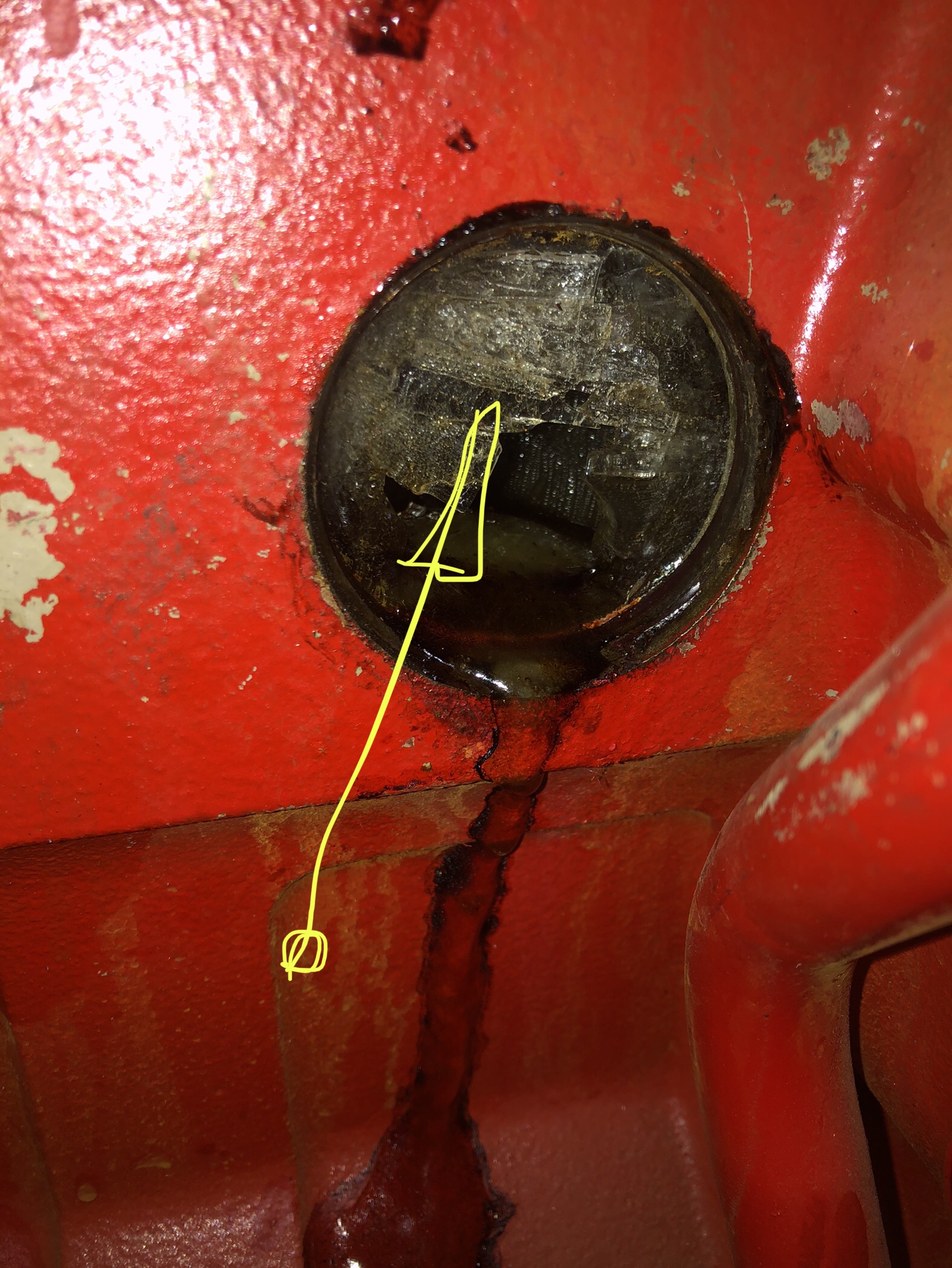

tap water expands 9% in frozen form and generates tremendous force, as it transitions from liquid to solid state,
talk about humbling, gut wrenching feeling when you suddenly realize that you didn’t drain the water after the maiden test run of the CUMMINS “paint shaker” and the ambient temperature is at minus 15 Celsius for the last couple of days 🙈😤😨

Howdy All again

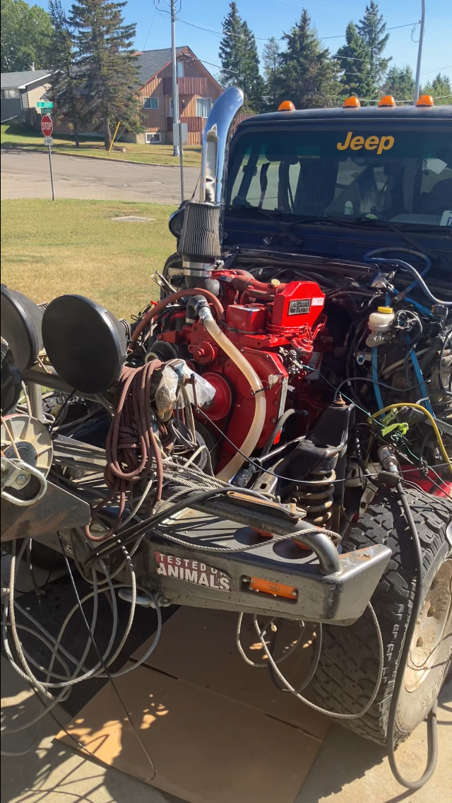

After our freeze-up ordeal this past winter and ongoing health battle during the summer ,
Our project
“SPARK PLUG DELETE “
got serious smoke in its chimney thanks to our sons interaction with installing a new head gasket, new headbolts and setting the valve lash

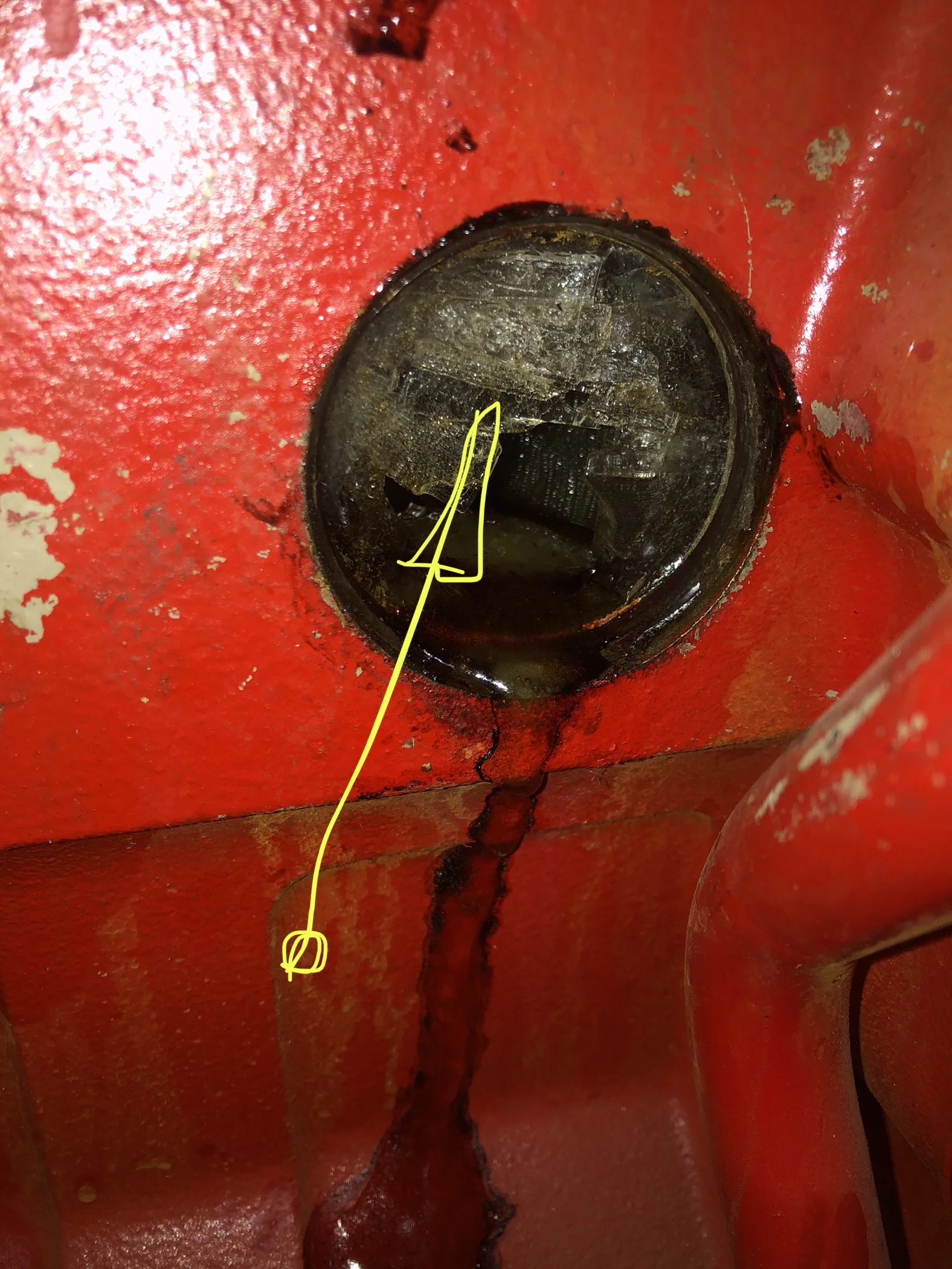

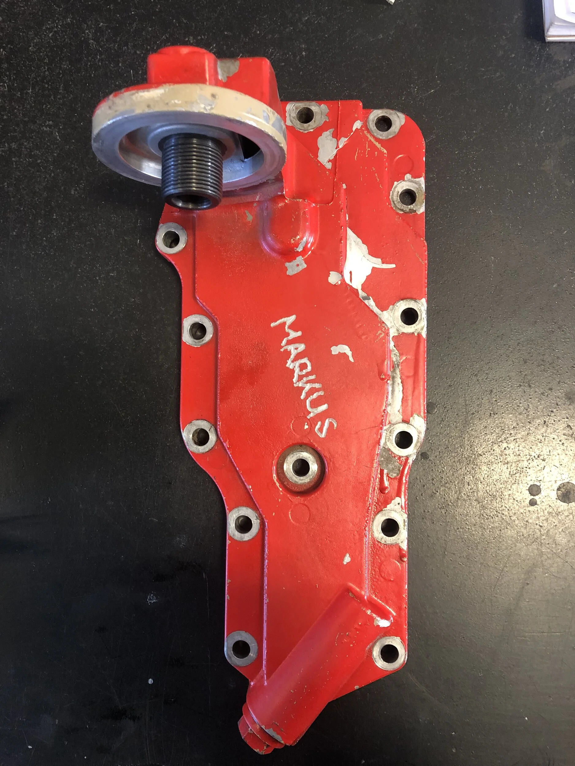

• one minor oil leak showed up on the 30 minute test run at different rpm’s parked in our driveway
•(easy fix, oil filler tube gasket R+R)
• there’s a few more hours of assembly and improvement time ahead of us , but …now we’ve got the long awaited second wind in our sails 😊

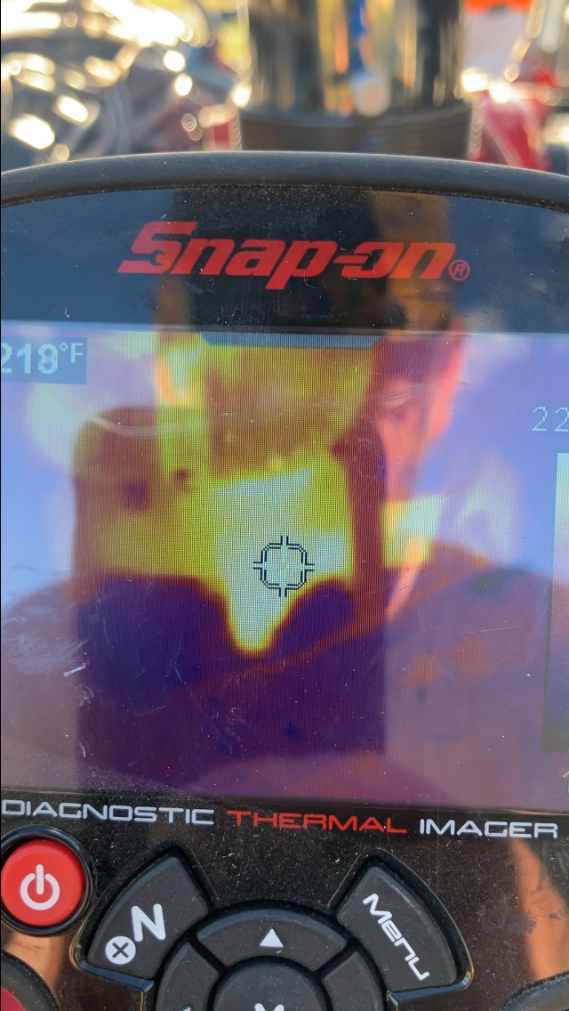

• I borrowed our thermal imaging tool from work for checking EGT
• 56 psi oil pressure at low idle (850 rpm) is more than sufficient
Keep y’all posted as we’re progressing at snails pace 🙈🤣

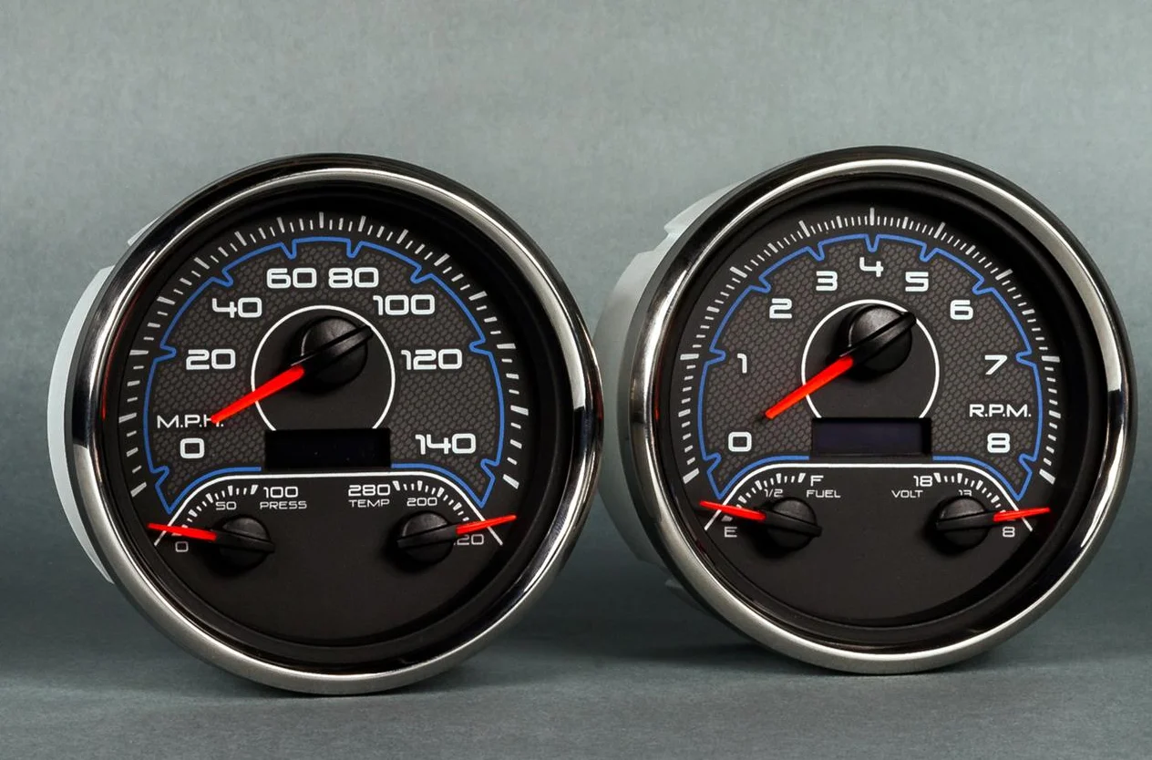

•Anyone out there has experience with AUTOMETER dash gauges or other reliable BRANDS that you can recommend ?
• I don’t wanna reinvent the wheel 😊
• I’m working on a custom dash cluster to provide space for
1)Tach (pulse signal of from alternator)
2)GPS-Speedo
3) coolant temp.,
4) fuel level,
5) oil pressure (mechanical) 6) voltmeter
Separately mounted :
6) pyrometer
7) boost gauge
