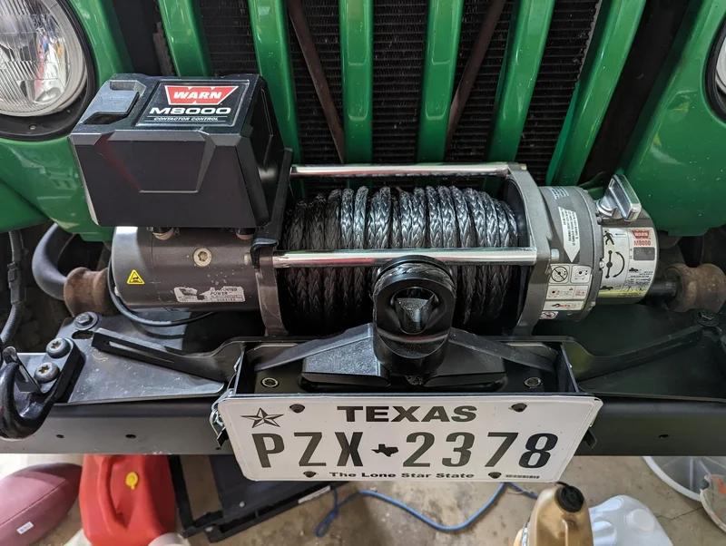

Mounted the control box. Still might move it under the hood down the line. Just need a rope.

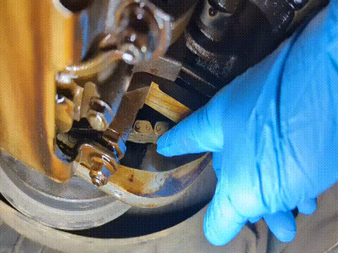

My johnny joints are creaking again. I serviced the lowers almost exactly a year ago, but only about 3k miles. It's supposed to cool down a bit next week. I'll probably tackle it then.

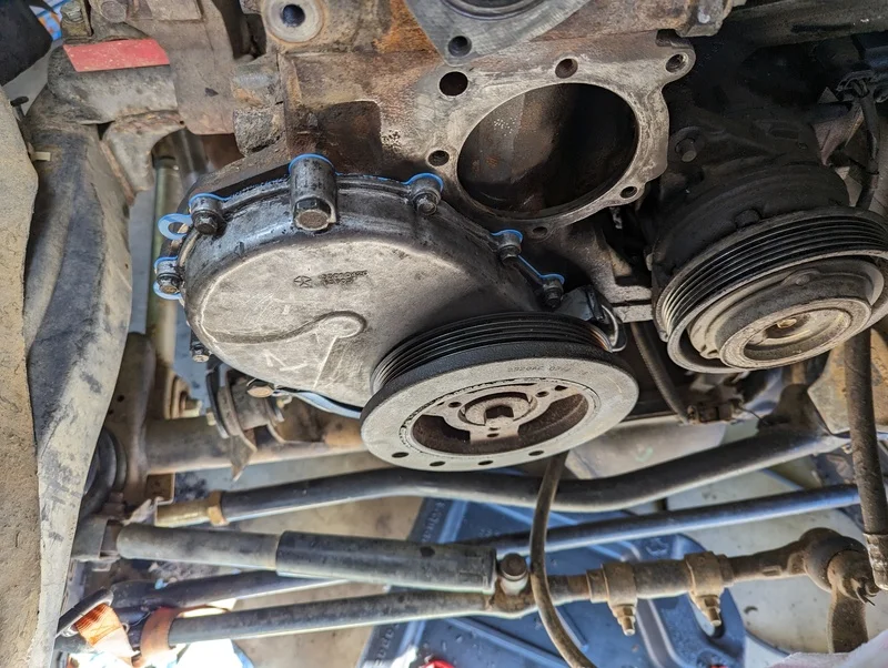

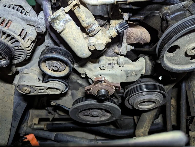

Tackled this over the past several days. I was able to get the rear lower johnny joints serviced on Thursday and started draining and removing parts the following evening once I had tracking numbers and knew when I could expect deliveries.

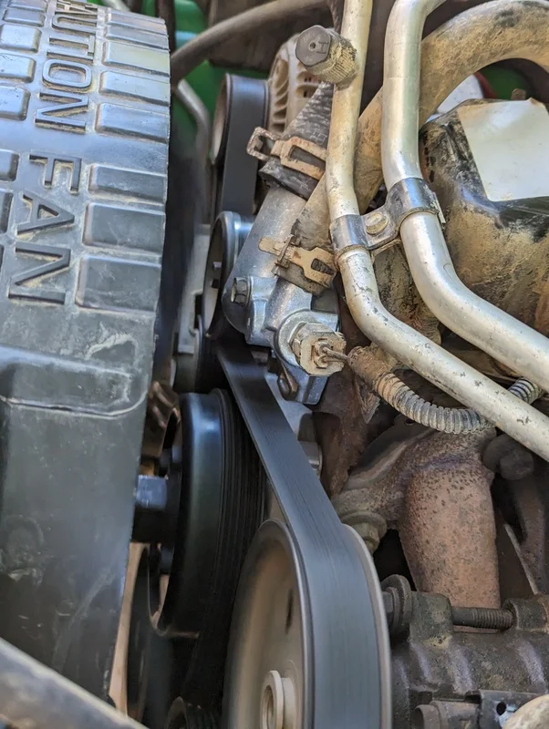

With the rad, fan and belt removed, this is where we started. Its obvious that this is not the factory water pump. The lack of Mopar logo, the purple heater pipe and the worm clamp give it away. All of the other components appear to be factory including the thermostat.

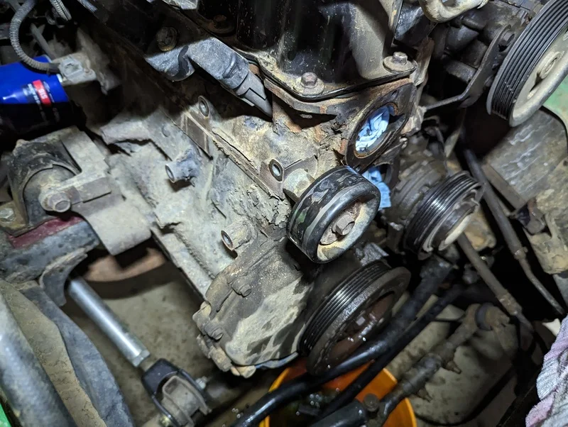

Pump, water neck and generator bracket removed. The idler pulley looks iffy, but it spins true and its quiet.

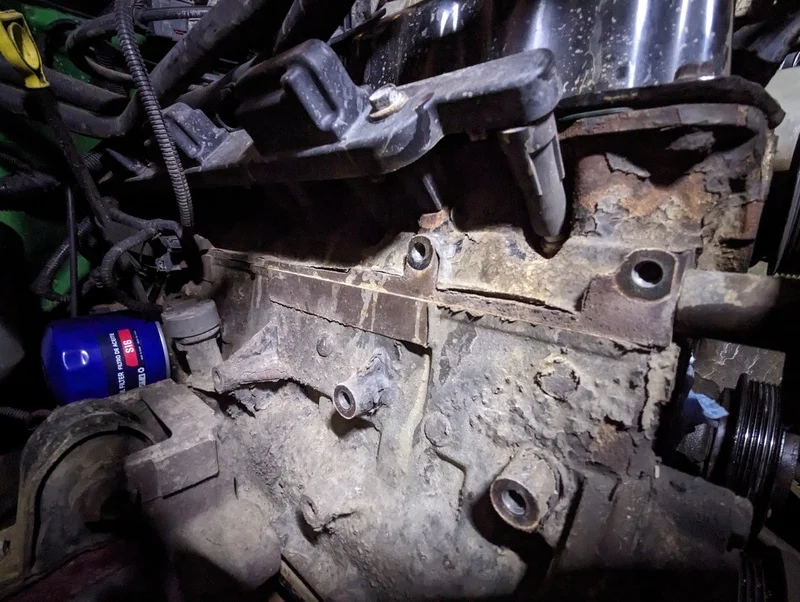

Hide your eyes @Irun , the block is dirty and... pealing? I'm not going to utter that word. It's dirty.
This is before I spent an hour scraping the old gaskets off. I followed @JMT's lead and carefully used one of these to get it completely clean.

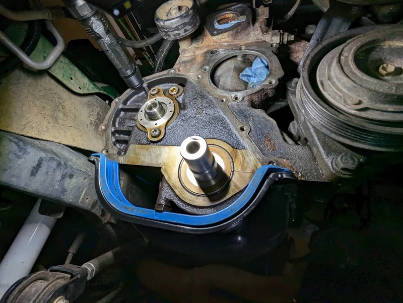

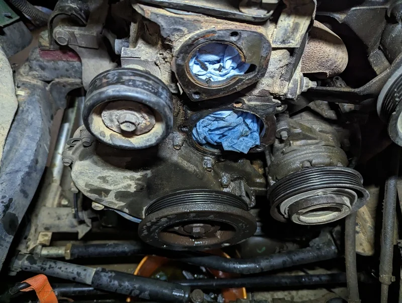

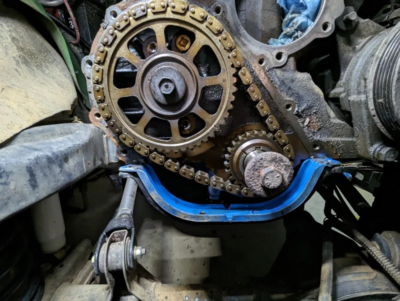

From here I pulled the harmonic balancer and the timing cover. I must have read through this thread at least a dozen times getting ready for the timing chain swap.
OG chain and sprockets
Removed and gasket scraped. You can see the cleaned pump and thermostat surfaces here too.

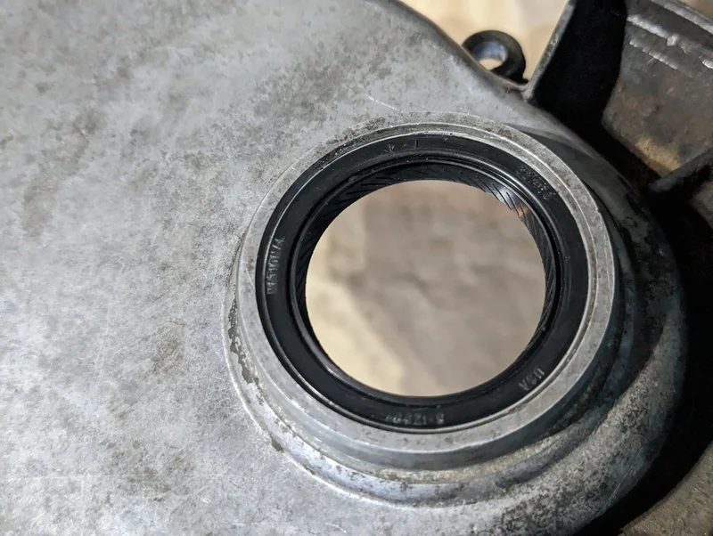

I used all Mopar timing parts (chain and sprockets). It turns out I ordered three different crank seals. I ended up installing the one that came with the FelPro TCS45458 timing gasket kit. It is a National branded seal, was marked "USA" and most closely resembled the original that was removed (except the color).
I, sadly, did not get a picture of new new chain and sprockets installed...
Getting the cover back on was kind of a trick. The FelPro oil pan gasket (maybe they are all like this) has very tall shoulders around the timing cover. I pulled it away from the pan, set the cover in its channel and then slid it back over the chain. At this point, it was sitting tall and the bolts would not easily thread on. I started with the four bolts through the oil pan to "pull" it down in to place. It worked and I was able to loosely thread the cover bolts in place.
I did not track down the Timing Case Cover Alignment and Seal Installation Tool 6139 as specified by the FSM. Once the cover bolts were in place, I used the harmonic balancer itself to center the cover and seal (tools borrowed from O'Reilly). It worked as intended and only cost an extra ten or so minutes to pull it on and back off.
From there, I didn't take many pictures of the cooling component installs. I was ready to have the Jeep back. The pump was replaced with a Mopar unit. I ordered a Dorman heater pipe, but the damn thing simply would not thread into the threaded hole of the pump. It felt cross threaded, but it was not. I gave up and used ole reliable, purple pipe with a fresh wrap of teflon tape. The bolts for the pump were also wrapped in teflon tape per YouTube wisdom(?) and the gasket installed dry.
Rather than order a Mopar or Stant and receive a Motorad, I cut out the middle man and ordered a Motorad 2000-195 for $4. Yes, its a "performance" tier thermostat but at 195*, it has a check valve and did not need to have a hole drilled. It was $3.33 - a price I am happy with.
I ordered a "matching" motorad waterneck and gasket. The gasket was dipped in clean water and installed wet. The bolts did not get teflon tape and the existing temp sensor was reused.
The CSF radiator has not arrived yet, but as mentioned, my original Mopar unit was in good shape with no leaks and was cleaned, rinsed and reused with a new Mopar cap. New upper and lower Gates hoses were used. The upper gave me fitment issues and was a little too long but was made to work. No issues with the lower but I did notice it lacked the internal spring of the factory hose.

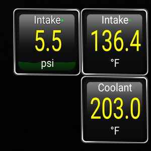

After a 15 minute idle and a spirited rev session in the driveway, nothing exploded and temps were more under control than I've ever seen. What's more, zero leaks of any kind.
Around town, I never saw temps higher than 208* and mostly hovered around 202*. Previously, on the highway, temps would rise to 230 and then creep up over 235-240. A 10 minute spin on the interstate 70-80mph and the max temp recorded was 210.8*. Great success.

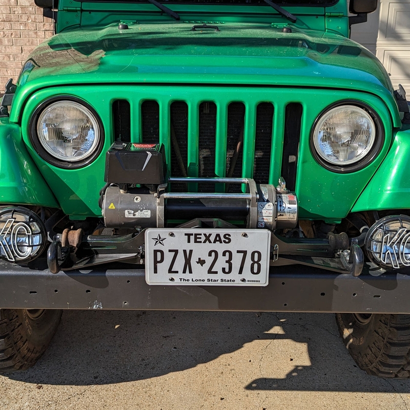

New O2 sensors installed without much fuss. The motor in general is running very smooth after the refresh.

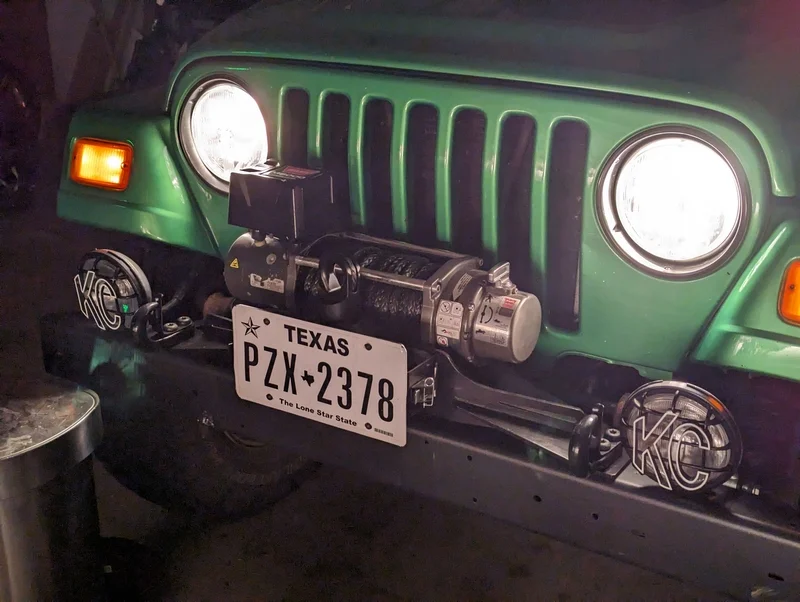

WRG rope installed but not tensioned. Alas, I've disappointed everyone with my color choice. Nice to have the winch project finished.

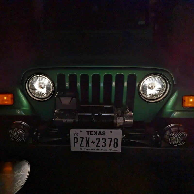

Hella H4 100/80w bulbs were ordered for the Kioto lenses. I've been running the 60/55w bulbs included with the Toyota kit. As a refresher, I'm running the wiring harness that came with the kit. Amazon decided to deliver one bulb yesterday and the other is coming, so I threw it in to see if there was a noticeable difference. Maybe you can tell.
The new bulb is on the right/drivers side. It is a bit brighter but I wouldn't notice it if I wasn't looking for it. It does have a cooler color temperature to it, just a bit less yellow, a bit more white.

Cooling system is still running well. Temps are still consistently low-ish, 199-210 mostly staying around 204-208. Not sure if that is a problem or not. I might consider trying a different thermostat in the future to get temps up closer to 212. I did find a puddle of coolant this morning after driving to the office. The lower hose is dripping at the radiator. I'll reseat the tension clamp and hose and see if that solves it. If the radiator has cracked somewhere, I've got the CSF replacement on hand.

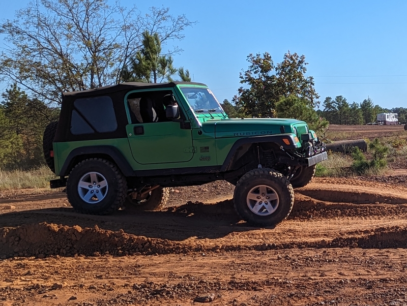

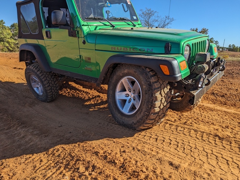

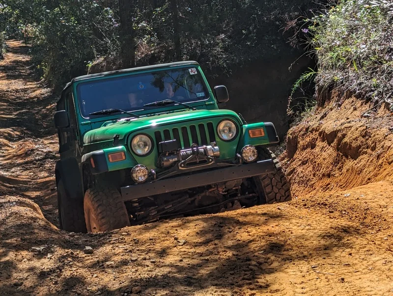

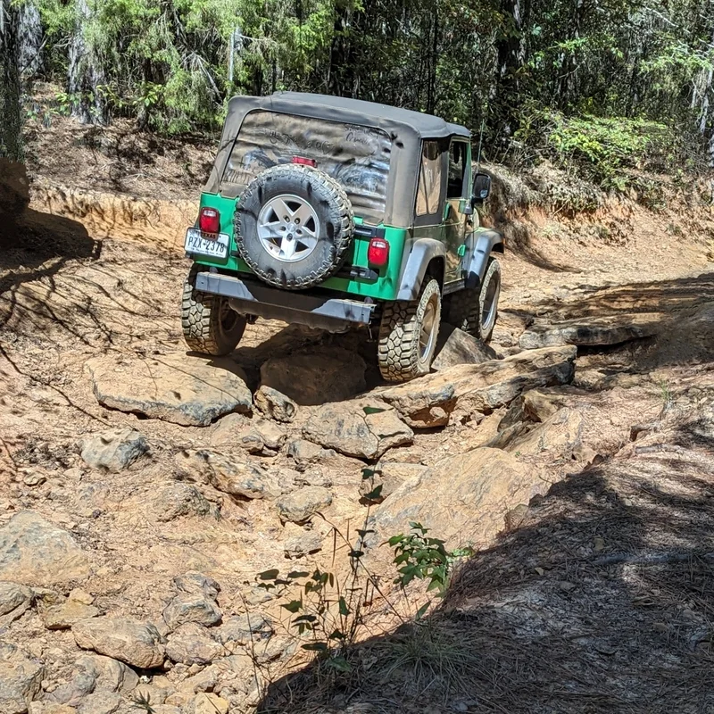

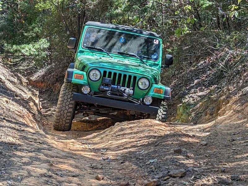

Had the jeep out at BMRA this past Saturday. Fairly decent turnout, not crowded though. BMRA is about a 3 hour drive from the house. With no soccer and no softball on a Saturday, I had my son and younger daughter with me for this trip. We got an early start and were at the gate at 8am. The park is a 1,850 acre "mountain" of red clay in east Texas, owned and maintained by TMTC. The main pavilion is at the top and trails run down and around. It is very dusty. After making the 200 yard drive from the gate to the pavilion, my daughter couldn't help herself:
Most of what I ran is ravines and washouts with some off camber stuff. There's harder stuff, sure, but this is what a lot of the property looks like. Ravines for days:
Ran in an easy group with @MattTJRubicon82 in the morning.
After lunch, Matt and his buddies let me and my little 33s tag along on a trail called Whatever. It's a ravine with a tricky section straddling a v. The ruts are deep and you can teeter a bit. Matt went first and tipped a bit nose up, I think. In the video, right at the start, I don't get far enough over passenger and nose down into the notch. Not deep enough to flop, but got the blood pumping a bit. A better line hugging the driver side wall coming out of it.
We split up and I spent the rest of the day running easy trails with my two kiddos. They really had a good time. It was nice having a photographer with me.
There was one decent climb. An XJ with open diffs was getting winched up when we got there. Fairly easy line for the Rubi. Daughter for scale.
The day ended with a run through the articulation chute. Used all available shock travel and bumps set correctly to prevent rubbing.
We stopped at Dairy Palace in Canton on the way home for a burger. It was a great day with my kids. Jeeps are pretty neat.
