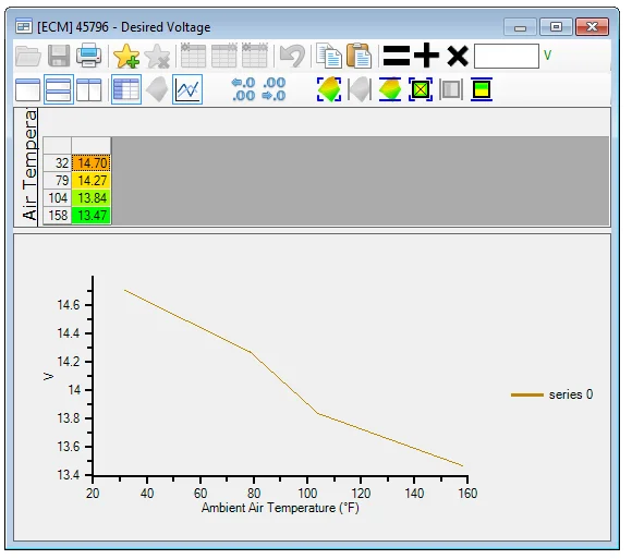

In Steel City 06's post that I referenced in Post 83 above, he posted this charging voltage vs. ambient temperature graph that is in HPTuners software:
He surmised that "Ambient Air Temperature" was actually the battery sensor temperature.

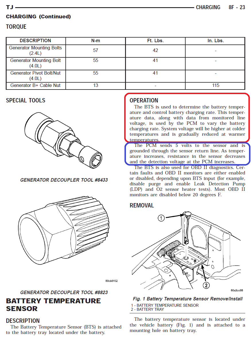

I like your thinking (!), but AGM batteries are also sensitive to temperature, so having some adjustment for battery temperature would still be desirable, I would think.
I just referred to the 2005 FSM. It seems to indicate that the PCM does vary the voltage based on battery temperature (see red bubble below), and it does look like a resistor could work (see blue bubble below) to trick the PCM:
Reactions: Mike_H

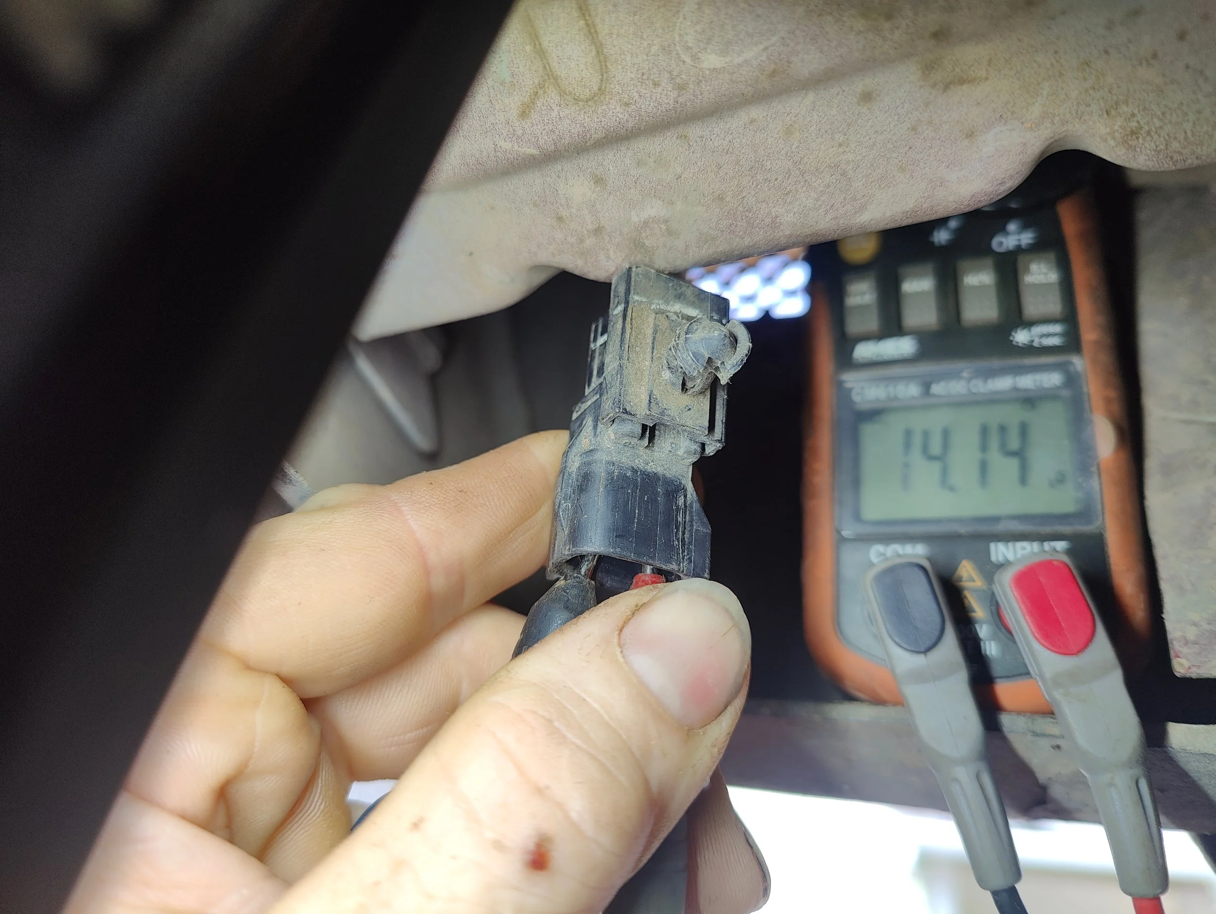

Battery at rest is 12.58.
Resistor is 14.14 k at 77 degrees.
Voltage running is 14.03v.
My original white 97 tub...I didn't move over the sensor...is 12.5 k. (No battery sitting on top of it )
I can source a potentiometer... anyone happen to know where I can source male and female connectors for the battery temp sensor?
