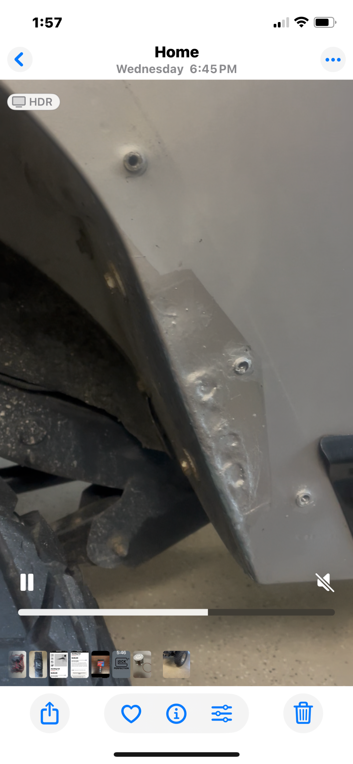

When I got the jeep during Covid late 2019,the first thing I did was remove the faded flares so I could pant them.I noticed some bad rust on the driver side from the abs tray that had came through to the outside.i removed the tray and treated everything back to front with the etching crap and then brush on the por15(just trying to contain the rust under the flare).and save the fenders a little longer,5years and it looks like it is still contained?
A body guy friend said it all flaked off on him,but if you use the pre etching stuff and paint over the por15 it seems to stop it.

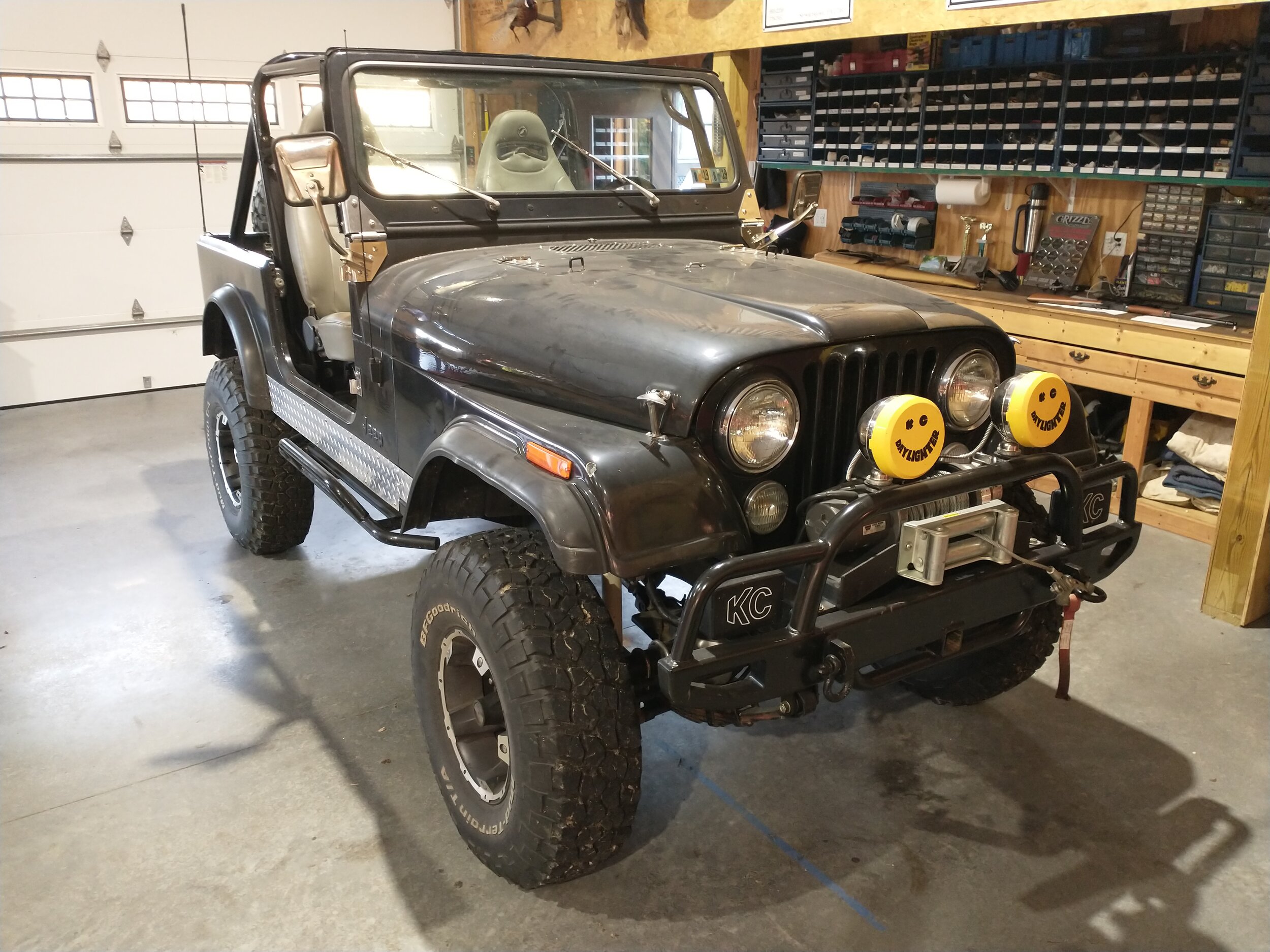

A friend of mine actually did his entire CJ body with it (bit dusty in this photo)...

While I can't say for sure what product he used on his CJ, they would appear to have a number of UV-resistant coatings.
If his jeep isn't being driven, it's sitting precisely where it is in that photo, getting dusty. Not so sure he was worried.
