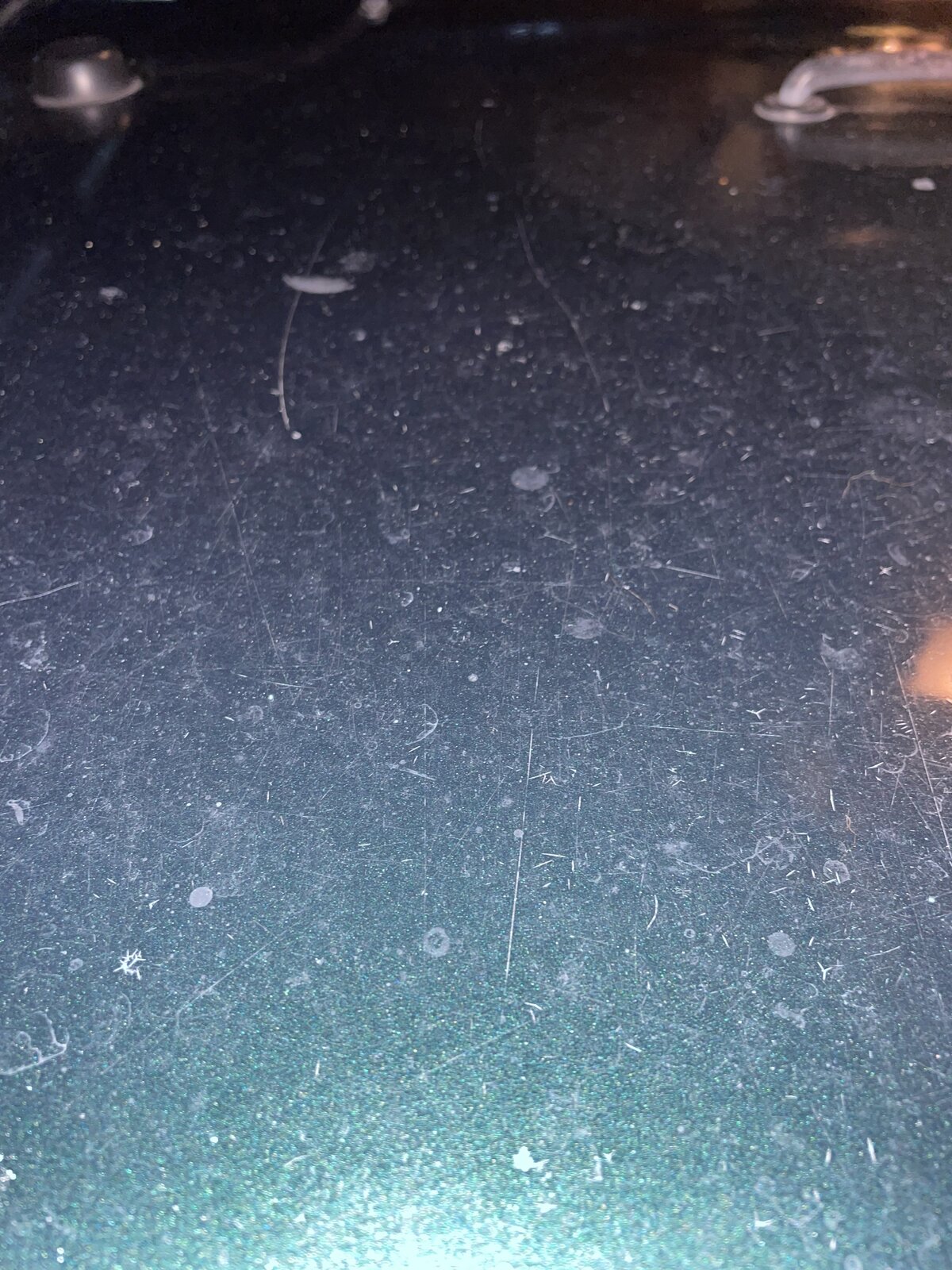

Hood Closeup:

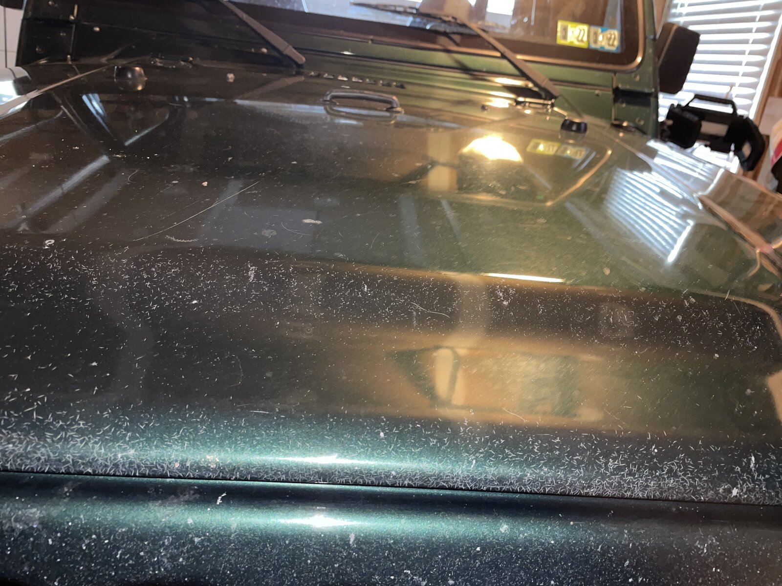

Hood from front:

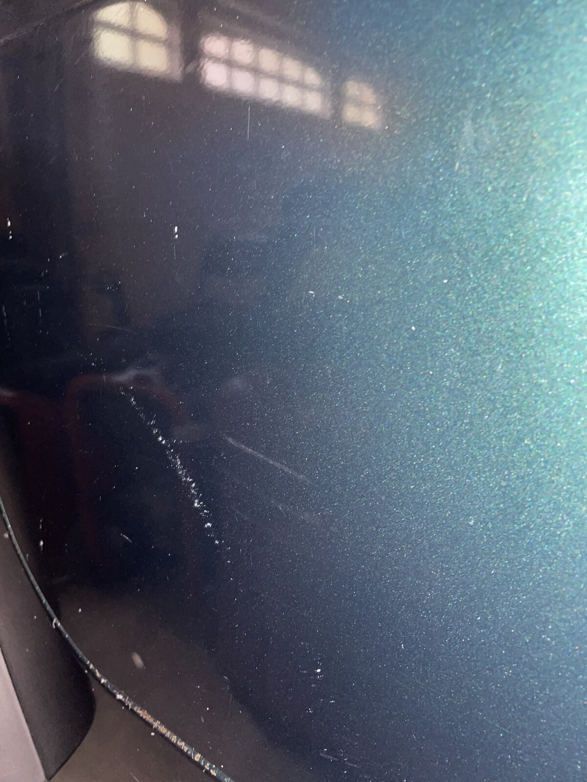

Door with large circle scrape, same on other door, I believe from how the PO stored them when off as the circle matches on both sides:
Interested in any feedback. I am not affraid of a project but also come into this with zero knowledge or history of how to do this. I have washed a car by hand before and that is the extent of my polishing and waxing experience.

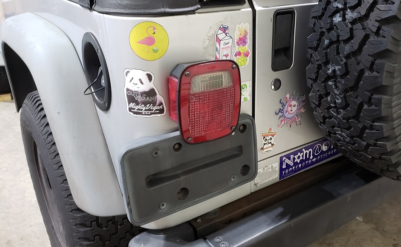

You can do this yourself, save money, and end up with good results. You won't get everything out, but you can significantly improve over what you have now. As a small sample, here's one area I had:

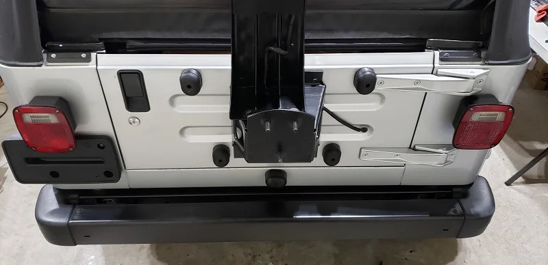

Which when fixed looked like this:
Your hood will be the hardest part, and, in some cases, may just need a re-paint. You won't know though until you try. You learn something in the process and can say I did it myself!
Incredible results! What did you use to get the stuck on dirt from where the flares and tire carrier were?
Forgot to also mention, get some Goo Gone. It works great to get hard to remove stuff off. I had a bunch of stickers to remove. The heat gun and Goo Gone worked wonders.

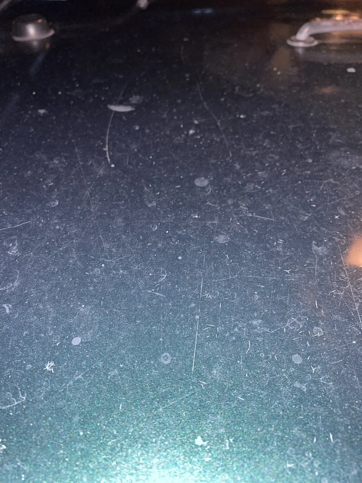

Hood Closeup:

Thanks! I really need a start to finish tutorial. I will check out the Mike Phillips videos you referenced. I just don't want to do more harm thatn good. Is the paint I have fixable?
